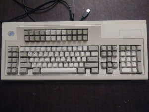

I'm working on mods to a 122key Modem M.  Here is what I've currently completed:

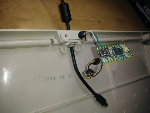

1) Installed a Teensy 2.0 running qmk firmware
   201204-0

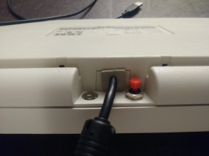

2) Hardwired a USB cable and added a programming button so I can reprogram the Teensy with a button press.
   201206-1

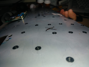

3) Performed a bolt-mod.  It's actually a screw mod, in that I put the screws in reverse without bolts.  I found that the bolt mod will sometimes cause the metal plate to no longer fit properly and the keyboard can end up with dead spots.
   201208-2
4) Converted the keys to an ANSI layout from ISO.
   201210-3
5) Programmed macros into the left function keys.
