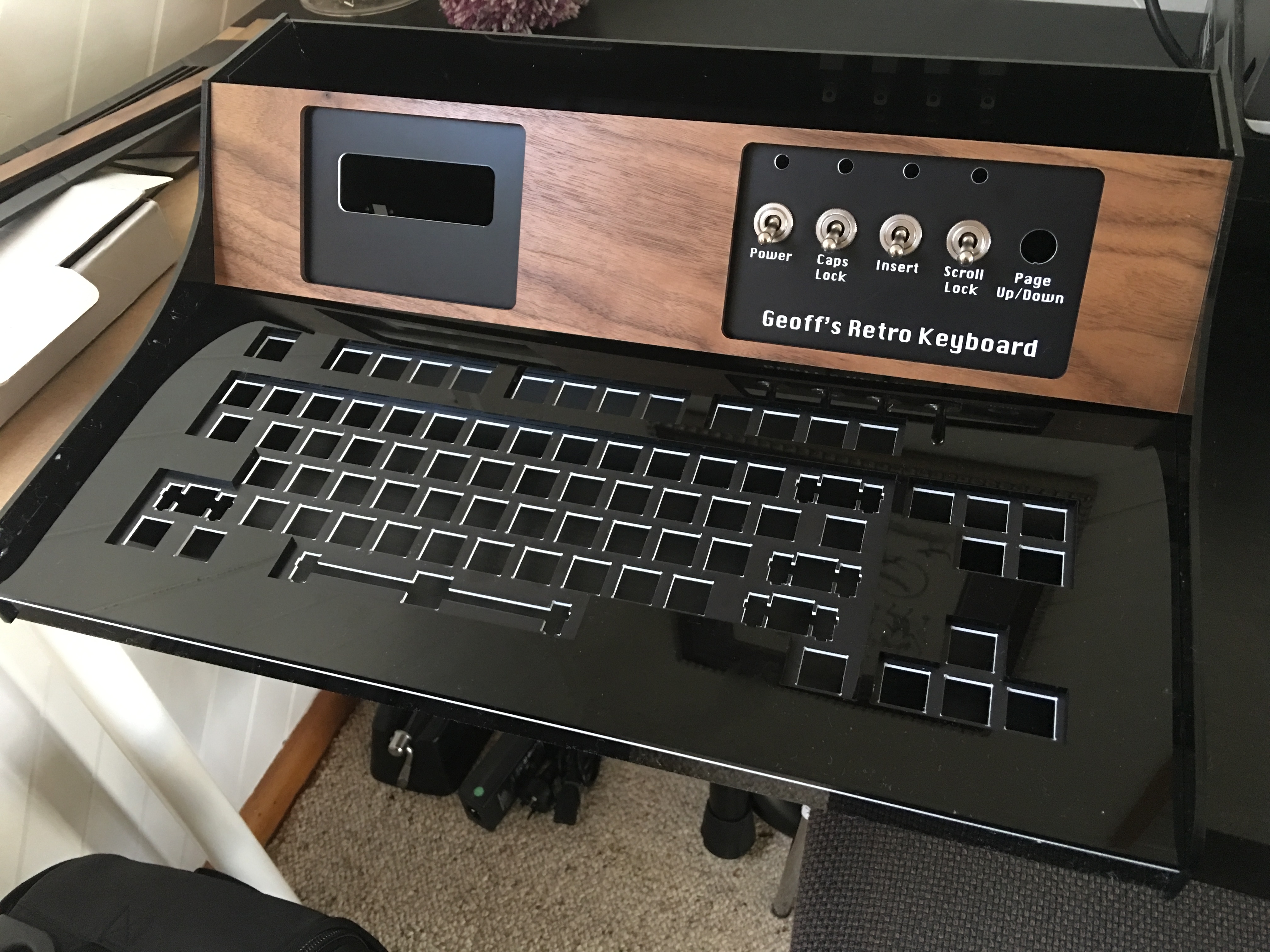

Just getting into this project after seeing an old HP-85 for sale. Thought I might be able to design a keyboard with a similar back panel containing a screen and some switches. Couldn’t find a good beige acrylic at my laser cutting place so I’ve gone for an Atari colour scheme of gloss black and dark wood.
This is my first go using laser cut flat parts to make a 3D design and I’m pretty happy with how it’s come out.
For reference the hole on the left of the back panel will house a 4 line LCD which I’ll use to report Caps Lock On, that sort of thing. I already have the display and it seems pretty simple to drive from my Teensy Arduino Board. The toggles on the right are labeled, just waiting on a momentary toggle for the page up/ page down switch as that one has to spring back to centre after being moved.
Switches-wise I’m intending to use Cherry MX black with 85g springs. Haven’t decided on keycaps yet, but something like PimpMyKeyboarf’s Grolsch is appealing.
Let me know what you think so far, or if you have any questions. Happy to go into any details.

Mine now has the LCD in and working, together with LEDs for Caps Lock and so on

Thought I'd add some images of the final keyboard.
I'm really happy with how the chassis turned out, the piano black with the wood panels looks really 80's Atari style.
The only mistake was the insert key, which I had to change to be a non-latching toggle because it doesn't behave like caps lock and scroll lock. So now that switch springs back to center after you press it, effectively behaving like any other key switch.
Maybe if I did it again I'd add a headphone jack too, because that'd definitely fit in. But overall, my best keyboard yet, now onto the next one!
