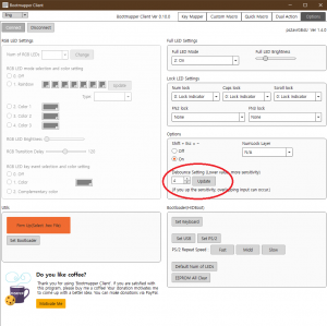

yeah, after a little investigating the lag was most likely due to debounce rate

Could you experiment with the debounce, as others have reported, and see if that produces lag?
I don't know what debounce is, I don't know that I want to introduce something that would create lag though
It's a configurable delay built into most firmware to deal with potential ghost keypresses if the keyboard matrix is scanned to often/rapidly.
The theory is that the lag is caused by the debounce delay being set too high and that lowering it will resolve the issue.
208594-0
Set it to 1.
If you run into issues with keys being registered multiple times keep bumping it up by 1 until it stops.
