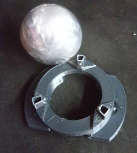

I also bought a ball/roller massger, took it apart and now I have a 54mm hard plastic perfectly round ball for under $7
Modelled and printed a case/support for it, I`m gonna use the same sensor ; pmw3360  to create a module or attach it to the right console
Destroyed a small bearing, took the tiny steel bearing balls and heat insterted into the 3d printed support, 3 supports, rolls nice and smooth, not as smooth as the real deal where zirconia balls are being used but is good enough for under $7

Finished designing most of the trackball elements, minus the sensor/teensy case which I`m gonna take from my mouse and adapt it for the trackball.
The sensor height/distance from the ball is adjustable by adding metal spacers/washers or nuts.
The scroll/jog has 44, 4mm holes for round magnets, those will trigger the reed switches/encoder, the ring is swappable, meaning, if you decide to go with less "scrolling power" you can swap the wheel without going to control panel and change settings for the scroll
Full metal bearing ball for the scroll piece, this is very smooth and will never go bad, as in develop play/become lose - https://www.amazon.com/gp/product/B007HS0HU6
The bottom picture is showing on the right side the steel screw/bolt, this can get close/away from the magnets. This will create "magnetic drag". If you want your scroll wheel to have hard/smooth/non existing feedback as where the next line is gonna stop.
Will use same sensor/teensy 2.0 like my mouse - You will be able to change the orientation of the sensor.
The tiny steel balls are easily inserted by holding them with tweezers and heating with a ligter/torch then aplying into position  (Last picture - I`ve misplaced those at first)
I will only upload the model if requested, please keep in mind that things will change the moment I have the new sensors shipped to me.
Its green because I`m testing and I wont use good filament  :thumb:

very nice. ball is sitting quite proud compared to most other trackballs i have or seen. i like it. more overall surface exposed.

Yes, lots of surface exposed, althought I`m little conflicted about that, the ball is loose as in if I turn it upside down, will fall. That translates into if you hit the desk/keyboard support with your knee hard enough (we all did it) the ball might jump out of the socket, if lands on hard surface might chip the ball. Modelling a lip to keep it in place is a solution but will take away from whats beautiful about it :)
One solution would be to have a steel ball coated in hard material (ceramic) and a round magnet under the plastic, strong enough to keep it in place. without adding the extra material. But that wont be cheap :)

i wouldn't worry about it. don't over think it. it's something that makes it unique. and how many times do you pick up your trackball or turn it upside down? now, if this will be mounted at an angle on your MEK, that might be an issue.
like the magnet idea too, even if not practical/cost effective.
depending on how strong the magnet is, it might inhibit ball movement anyway.

The sensor is a monster, I believe will work with a glossy glass ball too :)
Most important is the firmware and a ball, flip it upside down and roll a ball in front of the lens, about 3mm away and cursor should move but gonna be wrong axis.
If we/you get that problem solved I can create a multitude of options for ball size
