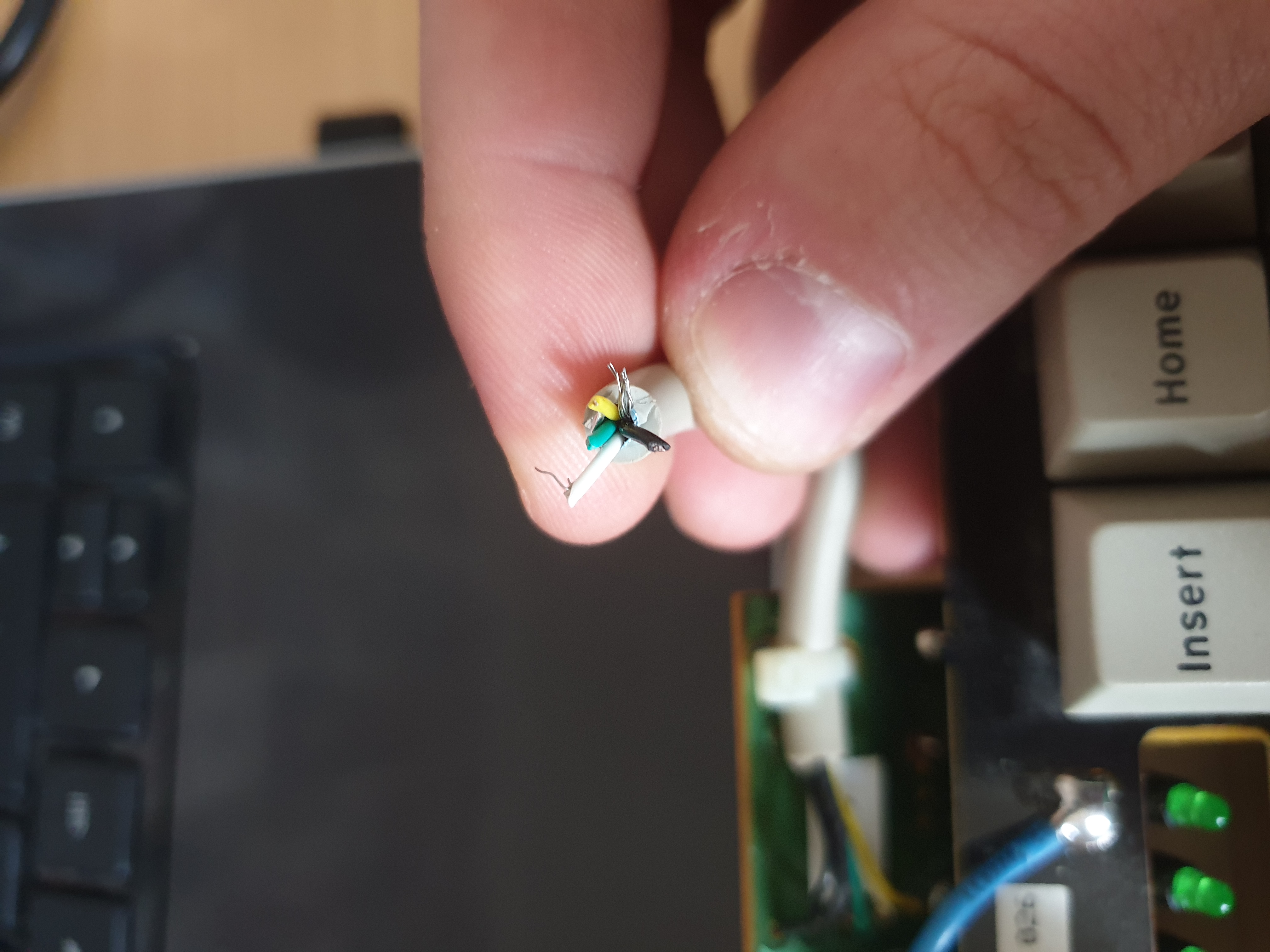

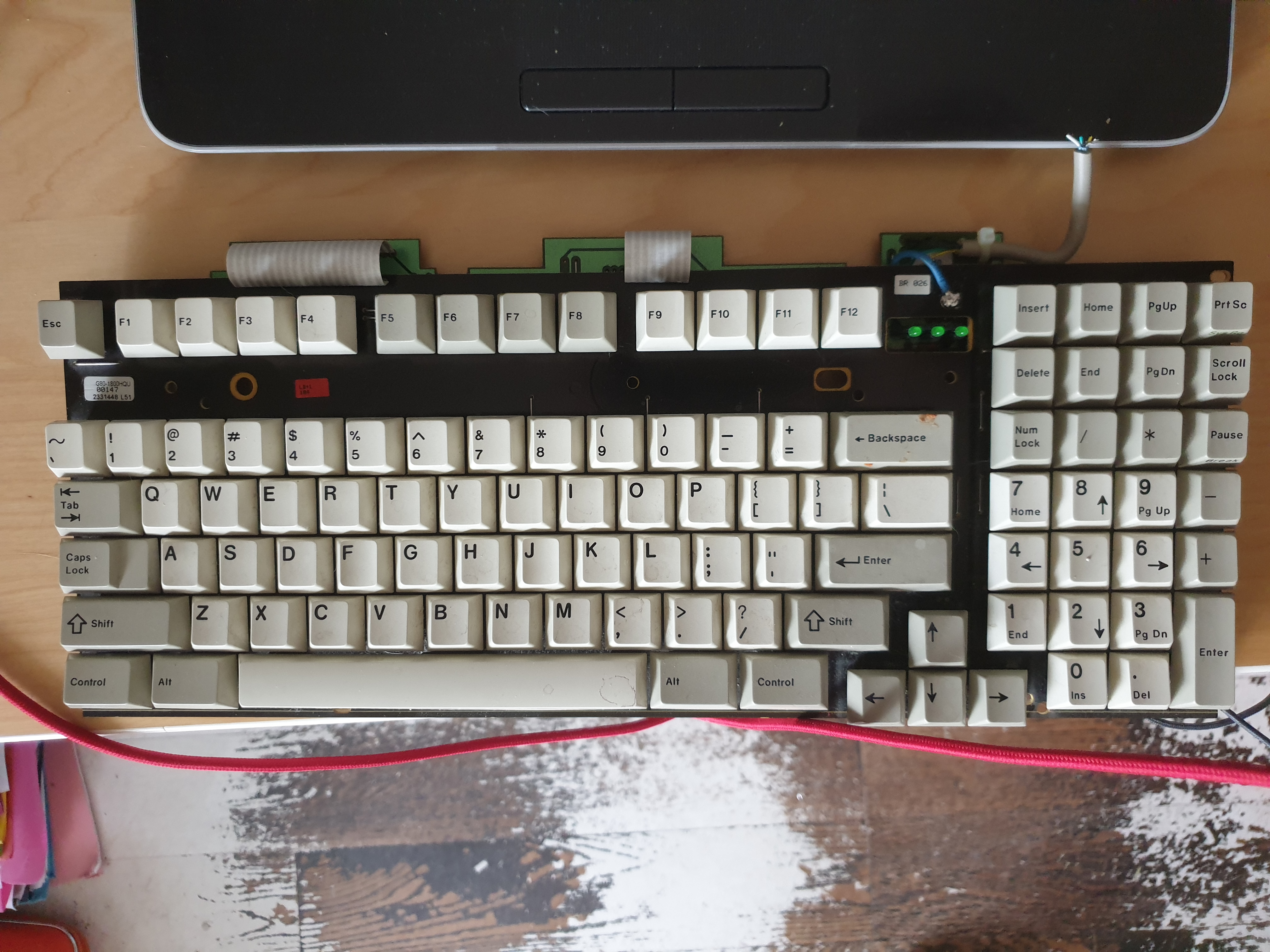

I found this Cherry G80-1800 yesterday, tryna make it clean and working, but i'm also kinda newbie into "vintage" keyboards.
The cable has been cut, but in order to replace i'm trying to understand what the hell are those connectors corresponding to ? I can't find any documentation or anything that could help me understanding where is the data, Vcc, ground, clock, ... to solder a USB connector to it.
I read a lot of topics on the platform but no one's talking about connectors issues, so i hope it's crystal clear to you and that you would be kind to help me bring this baby back to life  ;D
212689-0
212691-1
212693-2
212695-3
Thank you guys, if you need any informations just ask me, it's next to me :D

1. you have to figure out what color wire/pin relates to which pin on the original ps2 connector. i'm not familiar enough with the controller in the 1800 to advise there.
2. you will probably need a ps2 to usb converter, don't think you can just wire it to a usb cable. although, i could be wrong.
backwards from what you want to do but the pinouts should be helpful.
https://www.instructables.com/id/USB-to-PS2-convertor/
http://pinouts.ru/Slots/USB_pinout.shtml
http://pinouts.ru/Inputs/KeyboardPC6_pinout.shtml
« Last Edit: Mon, 11 February 2019, 07:18:33 by nevin »

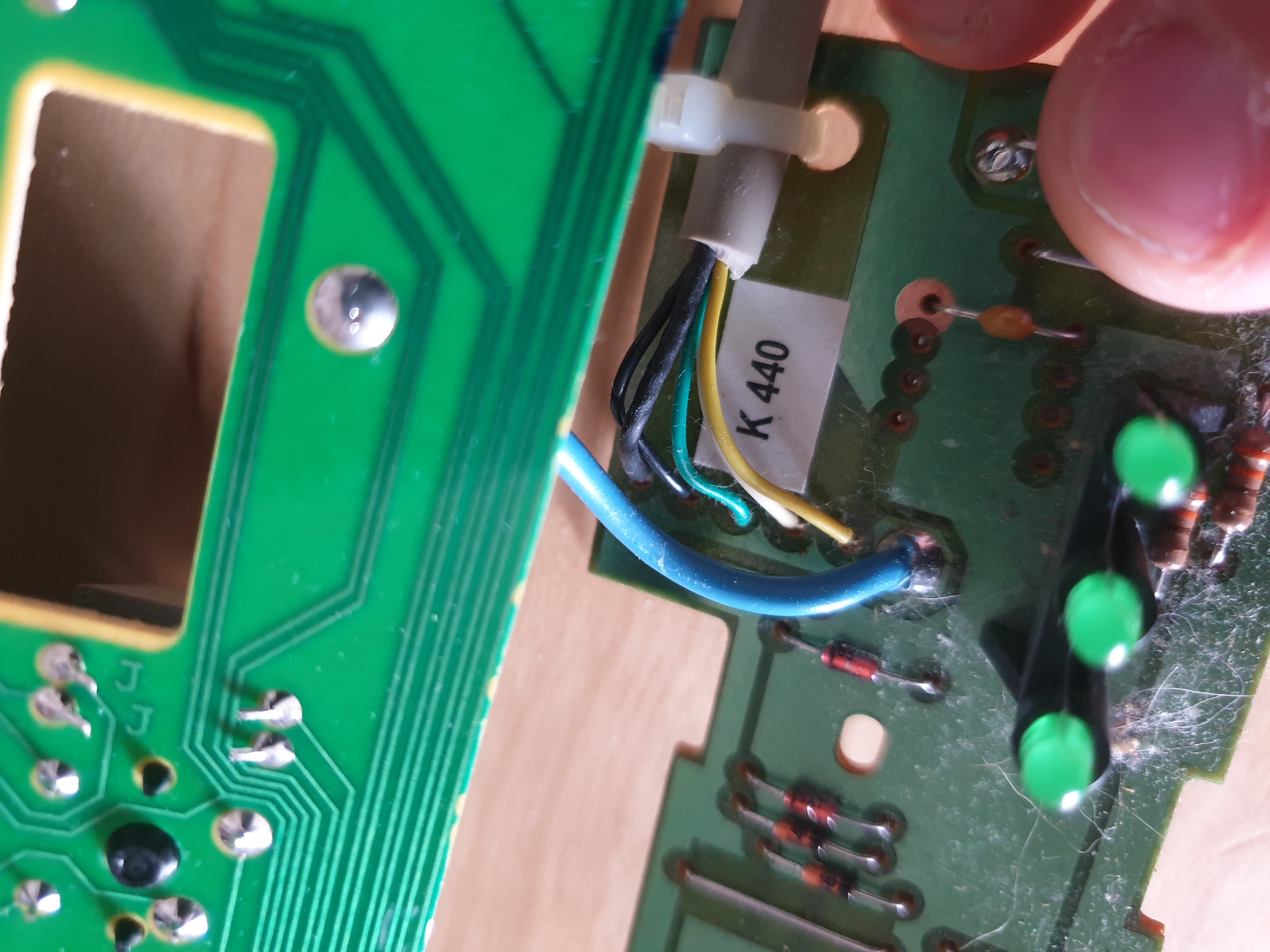

ok. on the g84-4100 that i mentioned, here's what i got....
   - remember pinout is for the plug end (female receptacle will be reversed)
212725-0
212726-1
functionplugboardcolor
data15white
NC/ground23black
ground31black
+5v44green
clock52yellow
NC6-
212727-2212729-3
hope this helps
« Last Edit: Mon, 11 February 2019, 09:40:08 by nevin »

either wire in a new ps2 cable and use an external ps2 to usb converter, or, if you have room in the case, you could wire in a ps2 to usb converter inside the case and either have the usb cable running out or add a usb connector for a removable cable.
or replace the controller altogether.

DUDE this is perfect; exactly what i needed ! But i quadruple checked and i dont have any PS2 stuff here :mad:
So i'll try to connect to the right pins of a USB cable and hope this works, and if it is, i think i will solder and install a little micro-USB or type C female in the keyboard ;)
I'll tell you if it works by the way ! Maybe this keyboard was thrown for a good reason  :-X

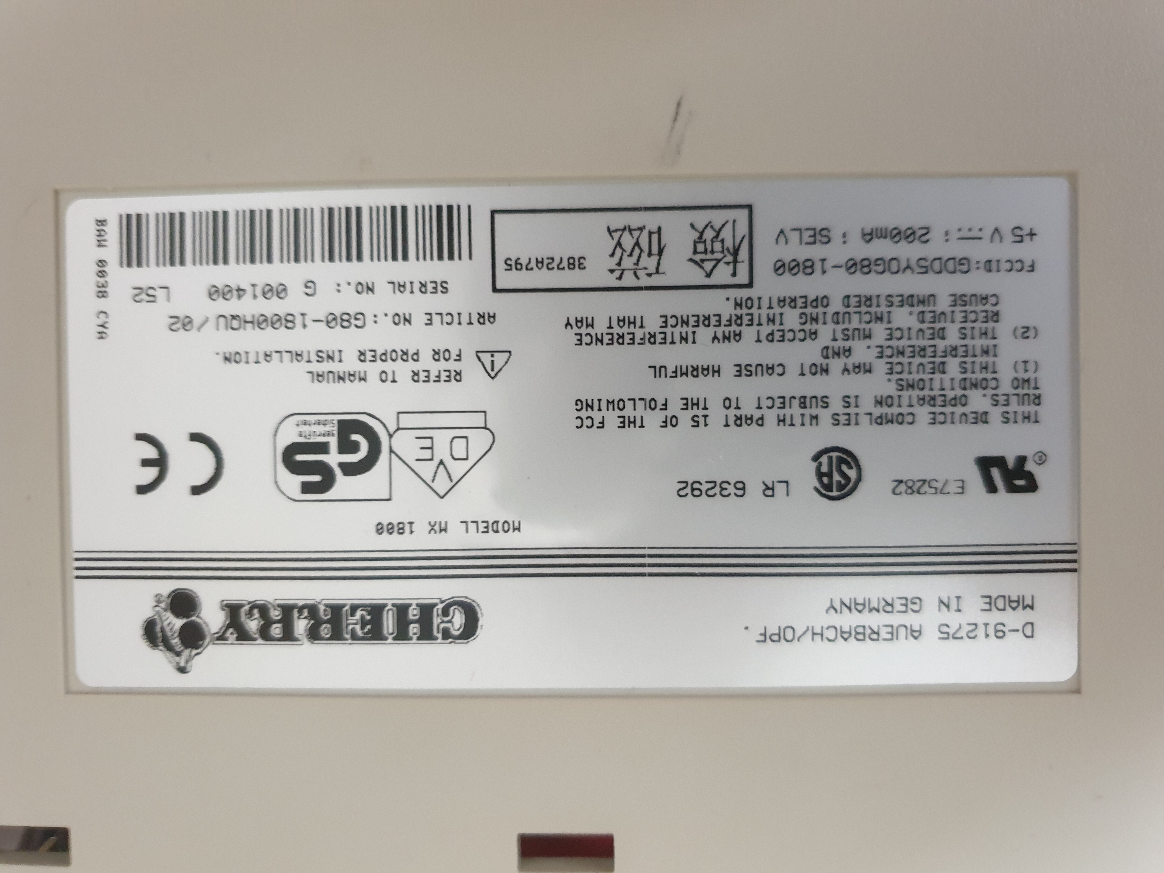

also, looked at the sticker again on the back of your board.... 1800HQ.... mmmm... cherry double-shots....
even if the controller is shot, the caps & switches are well worth it.
