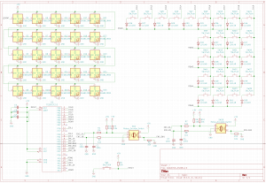

So new member status makes it pretty clear I am very nice to this. This is my first time using KiCad not to mention the technical side of electronics in general.
I have been mainly referencing KiCad projects for keyboards that I have found on Github. So I understand the schematics only up to a point. I've now reached that point that I am designing my own editing/transport controller for my DAW.

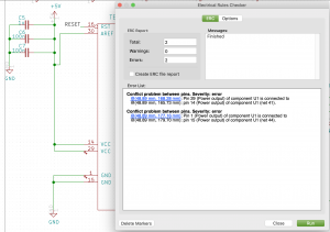

I've attached my schematic for my design however I keep getting these errors. Now, the parts of my schematics are a bit of an amalgamations of the keyboards that I have liked based on their schematics I've found so I assume they should work. Not confident enough to move onto the following stages leading up to spending money to have the PCBs made and wasting time and money. Would anyone be willing to look over my work and tell me what is working and what isn't?

The errors are clear and visible in the schematic - the two pins each for VCC and ground are connected.  If you have a Teensy in front of you check for continuity between those pins on it, wouldn't be surprised if they are connected and if they are connecting them again on your PCB wont change anything.
Not saying the rest is good (or that it's not) as I'm on mobile and the pic is too big/small!

So this was the remedy to the error message.
247881-0247881-1
I'm assuming since I have just one power source I won't need the additional GND and VCC? And the assumed voltage of the Teensy 2.0 is 5V there is no need for the AREF pin.
Is that correct?
