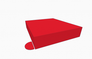

Dealing with shrinkage
As mentioned earlier, problems go up as you increase size. Some plastics shrink up to 8% as they cool, you see this as lifting.  One way people deal with this is lily pads (there is multiple names for it), put a thin disk, I use 10mm radius, 0.5mm high pads. Most people who use these put no break line and when they remove them not only is it more difficult but it leaves the inner honeycomb exposed. Instead, put a small gap between your part and the pad (use half your printer's tolerance), this way you retain a solid wall once it breaks away.
292602-2
These are nice because they are simple and if it starts to lift you can even use hot glue or C.A. glue (cyanoacrylate or super glue) to glue them down for even more grip. Fair warning though, if you do this you could ruin your bed surface, you could even ruin your bed plate entirely. I personally use a THICK glass bed plate for this very reason. GLASS?! How barbaric! Yes, but it works. On my PF65 when printing in PLA used lily pads, when I switched to PETG I had to use lily pads, but also hot glue on them to avoid a bit of lift, though to be fair I wasn't using a heated bed when I printed it.
The other way to hold down parts better is to de-stress them internally by inserting relief channels into the part. Make a thin solid floor and walls, but from there place a 2 layer thick, 0.2mm wide slot inside the part to relieve the tension as it prints. As shown here. Keep just enough wall to hide this. The impact on strength is negligible. Basically as the plastic shrinks it pulls more and more for each layer, hence lift, this gives it a chance to relax as only the sidewalls are now pulling and they don't have enough strength to overcome bed adhesion. This gives a chance for the rest to relax and set before continuing on, and from here the entire print lacks the leverage to pull up the print no matter how much shrinkage you have. TL/DR you're you're reducing the amount of pulling power at each end of the print.  This is a good tactic if you're doing production runs since you put them in once and never have to deal with it or cleanup again, but they are more difficult to place  and if the print lifts you can't use these to save it, so pads are still a good option. I usually go with lily pads first and only go this route if I have to or plan on doing lots.
292604-3

A question though: I don't really understand how what you call "lily pads" work...
From what I understand, you use them to have better bed adhesion  preventing shrinkage.
But then, you advise to put breaklines. I do understand that's meant to be able to remove the pads, but on the figure, it seems the pad is completely separated from the part's wall...
What am I missing?
Thanks for your help
Offline Leslieann
  • Posts: 4574
There's a 0.01mm gap between the part and the pad, it's just exaggerated because it's zoomed in.
Most printers have a tolerance of 0.2-0.5mm tolerance, it will fuse but not at full strength. It's the same way support towers break off, they leave a small gap while printing, the only difference is this is horizontal instead of vertical.
