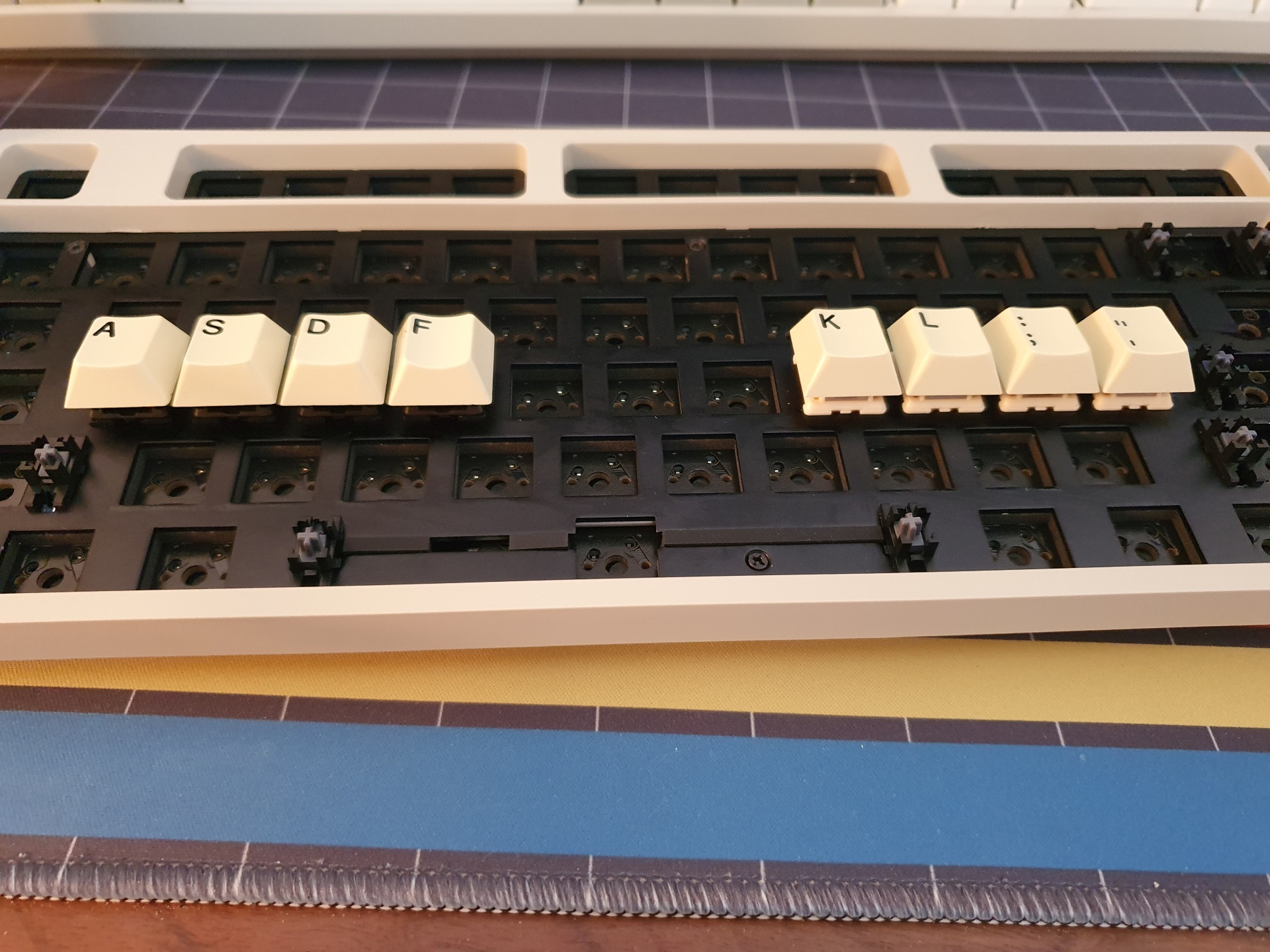

I tested them against Oil Kings, mounted on same keyboard.
317834-2
Right out of the box, they feel the same as other linear switches with similar force. For me its a bit too light, so will swap the springs with some 80g 22mm, but if you are after regular red switches, they are perfect. I dont hear any spring ping, they sound pretty good, a lot more thocky than mx reds. I think POM housing adds to their sound.
I dont do RGB lights, but these have those diffuser inserts, so will nicely spread light.
Factory lubed, they feel a little bit more scratchy than Oil Kings, but same as MX Reds, which I tried in the past. If you prefer to lube all your switches, these would gain more smoothness from re-lubing. I may even keep the original spring and have one keyboard with light reds for light caps like GMK.
Overall, pretty good linears, if you don't want to spend 3 times more on other ones.
