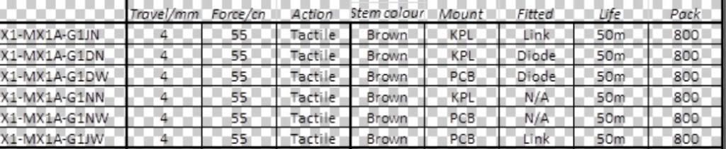

Hey guys, I was wonder if I can replace the blue switches for the brown switches, so i wrote an email for QWERkeys and they sent me this picture about the models.
Does anybody know what part number exactly "fits" in this keyboard?
Edit: Well, according to DeskthorityWiki:
  • MX1A-xyNN no diode, plate mount (no fixing pins)
  • MX1A-xyDN with diode, plate mount (no fixing pins)
  • MX1A-xyNW no diode, PCB mount (with fixing pins)
  • MX1A-xyDW with diode, PCB mount (with fixing pins)
Okay it's plate mounted. Now I need to know, with or without diode?  What's the difference?:-X

The switches are the same, however you can purchase switches with or without a diode pre-installed.  You can always put a diode in it if you end of needing that.
I read something about n-key rollover. In that case better buy all with diode.
Thanks.
