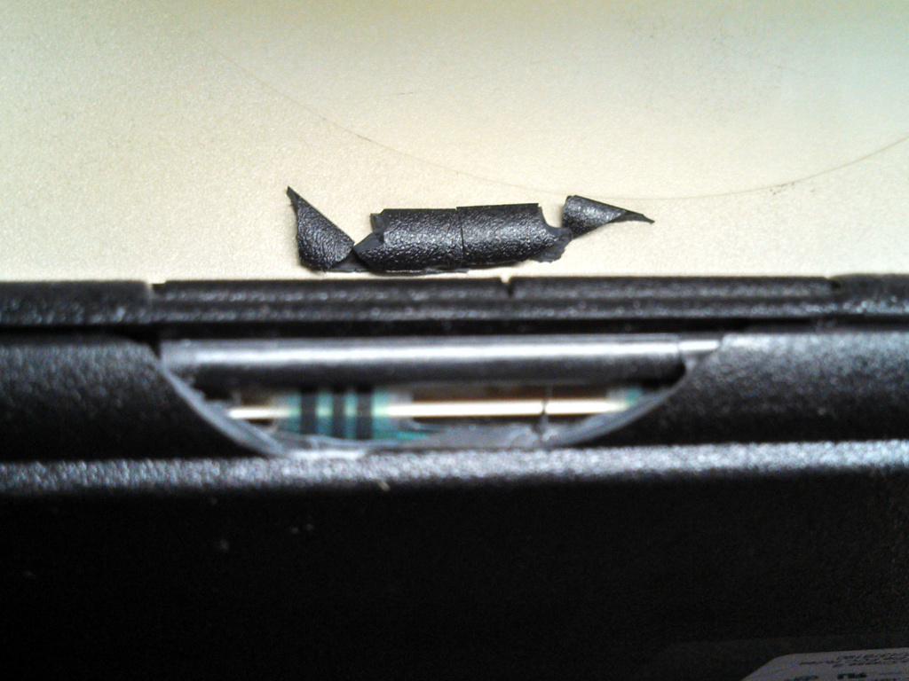

Recently picked up an M13 that got damaged during shipping:
The trackpoint buttons took a hit but popped back together OK.  The keyboard works fine.  Some crazy glue, a few layers of paint, some wet sanding, and some texturing with the rattle can and:

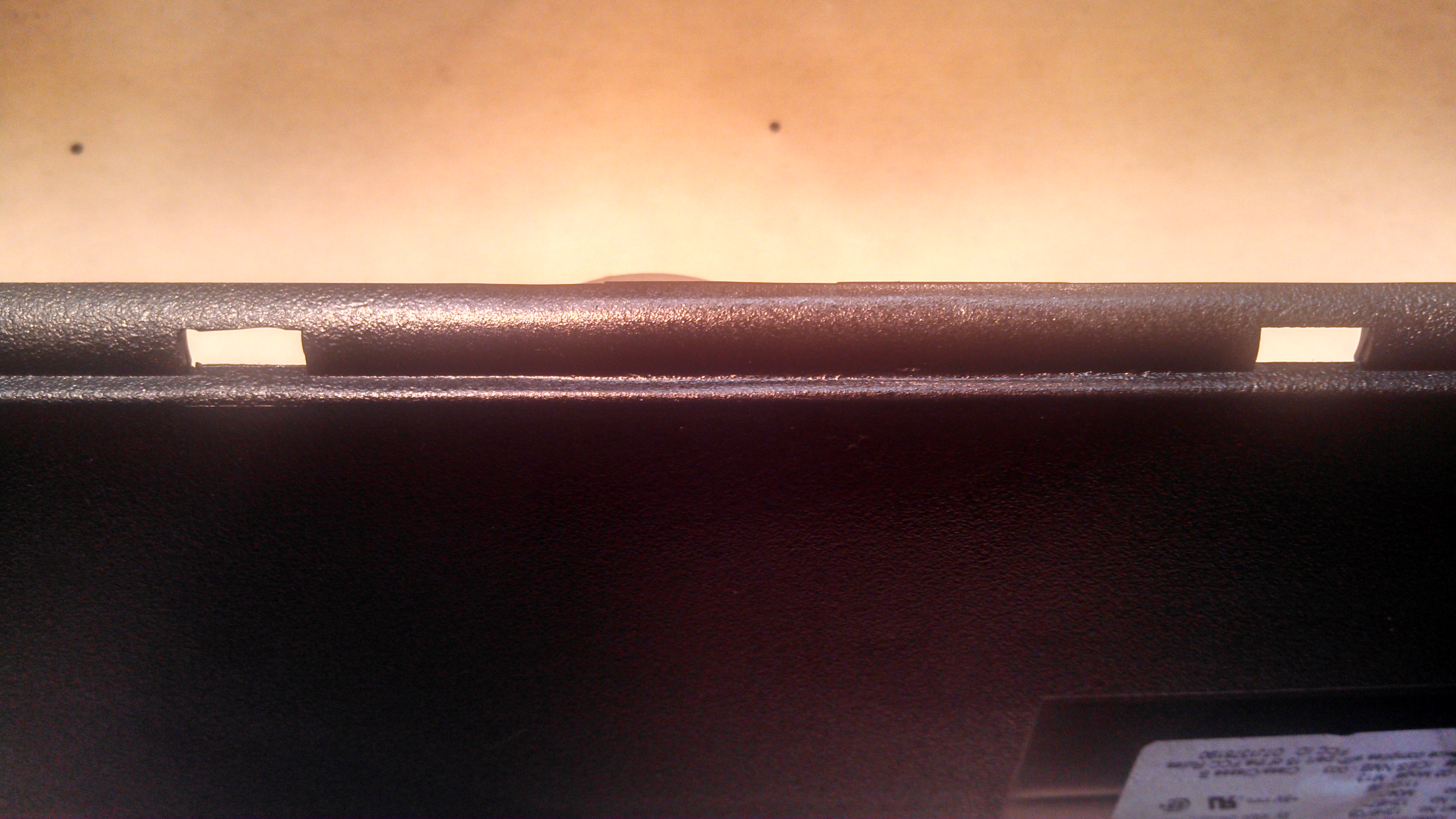

All fixed!

Oh thank gods it was there. The M13 chassis is notoriously weak in that whole area. If it'd been the upper shell, yeah, nope. The part between the retaining clips on the lower shell that broke, well, yeah. Also pretty damn weak, though I'm not sure why.

Fantastic fix!  You can't tell it was even so much as scratched.
But... the photo right above it... ;)
(Also I was rummaging to see if I could find genuine IBM Stealth Black touch up paint for rknize - fix that nice deserves the genuine article! Alas, I think I am out.)

Yeah, the case is weak there because they seem to add an overlay on the mold that scoops out a channel in the plastic for the flex cable from the buttons.  The crack started right at the seam there and spread out to either side.  I was lucky it was on the bottom and not the top.
Thanks for the offer for the paint.  This particular satin paint turned out to be a perfect match.  The crappy cell phone photo doesn't show the color that well.
