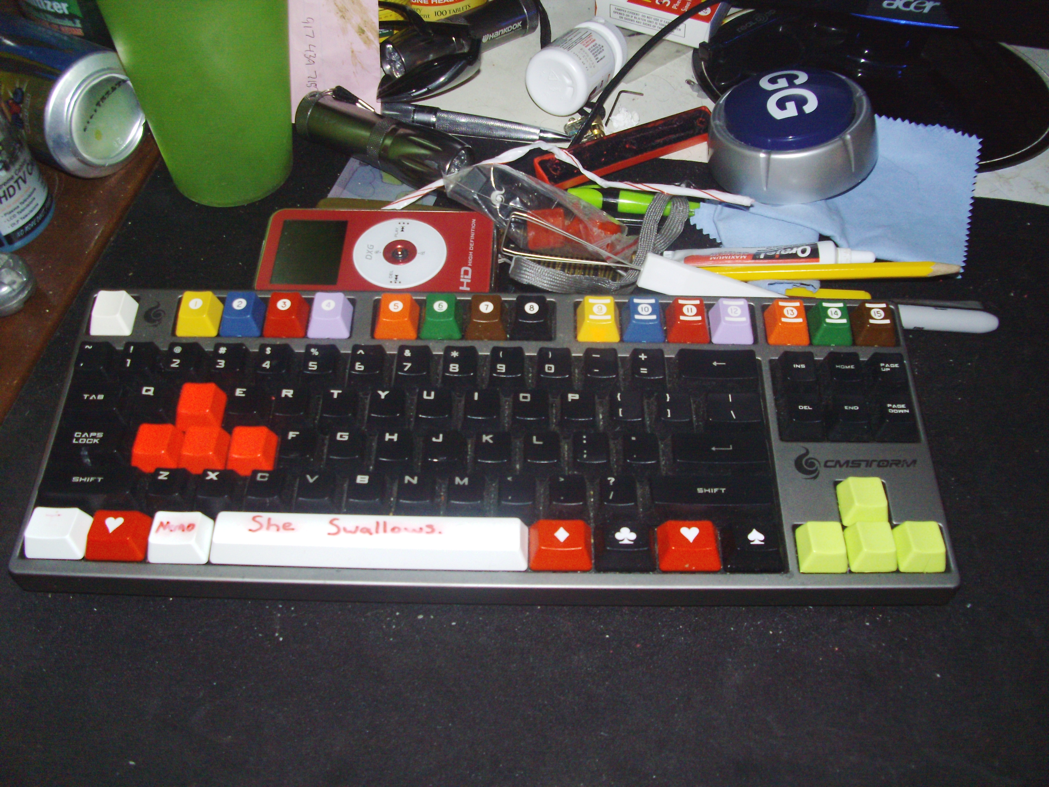

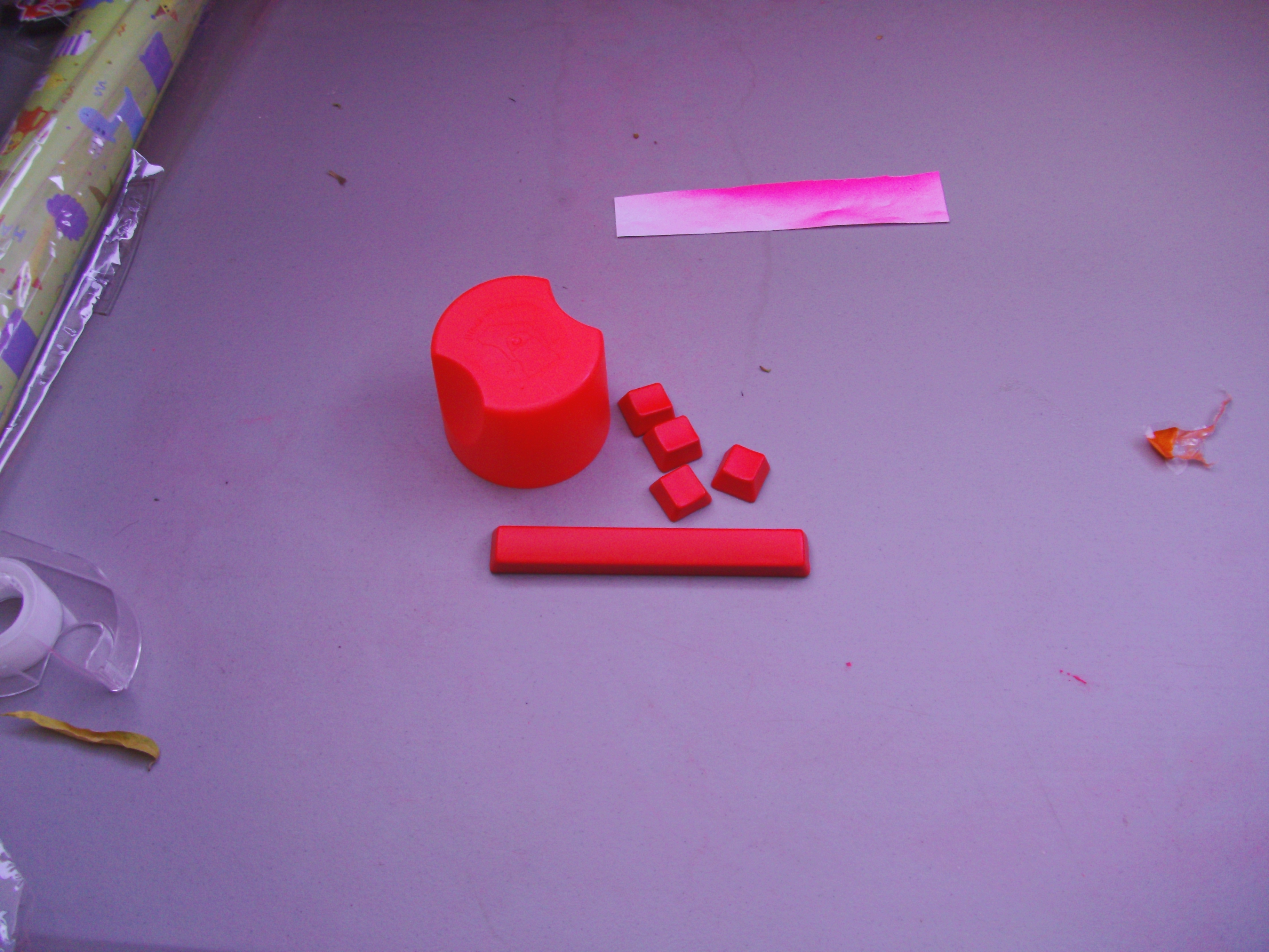

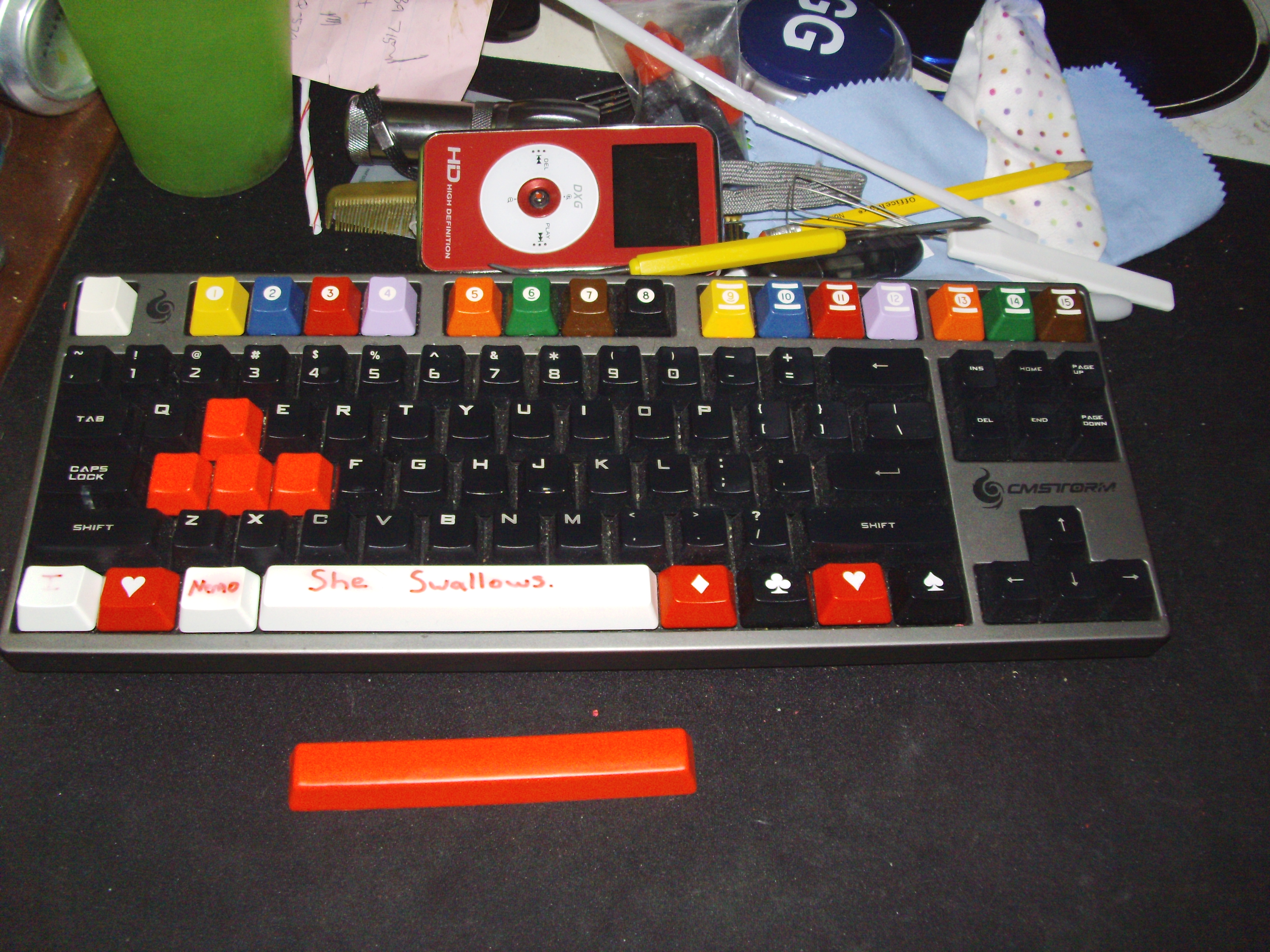

I've actually done this over the past week. I was planning to do some stenciling on some keys but it became too difficult a task.
I ended up spraypainting some extra keys I had using krylon flourescent pink and they appear to have turned out pretty well. It took about 8 coats in total to get good coverage, but I was using black keys. I let them dry for about 2 days after I was finished and they feel very nice, still not completely dry and could probably scratch some paint off with brute force but I think they have cured for the most part now. I used 220 grit sandpaper to scrape my keys up a bit. Surprisingly I wasn't able to scratch the letters off my CM storm keys with the sandpaper so kudos to cooler master.
I could probably save some paint if I'd used some primer or lighter keys. I think I may have found a new hobby though to say the least :D. Will post pics later.

They seem to look red under unnatural light. Maybe flourescent isn't the best paint to go with, just didnt see any other color pink I liked at the store. In the end I've decided for my original project just to write on my white keys with red sharpie, and go over it with clear nail polish :D

spraypainting my arrow keys at this moment with some rustoleum brand plastic bonding lime green... i have a feeling these wont turn out as well, will post pics

« Reply #25 on: Mon, 04 February 2013, 20:10:41 »
update, just finished letting these dry (white/pink)
