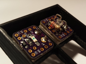

These are some little experiments with backlighting Matias switches.  I tried two general approaches: ordinary through-hole 3mm LEDs, pointing up under the switch, and reverse-mount SMD LEDs, which mount on the back surface of a PCB and point up.  The idea of a single-key switch was inspired by the Enabler by Melvang & MOZ, and the Amoeba by mtl, and I'm definitely not the first person who thought of shining an LED through a hole in the PCB for lighting Matias switches (e.g. here).  While those single-key PCBs both support Cherry switches, that had to be sacrificed on mine to allow SMD backlighting.

parts supported:
  • any Alps-compatible switches (but no point in backlighting switches that aren't translucent)
  • through hole, 0805, or 0603 resistors
  • through hole or 1206 reverse-mount LEDs
  • through hole, SOD80, SOD123, or SOD323 diodes

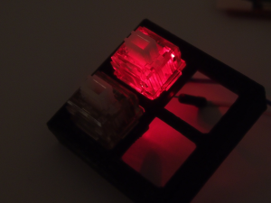

122875-2
The through-hole LED idea takes up about an extra 7mm from the bottom of the PCB, which is probably impractical for any real keyboard, but the reverse-mount LEDs work well and big enough to be easy to solder by hand or by solder paste/hot plate.
The exact LEDs I used are LTST-C230KRKT since they're available from common distributors and are pretty cheap (less than $0.10 @ 100u, less than $0.05 @ 3000u).  The datasheet says you should make a square hole for them, but I used highly advanced mathematics (or, uh, basic geometry) to just pick a circular hole size that could be drilled instead.

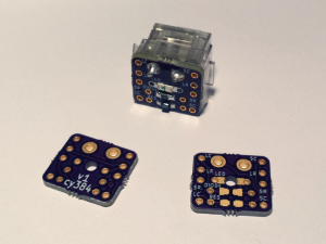

what's next?
This is my first PCB, so unsurprisingly I messed up some of the silk labels and swapped around some of the SMD pads.  The next version will be slightly smaller to fit through Alps-sized plate cutouts easily and will remove the through-hole LED option.

« Reply #5 on: Sun, 07 February 2016, 12:35:29 »
127410-0
Designed another, smaller version, it's now 14.12x11.30mm, which is small enough to fit through an alps-sized plate hole.  Dropped the through-hole LED option, added some little markers for wiring directions.  It seems like a finished design, I haven't thought up any particular changes in the past few weeks.  I do have some ideas that go in a completely different direction, I'll post those as I work on them.
