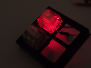

These are some little experiments with backlighting Matias switches.  I tried two general approaches: ordinary through-hole 3mm LEDs, pointing up under the switch, and reverse-mount SMD LEDs, which mount on the back surface of a PCB and point up.  The idea of a single-key switch was inspired by the Enabler by Melvang & MOZ, and the Amoeba by mtl, and I'm definitely not the first person who thought of shining an LED through a hole in the PCB for lighting Matias switches (e.g. here).  While those single-key PCBs both support Cherry switches, that had to be sacrificed on mine to allow SMD backlighting.

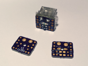

parts supported:
  • any Alps-compatible switches (but no point in backlighting switches that aren't translucent)
  • through hole, 0805, or 0603 resistors
  • through hole or 1206 reverse-mount LEDs
  • through hole, SOD80, SOD123, or SOD323 diodes
122875-2

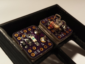

The through-hole LED idea takes up about an extra 7mm from the bottom of the PCB, which is probably impractical for any real keyboard, but the reverse-mount LEDs work well and big enough to be easy to solder by hand or by solder paste/hot plate.
The exact LEDs I used are LTST-C230KRKT since they're available from common distributors and are pretty cheap (less than $0.10 @ 100u, less than $0.05 @ 3000u).  The datasheet says you should make a square hole for them, but I used highly advanced mathematics (or, uh, basic geometry) to just pick a circular hole size that could be drilled instead.

This is my first PCB, so unsurprisingly I messed up some of the silk labels and swapped around some of the SMD pads.  The next version will be slightly smaller to fit through Alps-sized plate cutouts easily and will remove the through-hole LED option.

Found this the other day, http://imgur.com/a/JMvav
I think 2x3x4mm LEDs would be much better.

« Reply #3 on: Tue, 05 January 2016, 15:49:36 »
Yeah, the 3mm round LED idea didn't turn out great.  Putting rectangular ones on their side works nicely with PCBs that support both Alps and Cherry switches.  Though I wonder if there are LEDs in that size that only shine from one side, rather than in all directions, since a lot of that doesn't go through the hole.

« Reply #4 on: Tue, 05 January 2016, 16:40:52 »
Yes, there are, side lens or side something is the magic word, search for them in DIgikey or Mouser, they have them, at least in SMD footprints they exist.
