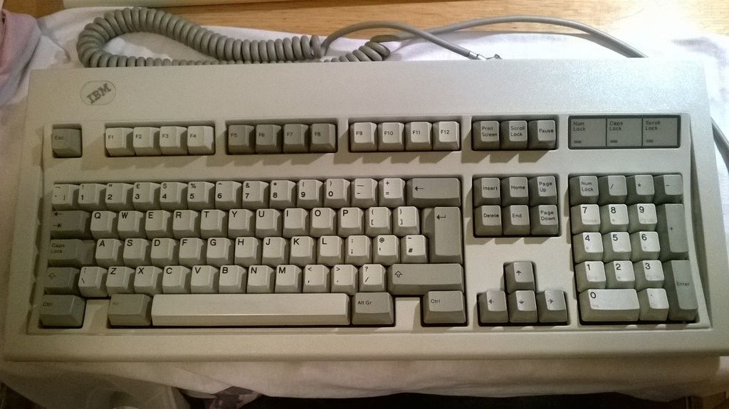

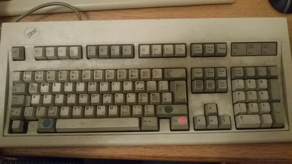

So I got this mystery, unlabelled Model M from the uni that I posted about a while ago, and opened it up. It's from 1987 apparently - same year as me! As many as 17 of the rivets had snapped off - quite a lot. Figured it could do with a bolt mod as I wanted to see if I could improve it. It was INCREDIBLY filthy when I got it:

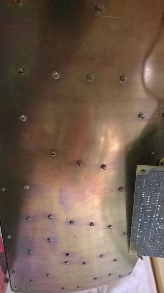

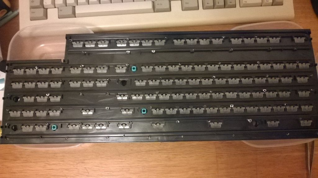

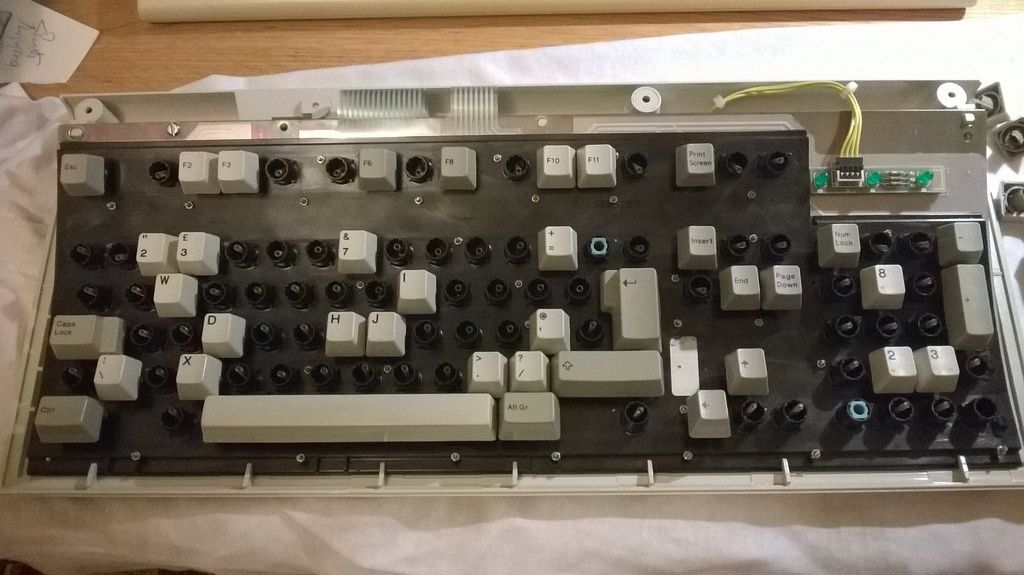

The key stickers on it were unsalvageable (and annoying anyway) so I peeled them off and cleaned the hell out of everything. I don't have a drill so I had the guys from the mechanical workshop from my uni drill the holes in the barrel plate for me as a favour - they're highly skilled craftsmen equipped with great tools and had the job done beautifully for me - thanks Robert! They also provided the nuts, bolts and washers - I used two different lengths depending on where in the keyboard the bolt came out (I used shorter bolts where they might clash with the top cover or the stabiliser bars on the numpad). And tadaa!
barrel plat with hammers and holes drilled out
the steel plate with bolts
nearly there...
Finished!
Keyfeel and sound has improved noticeably, all keys work and and the keyboard looks virtually brand-new. Hope you guys liked this message :) . Also, many thanks to Azhdar for providing me with the missing ctrl key! :D
