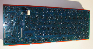

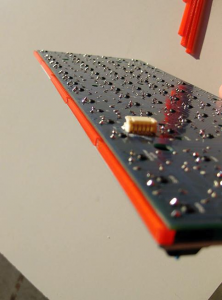

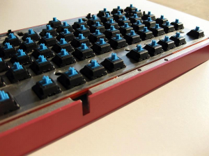

A while back I was making these for people but here they are.
These slide between the universal plate and the PCB providing a lip for the case to grab onto.
Stock Filco plates have a lip that is missing on universal plates, this lip is what holds the assembly together.
218910-0
Use:
Despite how they look they are not a rectangle, they are "L" shaped, the thicker leg slides between pcb and plate while the smaller lip pushes against the pcb preventing it from sliding in too far. 5 go across the top, 4 go across the bottom, one less is used because the spacebar stabs get in the way. Do not clamp down super tight on the case or it can crush the spacers and you want to make sure it's clamping evenly.

Compatibility:
They are known to work with Vortex TKL cases and Filco TKL pcb, however the Tex case should work and any standardized TKL pcb should work if it fits a universal TKL plate. There is also reason to believe these will work with matching full size keyboard/cases as well but I don't know if anyone has tried it (you will need more adapters). They also may allow a universal plate and possibly a Phantom PCB into a Filco case but again, this has not been tried.
