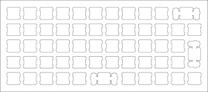

So, I have designed and had my first plate cut. I thought I would be smart and use 1/4" (5.588mm) acrylic so that I didn't need to worry about flexing of the plate.
Most of you realize that I made an error not allowing for the cherry MX clips to function, and after getting the switches, now I feel like I just made an expensive mistake.
149745-0
Is there anyway I can apply and adhesive (epoxy/superglue/etc) to hard mount the switches to the plate? I am not worried about replacing the springs or being able to remove the top. Although I already have the plate cut with the extra notches.
Any help is greatly appreciated.

hot gluing the switches on the back of the plate would work fine

its not uncommon for people to order thicker acrylic plates and hot glue the switches, in you may even be able to get away without gluing them if they are a tight fit and you don't plan to remove the caps.

I have tested the switches in the plate. Unfortunately they are not that tight of a fit. I will try hot glue, and hope it holds well enough.

Is this okey for cherry mx and cherry stabilizers?
