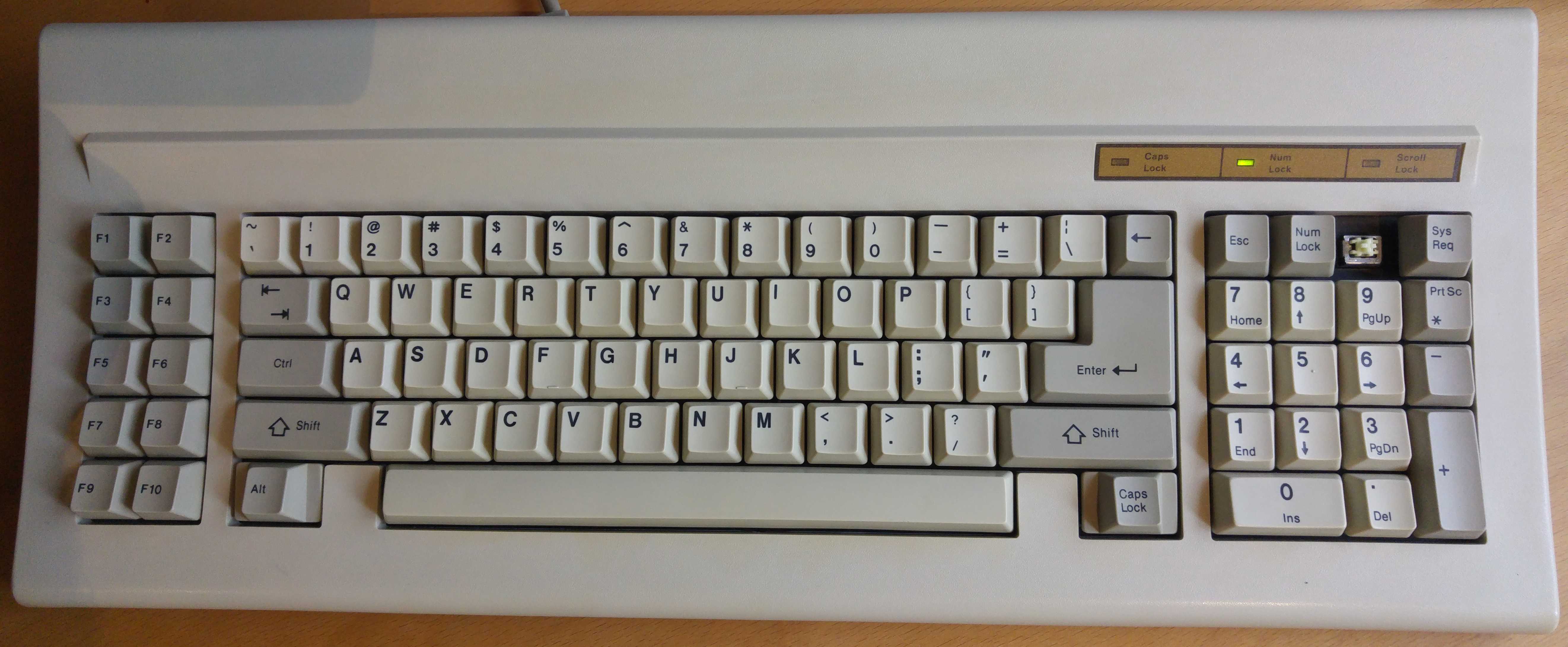

Came across this on German eBay.
Checked the Deskthority wiki and everything fit the description of KB-5160C - Alps SKCM Blue - which I'd been hunting for in an affordable and reasonably clean incarnation for about two months now. Not wanting to lose out to another (the listing was only about an hour old), I went for it, not even bothering to suggest a lower price than the 79€ asked, which seemed like a bargain.
Weeeeeell, here is what I got:
164255-0
164257-1

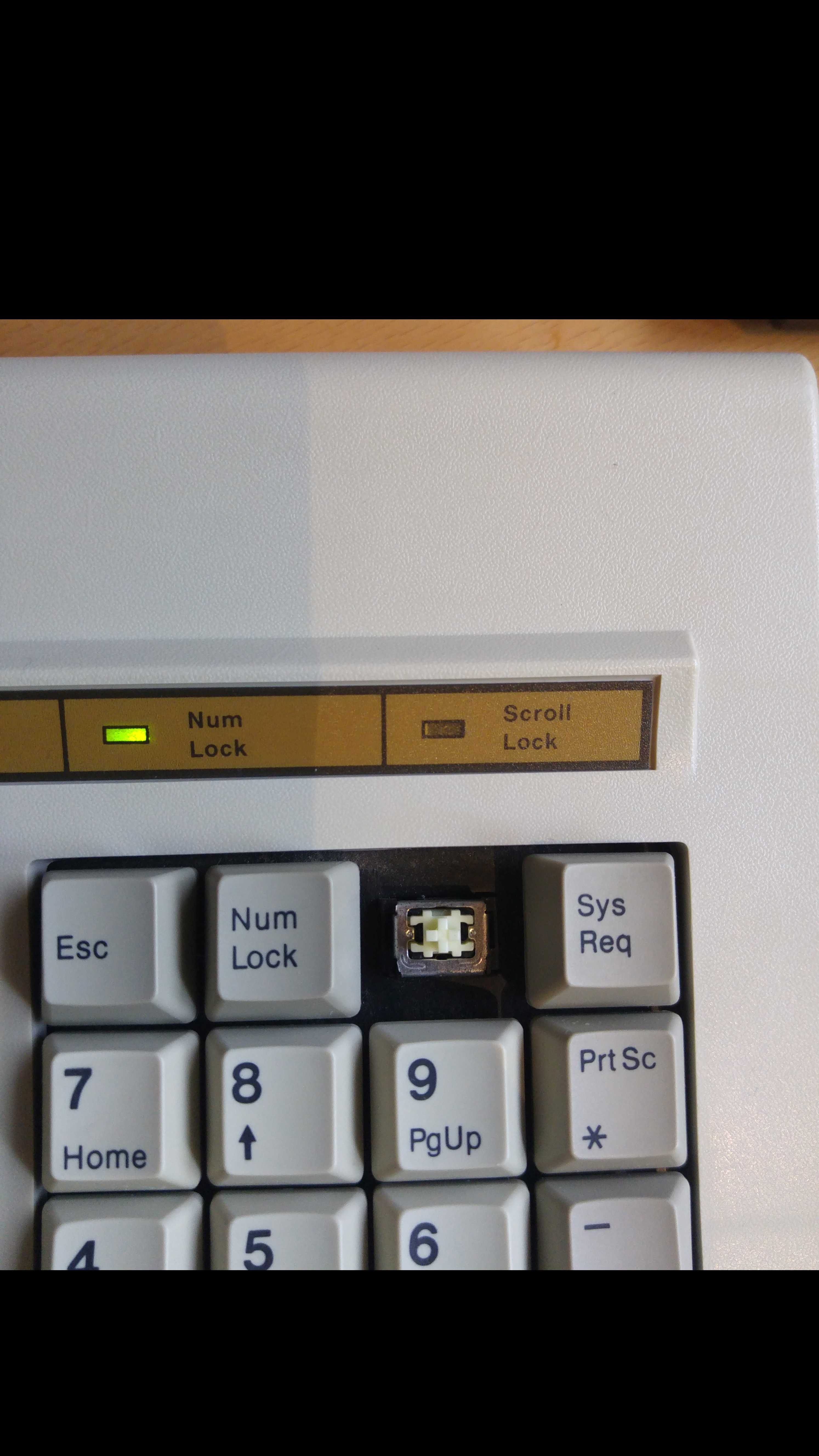

Effing Mitsumi miniature mechanical switches!
In all honesty, this is the worst keyboard I have ever laid my fingers on, virtually unusable even though it is in near-mint condition. If you want to know the details, check out chyros' Youtube review here.
As you can imagine, I am now seriosuly depressed - no blue Alps and the best I can expect is to sell this piece of junk at half the price to someone on these forums who wants to take it apart or see for themselves how bad it really is.
As therapy, I'm working on my first contribution to the Deskthority wiki to save fellow humans from falling into the same trap...
There, story told. If anyone has a usable blue Alps board, preferably ISO layout and not too expensive, feel free to let me know.

In this board at any rate, the switches are a mess. Strokes frequently don't register unless pressed really hard and dead center (see link to video review above). Maybe Chicony just did something fundamentally wrong in the way they combined them with the other components...
