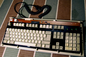

Hey guys,
I found a Monterey K101 in a thrift shop yesterday:

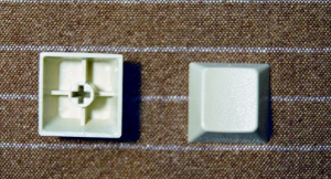

I thought it might have Alps switches, but when I removed a cap, I didn't recognize the switch type:
Do you know what they are? Something unremarkable, probably, but I checked a lot of photos and couldn't find anything like it.

Mitsumi Miniatures with MX mount, theyre quite nice actually. :)

I just found that Cherry caps fit these perfectly. Does anyone know where I could get an F11 with this profile?
UPDATE—This cap's dimensions are:
   Base: 18 x 18 mm; top: 10 x 12 mm; height: 10 mm

Hey guys,

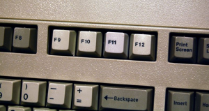

The nice people at WASD made me a replacement Cherry-mount F11 for my K101. The profile was a bit high—but fortunately, while the Mitsumi Miniature's mount is the same shape, its stem is shorter, so I was able to Dremel 2mm off of the keycap's channel to make it the right height. The color isn't an exact match, nor the printing (a bit of space after the F would've been nice), but it withstands a casual inspection:
100469-0
100471-1
I wiped the keys down with alcohol, but there wasn't a bit of grime on them—so even though it wasn't in a box, this KB doesn't seem to have been used.

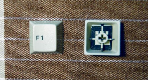

...except for the F-keys and Esc, which are dye-subbed—however, the blank "macro" key (between L Ctrl and Alt) is double-shot, go figure!:
100477-4

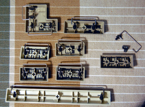

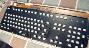

Lots of stabilizers, including two on the big-ass Enter, going different ways:
100479-5
Rather than using hooks molded into the keys' bottom edges, the stabilizers attach to the keys via separate little brackets that fit into the keys' extra channels.

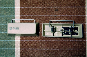

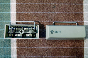

I thought it was funny how L Shift was completely double-shot, but R Shift only half (maybe this is common?):
100481-6
100483-7

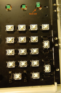

Here's the tenkey area showing stabilizer brackets and guides. I'm not sure how that LED got bent, but they must fit back into tiny lock-light slots shaped like the skinny ends of the LEDs... That took a bit of time 'n' patience.
100485-8

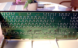

(I did get the plate quite clean, BTW, but this camera picks up every speck of dust!) PCB, as long as I was here:
100487-9
