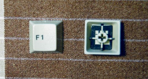

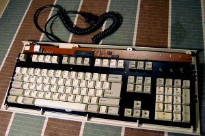

Hey guys,
I found a Monterey K101 in a thrift shop yesterday:
I thought it might have Alps switches, but when I removed a cap, I didn't recognize the switch type:
Do you know what they are? Something unremarkable, probably, but I checked a lot of photos and couldn't find anything like it.

Mitsumi Miniatures with MX mount, theyre quite nice actually. :)

Right you are... Here's a Deskthority page about a Chicony 5191 with some.
I really like these switches. They're very crisp, quick, tactile. Rather like Cherry browns... A bit more resistant, but they spring back very quickly. Fun to type on! The sound is like a toned-down Model M: clacky, but not in your face.
This doesn't look like it was ever used. There's some yellowing around the lower right corner (most noticeably the tenkey 0 and 1), but otherwise it could've just come out of the box.
Notice that the key between left Ctrl and Alt is blank; it doesn't generate anything. Wonder what was up with that?
BTW, I didn't remove the F11 keycap; it was missing. Anyone know where I can get a cap for a switch like that?

Weird about that blank key. I have an FK-8000 with the same exact layout, including that blank key. Wonder what it's purpose is supposed to be

I just found that Cherry caps fit these perfectly. Does anyone know where I could get an F11 with this profile?
UPDATE—This cap's dimensions are:
   Base: 18 x 18 mm; top: 10 x 12 mm; height: 10 mm

You'll find the switch here: Switch recognitionCherry MX mount recognition; obviously it helps to spot that they're Cherry MX mount in order to scour the correct category, as you'll soon see just how many switches there are. The photo on the wiki is of a loose switch, as that's all I have; an in-situ photo is preferable to show how it appears in a keyboard.
Blank keys are common: it's a low-cost approach to 101/102 key designs (ISO keyboards in Europe have one extra key) and even non-ANSI/ISO keyboards such as some Amigas still have a blank key in the US layout. You can see how the blank key is used on my K102:

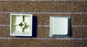

Hey guys,

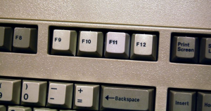

The nice people at WASD made me a replacement Cherry-mount F11 for my K101. The profile was a bit high—but fortunately, while the Mitsumi Miniature's mount is the same shape, its stem is shorter, so I was able to Dremel 2mm off of the keycap's channel to make it the right height. The color isn't an exact match, nor the printing (a bit of space after the F would've been nice), but it withstands a casual inspection:
100469-0
100471-1
I wiped the keys down with alcohol, but there wasn't a bit of grime on them—so even though it wasn't in a box, this KB doesn't seem to have been used.
100473-2
The keys turned out to be double-shot:
100475-3
...except for the F-keys and Esc, which are dye-subbed—however, the blank "macro" key (between L Ctrl and Alt) is double-shot, go figure!:

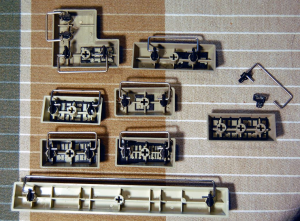

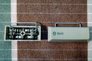

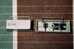

Lots of stabilizers, including two on the big-ass Enter, going different ways:
100479-5
Rather than using hooks molded into the keys' bottom edges, the stabilizers attach to the keys via separate little brackets that fit into the keys' extra channels.
I thought it was funny how L Shift was completely double-shot, but R Shift only half (maybe this is common?):
100481-6
100483-7

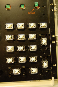

Here's the tenkey area showing stabilizer brackets and guides. I'm not sure how that LED got bent, but they must fit back into tiny lock-light slots shaped like the skinny ends of the LEDs... That took a bit of time 'n' patience.
100485-8

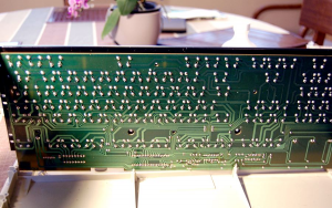

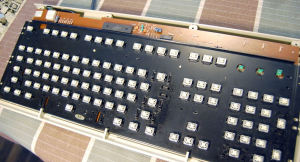

(I did get the plate quite clean, BTW, but this camera picks up every speck of dust!) PCB, as long as I was here:
100487-9
