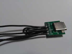

Just wanted to share my USB Type-C mod for a KC60. http://imgur.com/a/RtM45
175461-0

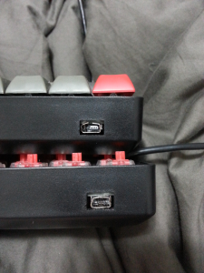

The problem: dropped my KC60 keyboard off the side of my bed too many times and the connector got all mangled up.
175477-1

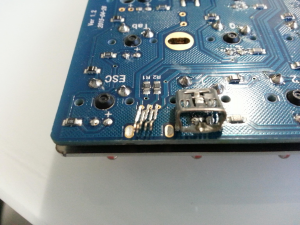

175479-2
Here is the housing disconnected from the board with the pins exposed.

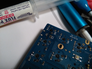

175467-3
Desoldered the pins from the board.
175469-4
Soldering wires onto the USB Type-C breakout board.

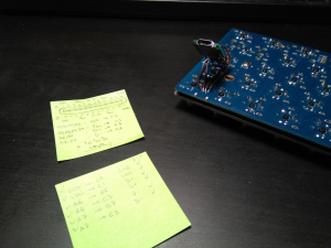

175471-5
Soldered the breakout board onto the main PCB board and put a little electric tape to insulate the housing. I used the post-its to keep track of which pins solder where, and testing results.

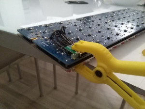

175473-6
Hot glue and clamp.

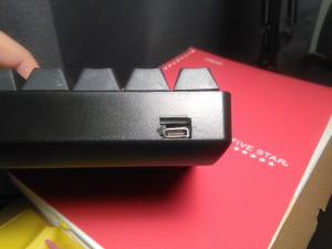

175475-7
The connector didn't lie flush so I had to file the hole a little larger.

Offline Dan
Re: My USB Type-C mod for KC60
« Reply #4 on: Thu, 10 August 2017, 02:02:01 »
I bought the breakout at fasttech here: https://www.fasttech.com/product/2412400-u3-206-smt-type-usb-3-1-type-c-female-socket
It was over a year ago since I bought them so you may be able to find them cheaper elsewhere.
For the pinout mapping, I only needed to check wikipedia (make sure to look at the receptacle images, not the plug end):
* USB-C pinout: https://en.wikipedia.org/wiki/USB-C#Connector_pinouts
* USB Mini B: https://en.wikipedia.org/wiki/USB#Host_and_device_interface_receptacles
From there, I drew up a little diagram of what should connect where. Notice how they're replicas of the images I found on wikipedia.
175459-0
The USB C breakout boards I bought didn't connect side A to side B, so I had to make some extra connections from one side to another (the loops you see in the images).
For example, as noted in the post-it image, A6 and B6 both had to be connected together, and also connect to pin 3 of the USB Mini B spot on the PCB board. On the post-it I used 'C' to denote the Mini USB B pins.
Hope this helps!
