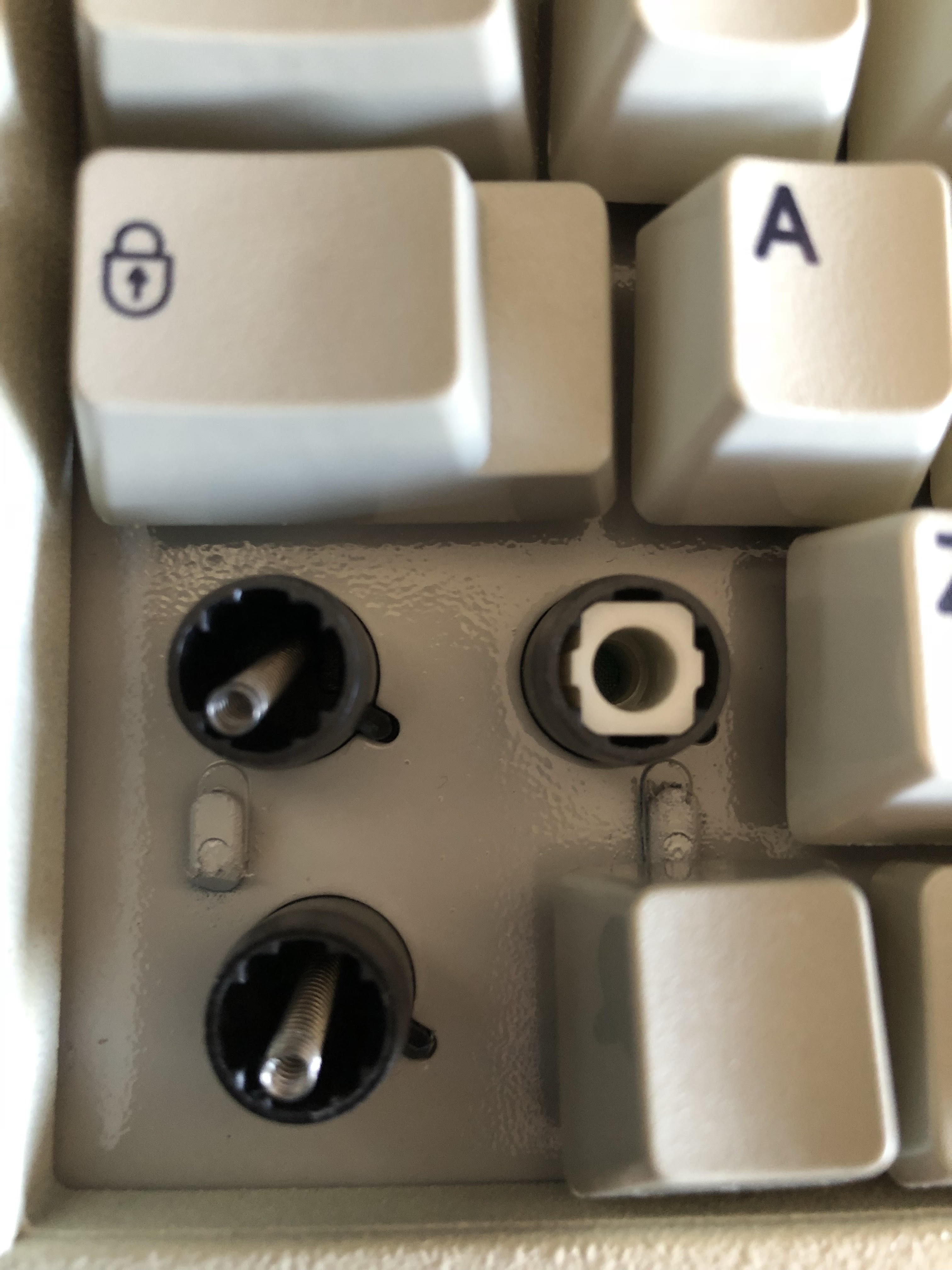

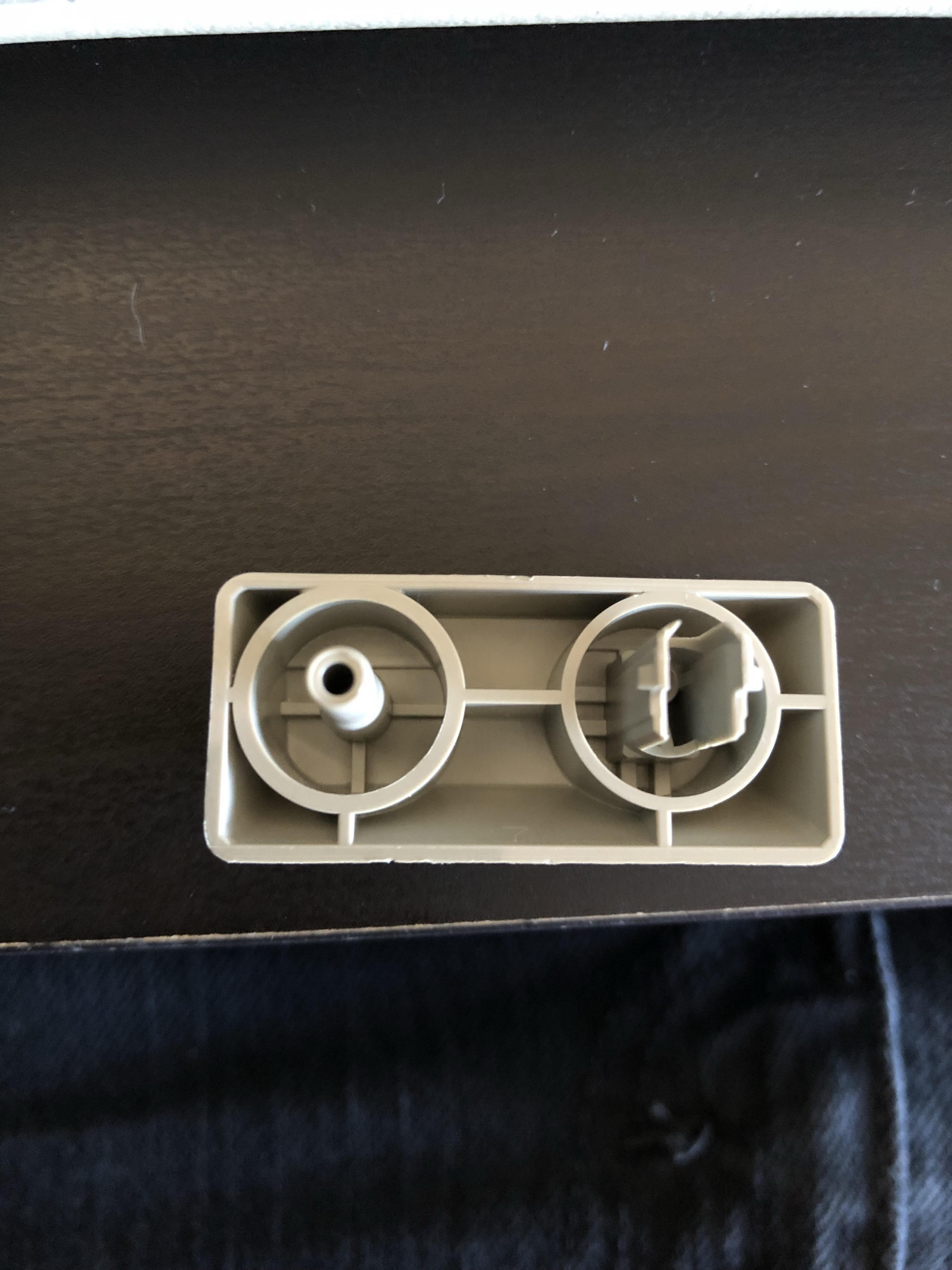

I turned my model F left shift from whatever it was before (1.5 width maybe?) to a standard Model M left shift key. I did this by taking out the barrel spring and flipper of the neighboring barrel and inserting the Model M stabilizer peg thing into that barrel. It works well if hit straight on but if I hit the key towards the outside or bottom corner there is too much resistance to press the key. Does anyone have any ideas on how to address this? Thanks!!

Re: Model F ANSI Mod Key Hard To Press
« Reply #1 on: Tue, 10 April 2018, 19:06:17 »
You either have the wrong stabilizer insert or you have it inserted incorrectly.  Look at it closely, they're not all symmetric.
« Reply #4 on: Tue, 10 April 2018, 19:19:51 »
Some of them have the hole centered, some have the hole offset, so rotating it will move where the hole is in the barrel.
The insert for the shift key should be a centered one.  I believe the vertical ones on a numpad are the ones that are offset.  I could be wrong.
Looking at your pic, does the hole seem offset a little to the left or is that a trick of the angle?  You might want to pull it, rotate it, try it again.

Ah thank you so much I thought they were all the same I just pulled them from my model m and inserted them randomly. Let me look into that.
