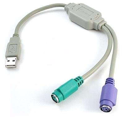

Tried two types of PS/2 adapters, those tiny converters that all they do is rewire the PS/2 wires to the USB and also tried the kind that have a circuit board in them and have two entries, one for PS/2 keyboard and another one for mouse.
None of them worked...

Turns out the problem I was having before was because of a faulty ps/2 to usb adapter.

The PS/2 adapter I'm using that works shows up on Linux as:
"Holtek Semiconductor, Inc. PS/2 keyboard + mouse controller"
It looks like this in lsusb:

It looks like this in real life:
Its sold under too many names and brands.
I'd like to thank you all for your help!
