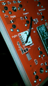

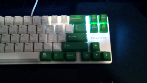

This is a pretty simple hack.
If you want to control the lights, you can put a switch in the middle of the jumper wire, otherwise, with this method the lights will always be on so long as there is power to the keyboard. If you use a powered hub, the lights will remain on even if the computer is off. This is because the traces that go to the controller are not fully populated and without consulting an electronics expert (not me) and maybe using a scope, you probably won't get that working, and that is if it's even built into the controller at all.
All you simply (HA!) need to do is add resistors and LEDs, and then jumper (wire) the ground bypassing the controller.
Here it is partially finished, I was just making sure it works, I'll be doing the rest this weekend.

Open the keyboard, there is one screw under each pad and two under the small stickers at top and bottom in the middle. There is nothing under the large label.
First add your jumper wire, this needs to go from the connector over to a pad on the pcb as shown. Ignore the crappy joints, I was tacking things.

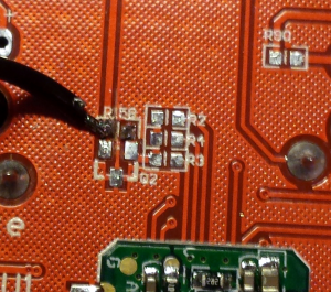

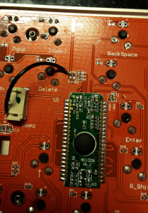

Close ups:
128882-2
128884-3
Now add your resistors and LEDs.
LEDs need to be installed with the long leg in the + hole, I recommend bending them out 45 degrees after going in to hold them in pace while you solder. Make sure they are in all the way, I had one I had to redo because it hit the keycap.
Resistors are super tiny, but they are not as bad or time consuming to do as you think once you get a rhythm going.
I add a teeny dab of fresh solder to one pad (I did both, bad idea) then while holding the resistor in place with tweezers, melt it down. Now go add solder to the other side.

Hi Leslieann! I've got this same board on the way and was considering adding LEDs to it as well. I just found your post and noticed that it kind of ends abruptly. Could you post some followup pictures of how it turned out? Also, I get where the LEDs get soldered to but I don't know where the surface mount resistors go. I also plan on adding a switch, possibly a potentiometer, to control them. Any additional help would be greatly appreciated!
EDIT: Looking at your pictures more closely, I'm thinking the resistors go where the "R##" is printed?

I don't know how this board's wired to be sure but 100ohm is a low value resistor for a keyboard LED and it sounds like Leslieann is using a powered USB hub so she may have more power available than a standard USB port can provide.  Not saying it won't work but I wouldn't go buying anything until she confirms it works for the whole board as if it draws too much power your computer will complain and disable it.
You're right though - R## are where the resistors go :)
Sorry, I should have posted that.
Yes, that is where they go, you can follow the traces back from the LEDs. Beware, there are places where extras go, and if you populate them, who knows what will happen.

Hey! Trying to do the same thing with my unbacklit boards. Tried just one led with a 100Ohm & 1k Ohm resistor. With 100Ohm it is really bright, with 1k resistor its significantly dimmer but not bad.
Instead of jumping from the connector, which means LED are always ON. Someone suggested a transistor that might allow for us to use the built in dimming feature, but Im not sure which transistor to try.
If someone has PCB pics of the backlit Magicforce, they would be really helpful.
EDIT: Found a pic, http://i.imgur.com/6SQsn5Z.jpg  (Still would appreciate a better one though)
Looks like the backlit version uses 1.2k Ohm resistors, I might just go with 1k then

The only this g the throws me off about the inbuilt controls for the backlighting is that the OCBs are different between the backlight and non backlight boards.
The backlight boards have the controller on the PCB SMD style. The non backlight has it in another separate green PCB that is soldered with pins to the main red PCB. The non backlight also lacks the DIP switches, while they have nothing to do with the LEDs the board is not just missing the switch but does not have the traces or through holes for it at all. So I am wondering if they have go that far to change the PCB whether the controller on the non backlight version even has the controls for the backlighting on/off or brightness.
I am very close to getting this project started myself and I have just planed to drill a small hole on the left side of the case and put a toggle switch through hooked up to the jumper wire to work the on off. Though if you could find more information about adding all the other parts to the non backlight board and seeing if it would come to life that would be really cool.
On the resistor side. I have a strip of 100Ohm SMD resistors after reading the initial post, so I will be using them, they were only a dollar or so though so if some thing like 300 or 500 would be more appropriate I would go get them before I start.
Has there been any more progress on the OP board?
EDIT: Iasked for some more pictures of the backlight PCB to see f there was some more info to be gained, I got back these so far but not sure if they are of enough help.
http://i.imgur.com/KtbZHZX.jpg
http://i.imgur.com/B7KbqCm.jpg
More EDIT: I took a look on the inside after i had though about the caps lock key having a resistor on the non backlight version and wanted to see what value it was. The resistor on the caps lock for the non backlight board is marked 472 which decodes to 4.7kOhm, so good and high. It is kind of dim but not very, this has me wondering just how bright the 100ohm LEDs will be. Maybe I should grab some 1k just in case I don't want to have to redo SMD stuff.
The other thing that interested me is that CapsLock seems to have two positions for Resistors on the LED. Would one be for the on/off when pressed and the other for just permanent on like all the other keys?
The other thing is looking at other pictures of the backlight version is that it has diodes all over the board but no fore ever single switch, though there could be some more on the other side too for what ever reason but unlikely. Incontrast the non backlight version does not seem to have these diodes.
