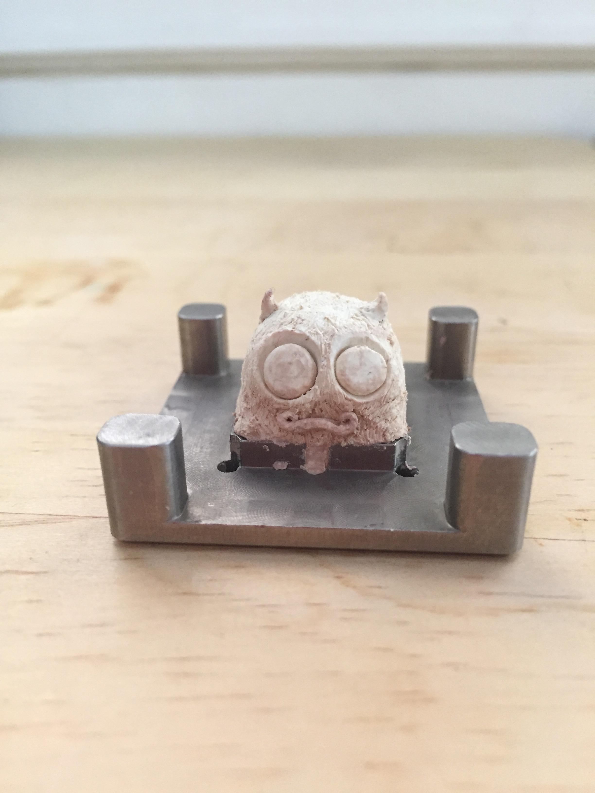

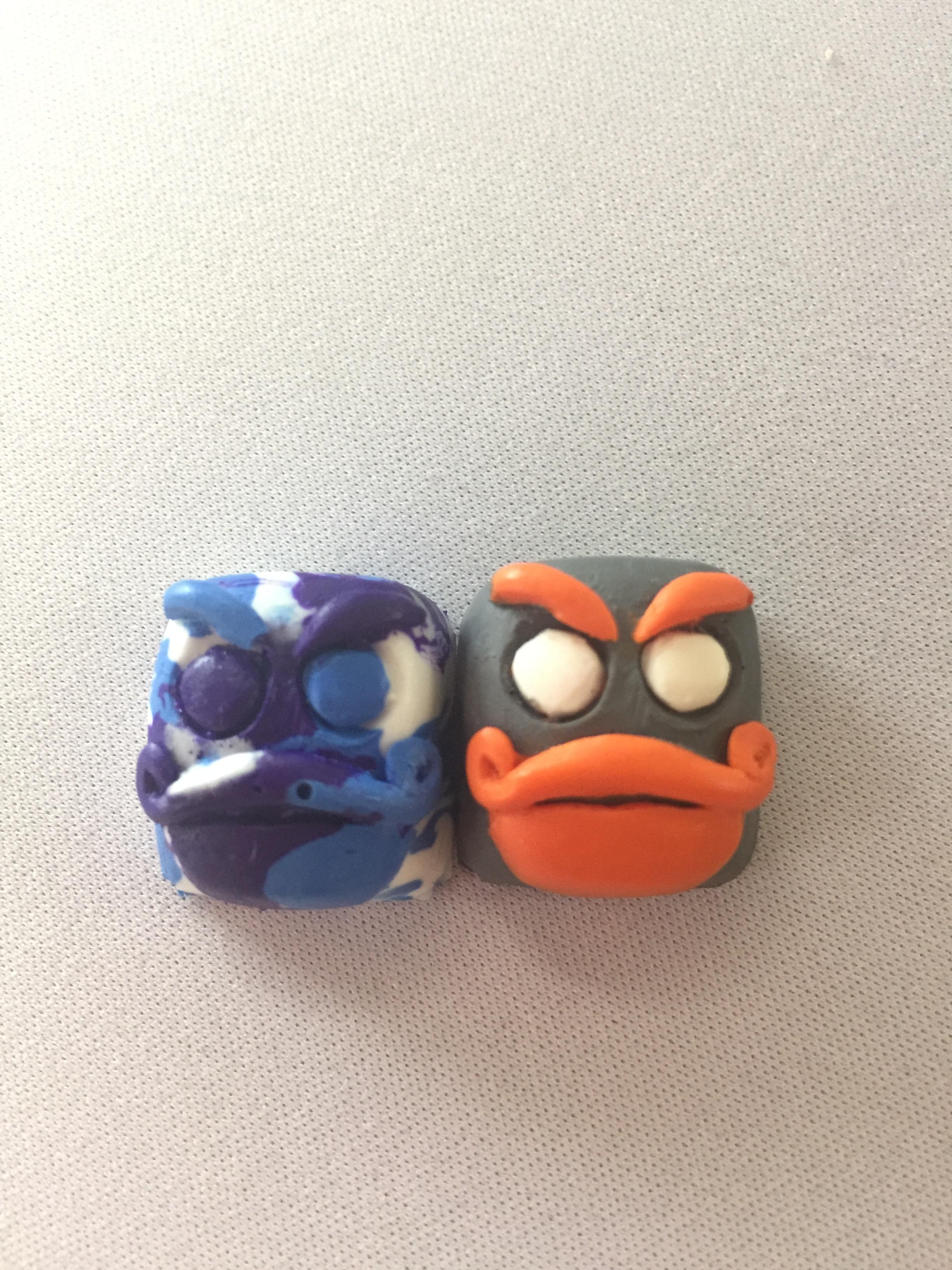

In the beginning of my creations I was using simple designs, things that looked very cartoonish and were generally very easy to make. These can be seen here
163002-0
163004-1

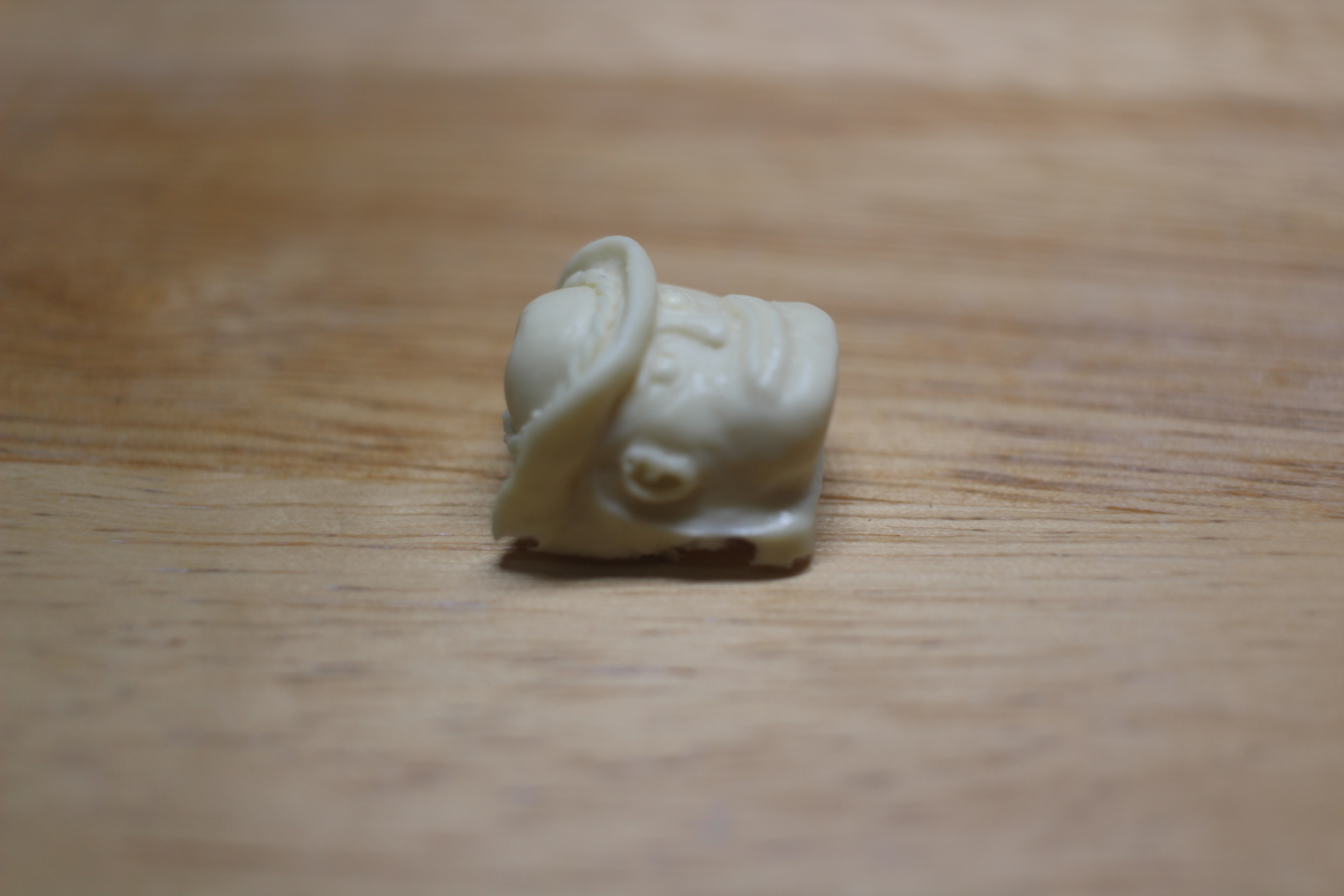

These two sculpts were done using Super Sculpey. Super sculpey is a good starting point, but i personally found a bunch of faults with it for projects this small and for my ability. I was having a ton of trouble adding small details for a few reason. One being that whenever I went to add detail my large hands would inevitably hit something and smoosh it, two being because of how soft it is whenever I tried adding detail I would end up pushing sculpey away to other areas instead of removing a tiny bit, and three I liked to build up my work. By that I mean I like to build a base, sculpt some of the harder parts, bake it so the harder parts couldn't be messed up, then add the easier parts/details and rebake to finish it. The problem with super sculpey is this is very hard to do, the new sculpey does not take well to the baked sculpey and I found pieces would fall off when I was working on them and I'd have to glue them on for them to stay. This became very tedious and annoying. The result was I continued doing easier sculpts like picture Two so that I wouldn't have to deal with this as much.
But then I heard of Cx5! I saw Binge talking about this and decided I had to check it out.  After watching some videos I ordered some and gave it a shot. Let me just tell you this stuff is amazing.  I now feel like I'm actually able to add fine details, I work on certain areas without worrying about smooshing details I added in other places. This leads to me being less frustrated and having more fun.  Another great thing is the ability to build up.  Cx5 is hard at room temps, and begins to liquify when you heat it, this allows me to begin sculpting add some fine details when its a little cooler, then very lightly heat it and add some more Cx5 to continue without fear of the new piece ever falling off since as it cools they form back together. Due to Cx5 being liquid when hot you can also use it to paint on a sculpture, and use it to test cast a new sculpt to see how good the mold actually is and if theres anything you need to change before using resin. Then just melt it all down if you want to start all over again.  Overall it was a godsend and lead to what you see below...

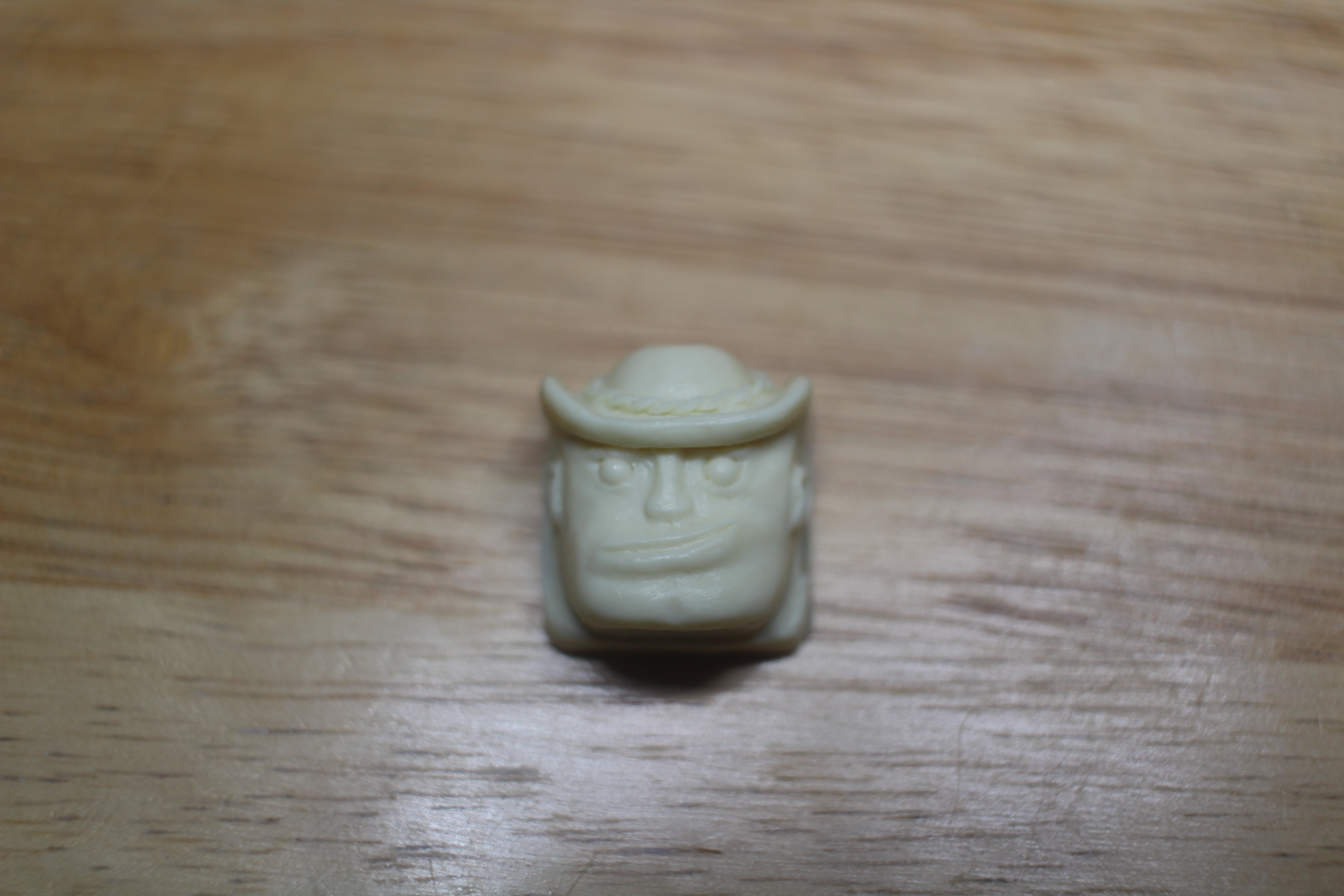

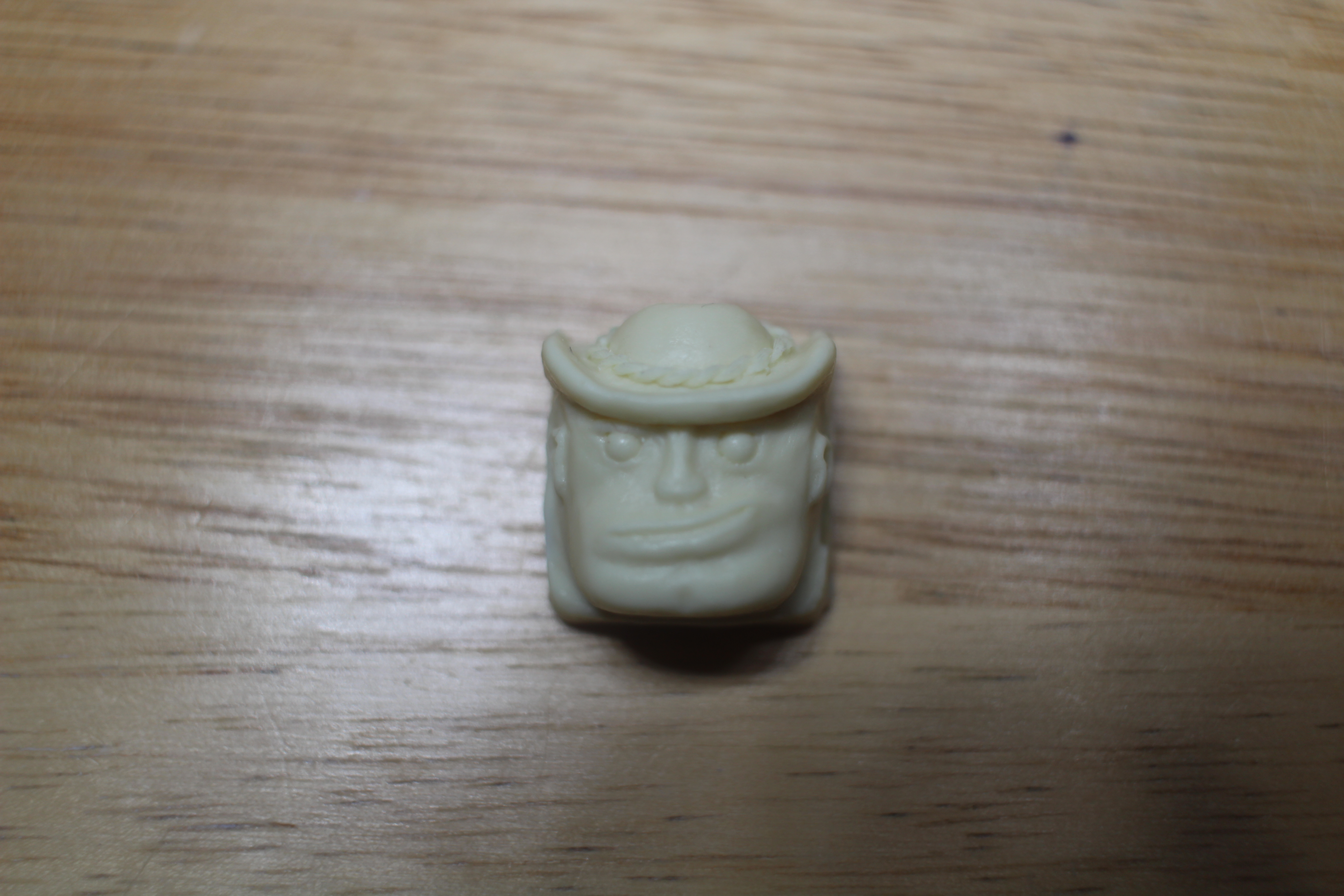

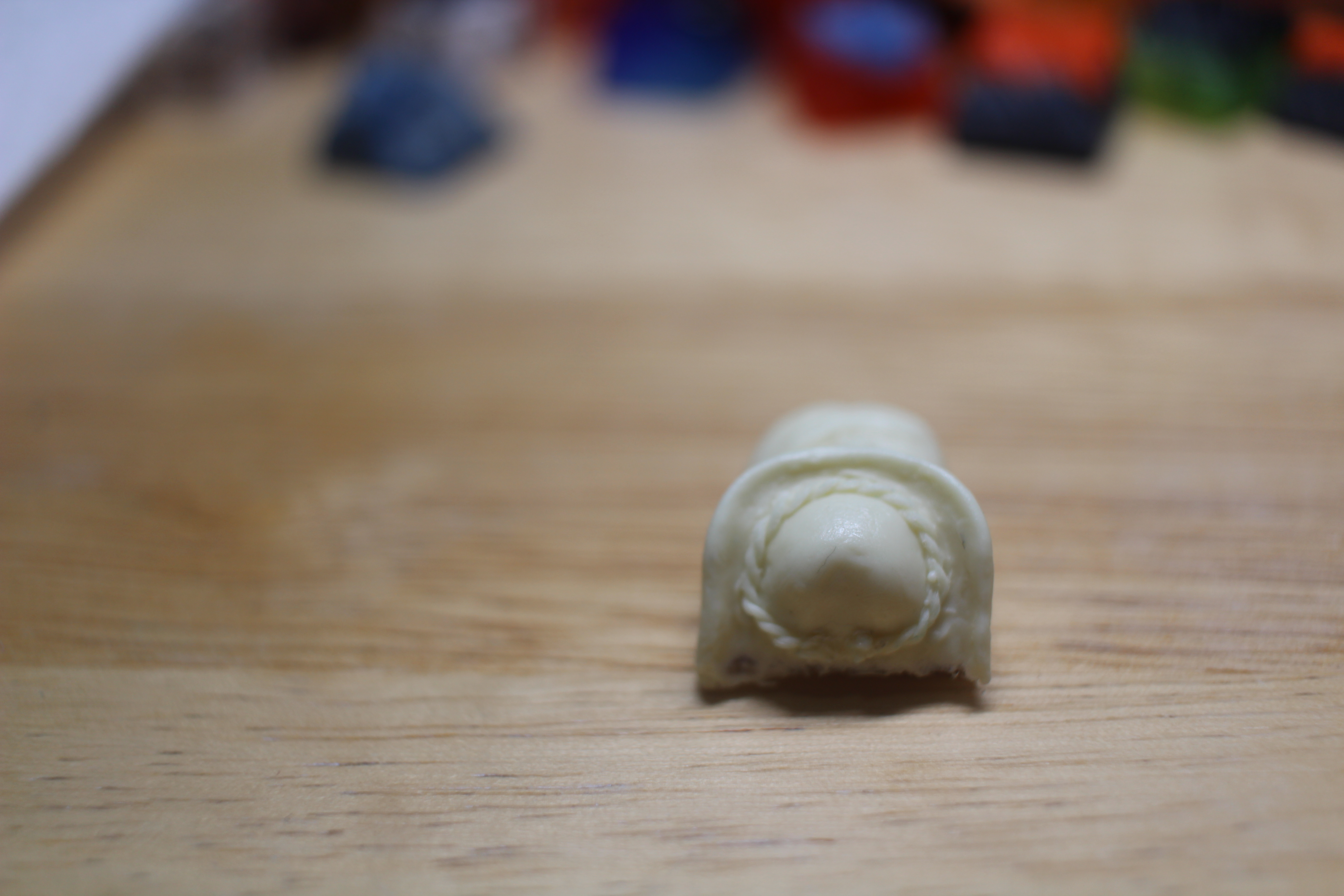

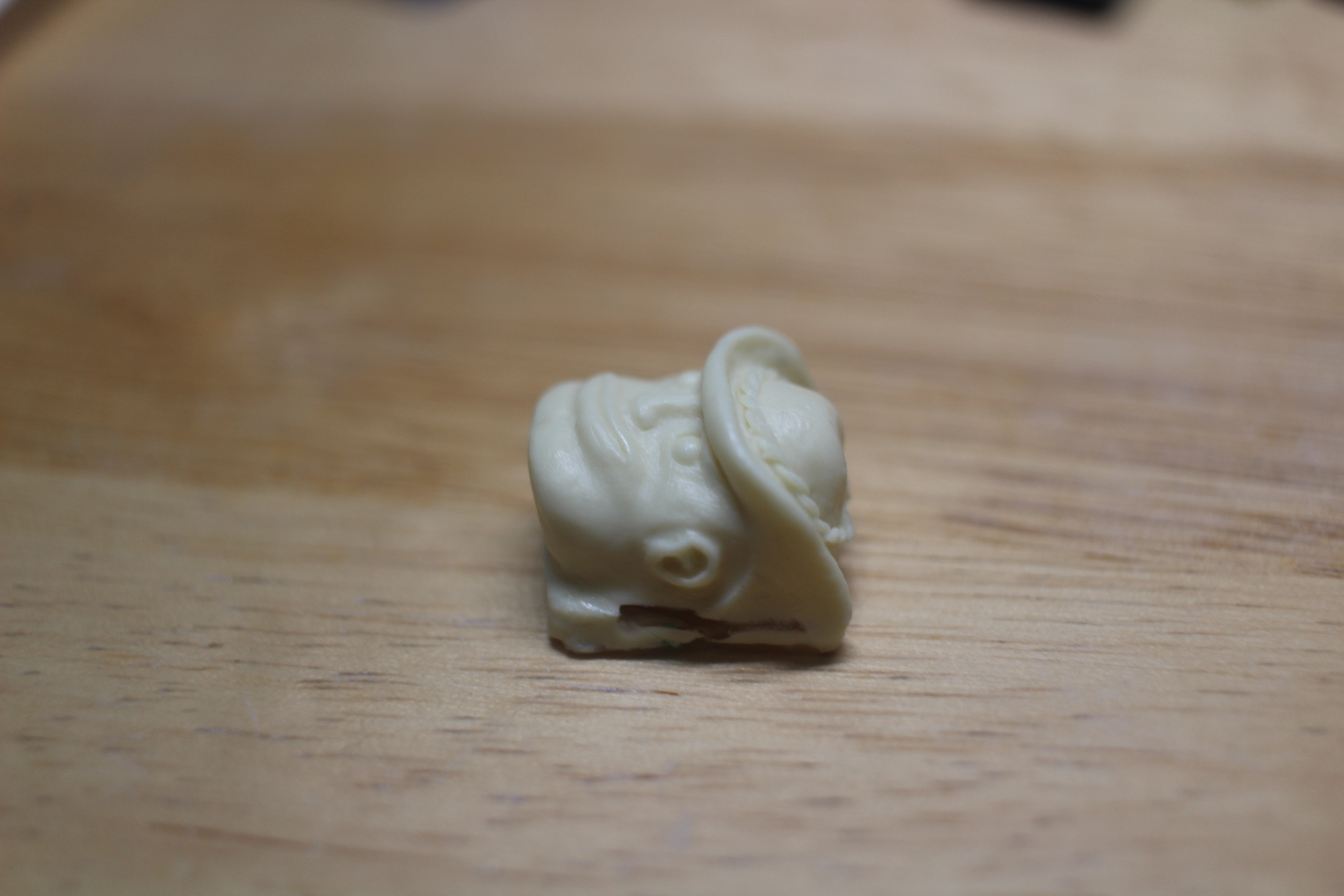

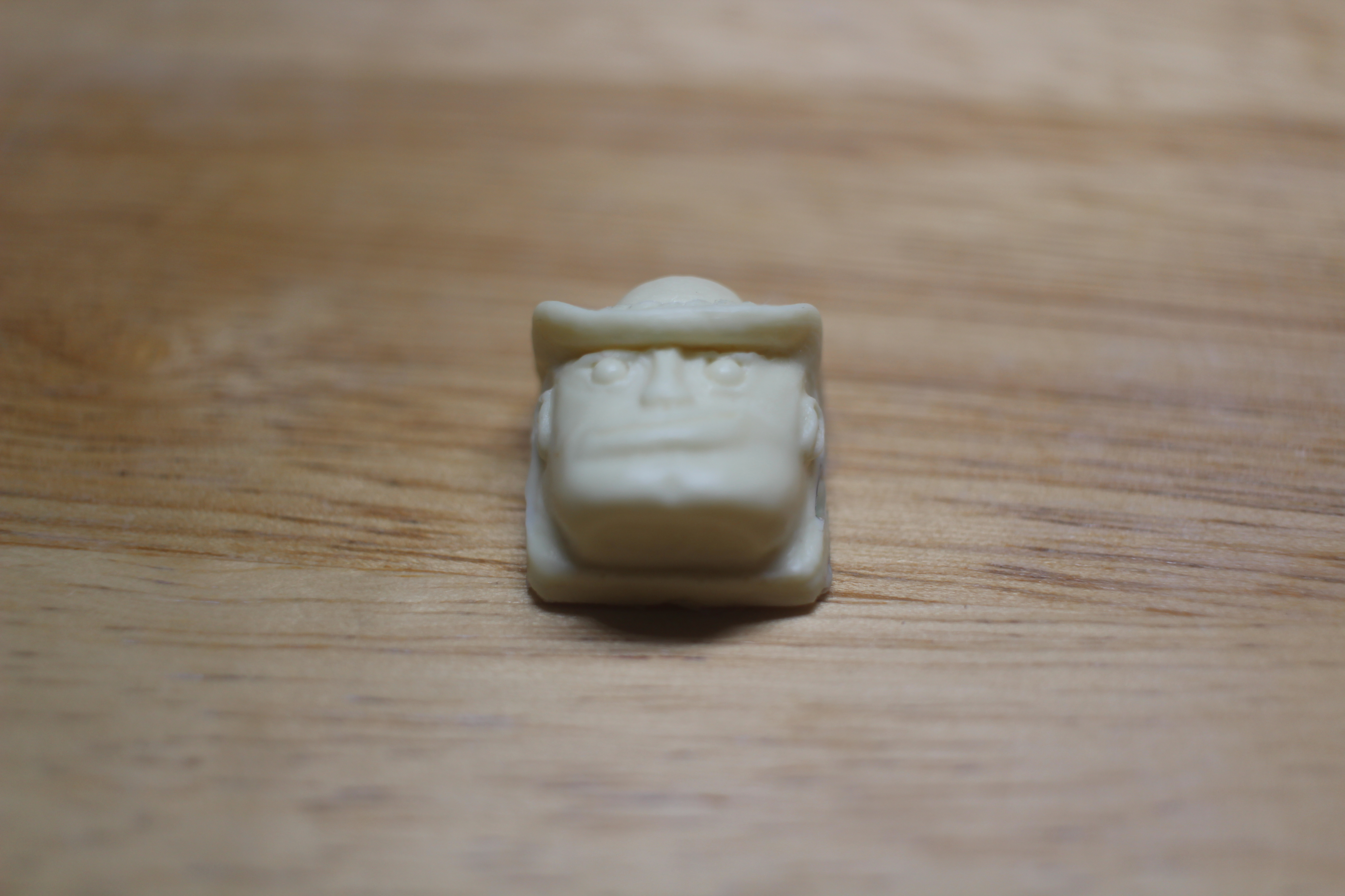

The Cowboy Henchman *name is pending ;-) .
Getting a cowboy hat to actually work on a small keycap was a huge challenge for me and I had to redo it a bunch of times. I still have yet to test the fit but it seems to be within the parameters of the synth so it should work just fine.
163006-2
163008-3
163010-4
I still have a little ways to go with him, he is definitely more detailed then you can make out in the pictures though. I need to add some adjustments to his nose and then may add a little more details in some other areas. But I definitely can see a very big jump from what I was doing with super sculpey to what I only started to do with Cx5.  This was done with a mix of Cx5s (mostly) and a little Cx5h . The plan is to make a mold, cast it with all Cx5h, then add some finer details and be done.  But unfortunately that is where the hard part begins for me.

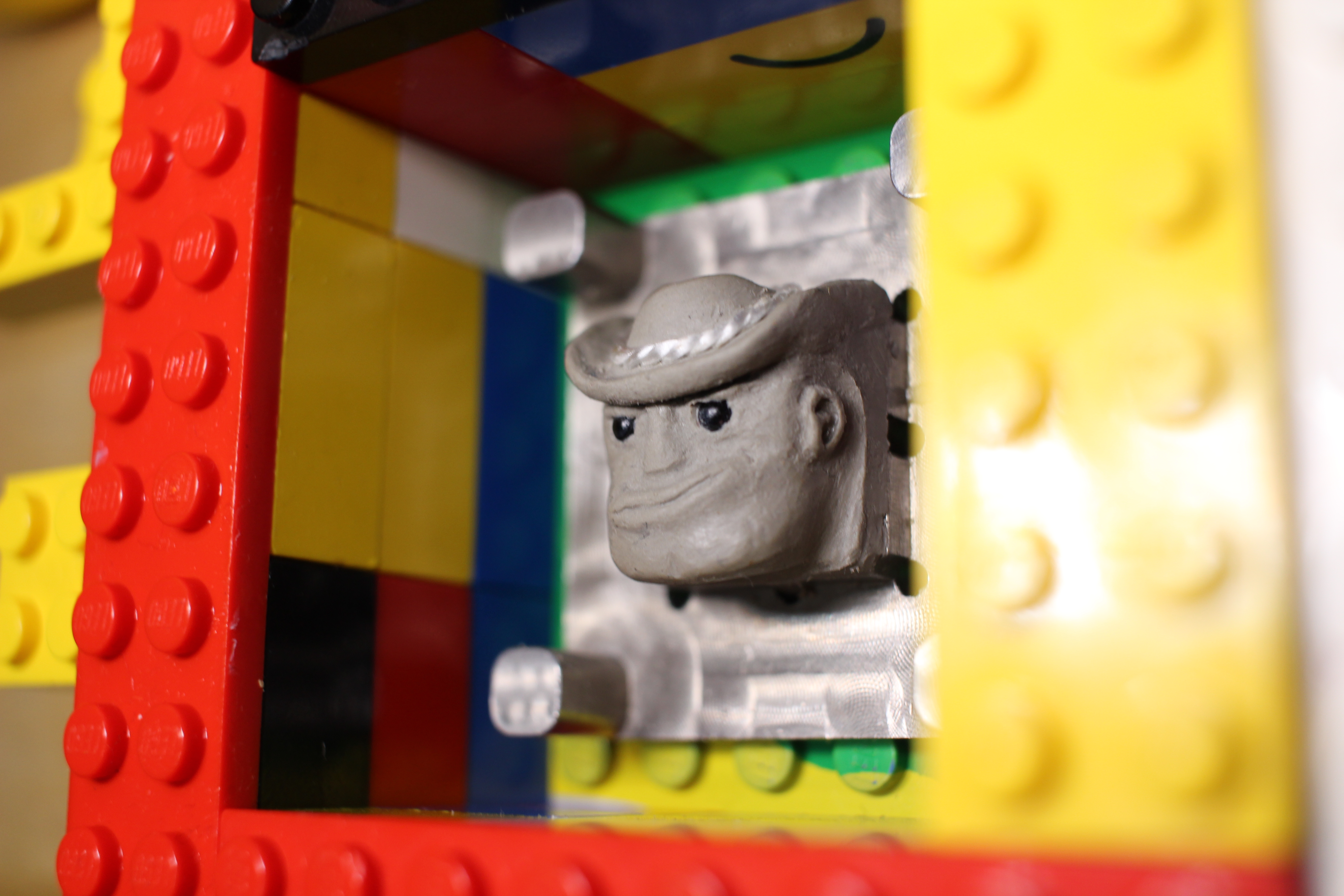

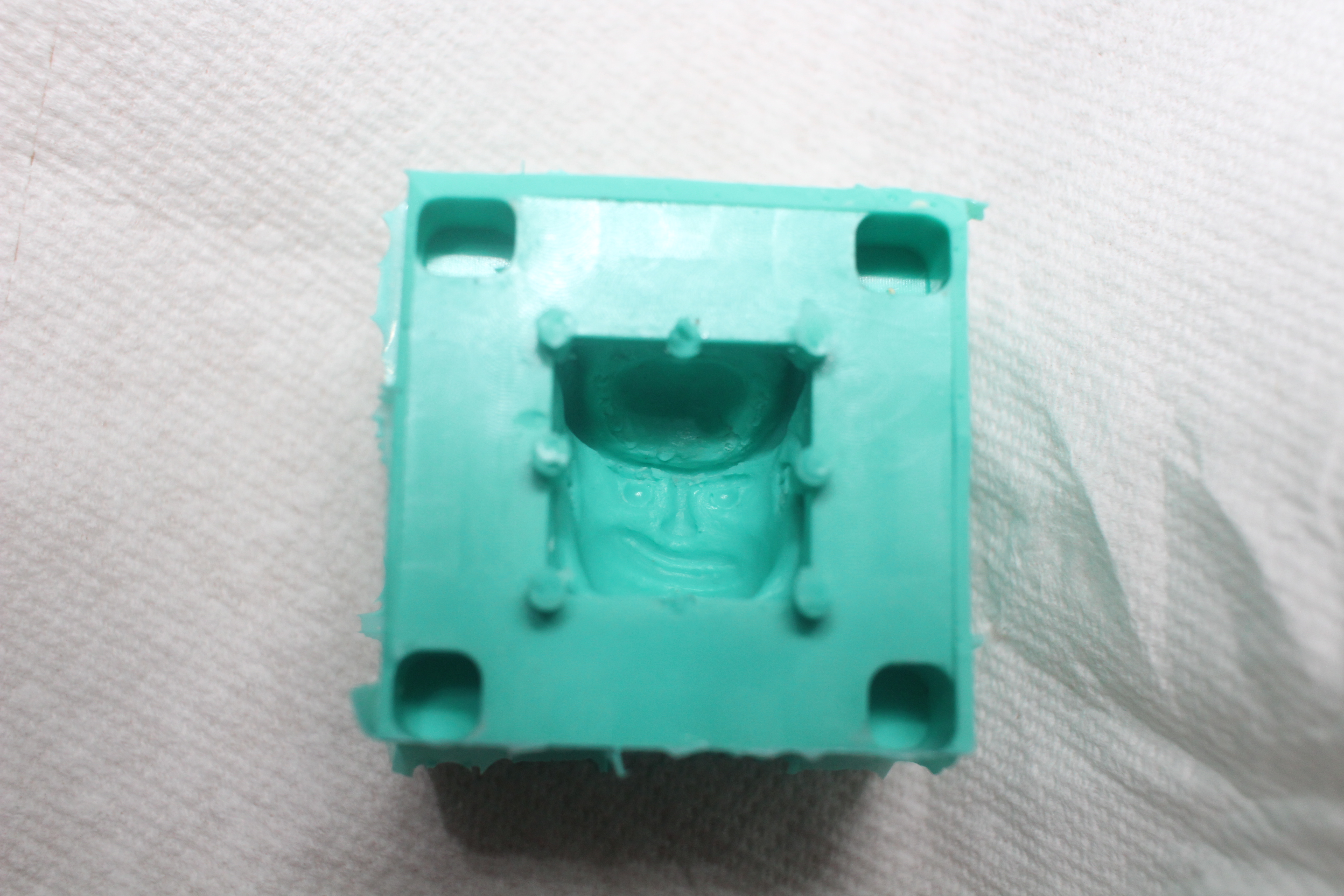

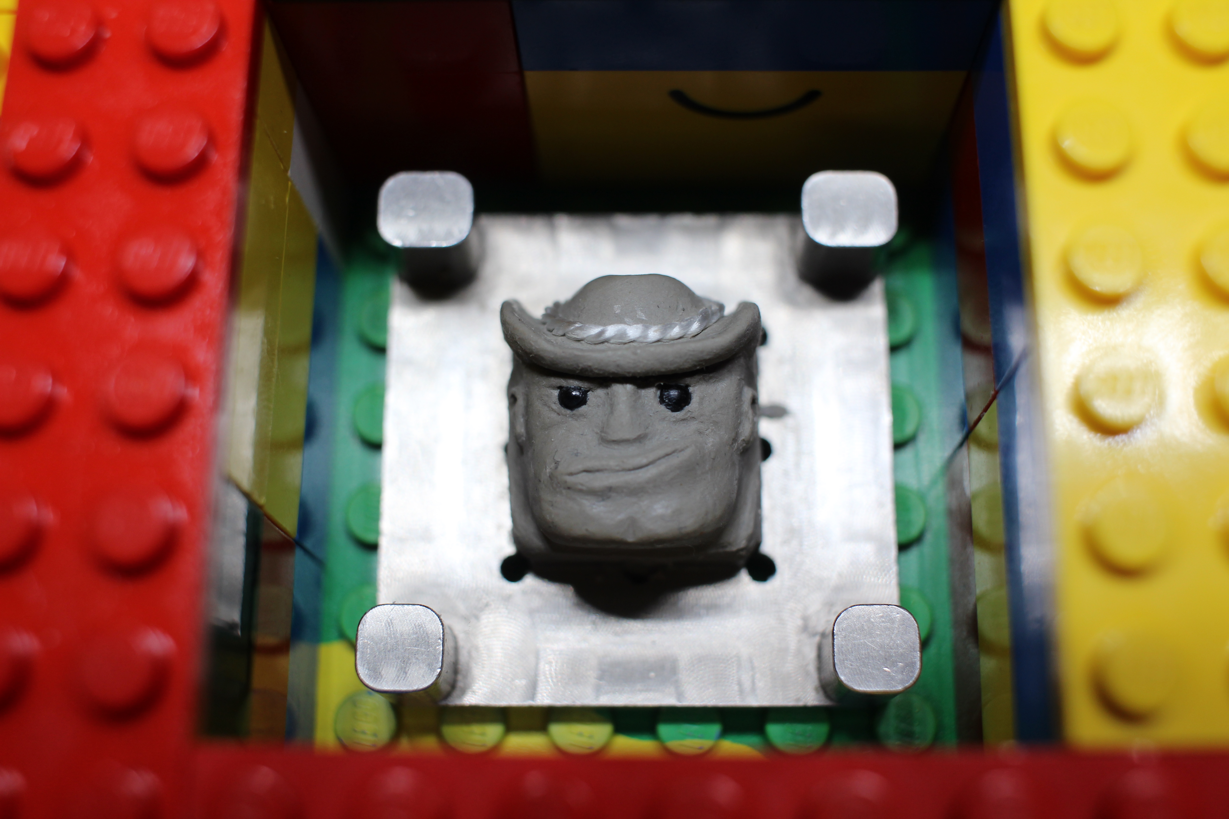

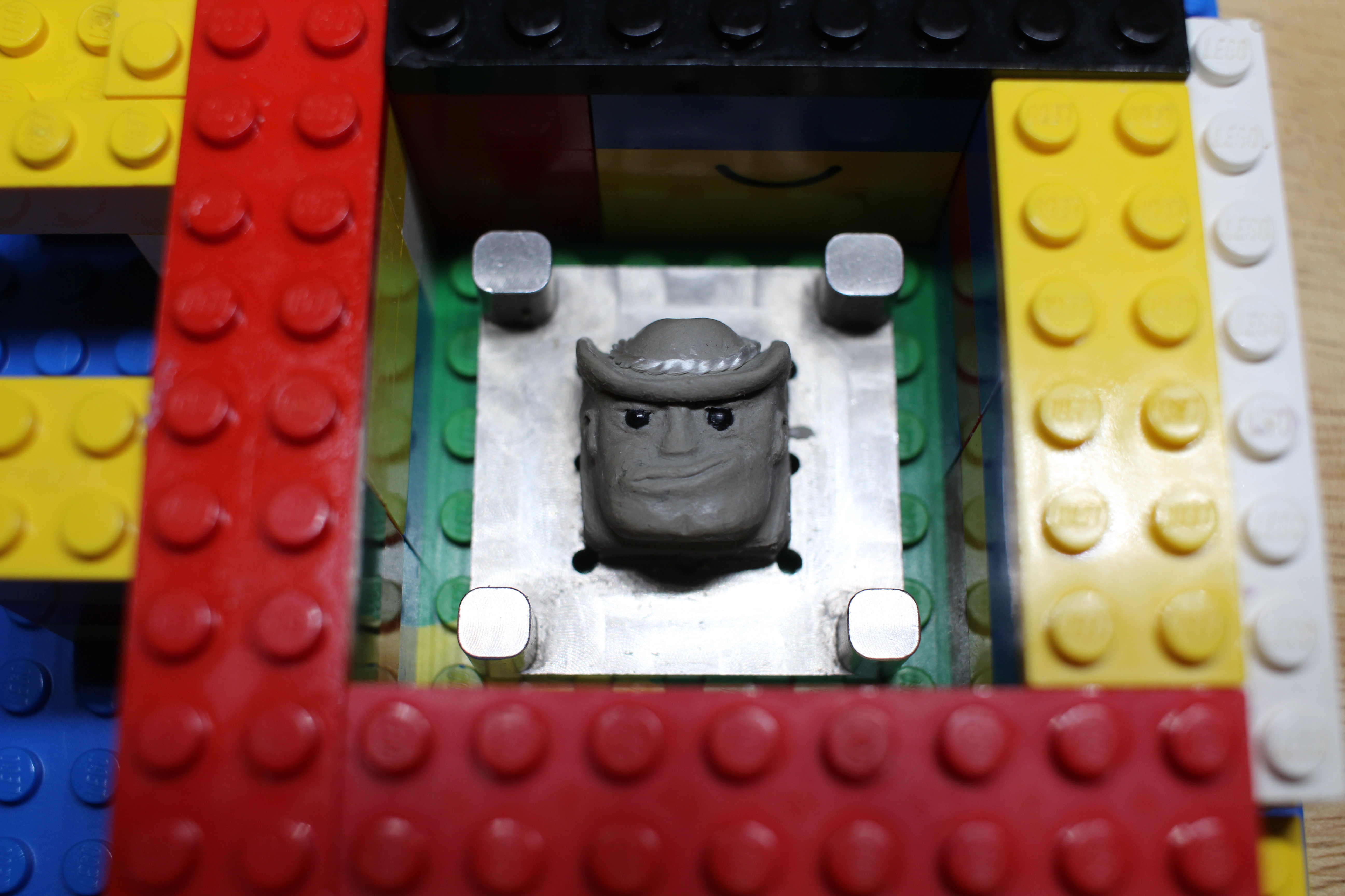

What I've been up to in the Silicone department:
After getting the new silicone in I immediately learned how much weather can affect things. I tried making a silicone mold in my basement which is generally 10 degrees F colder, and more humid then the rest of my house. This turned out horribly. The mold never fully cured and stayed way to pliable and extremely sticky. Not only that but it ended up cracking my Sculpt. Thankfully the crack wasnt directly across the face and it only cracked off some of the sides and the bottom of the chin. I was able to fix it thankfully.
My second attempt was also a failure. DONT RUSH YOURSELF. IF YOU NEED TO RUSH DONT ATTEMPT A CAST. My second attempt I was in a rush for work and wanted to get a mold made before work so that by the time I was home and went to bed Id wake up to a finished mold. Well I completely forget all the techniques I usually do and just poured it fast. I didnt take the time to first paint the silicone onto the sculpt and get it in all the crevices, and I didnt have a high enough pour. The new mold was WAYYY to bubbly to work. BUT the sculpt was unharmed.
My third attempt. Another failure. I did everything that I normally do but it wasnt meant to be. I use a piece of string superglued to the hat to get those rivets on top of the hat, until now its held up. But when I pulled the sculpt out of this mold it was gone, nowhere to be found. The reaction must of melted the glue and pulled it into the silicone somewhere, Idk. but there wasnt any huge bubbles! So it can be a backup in case I ever break my master and need a new one to work from.

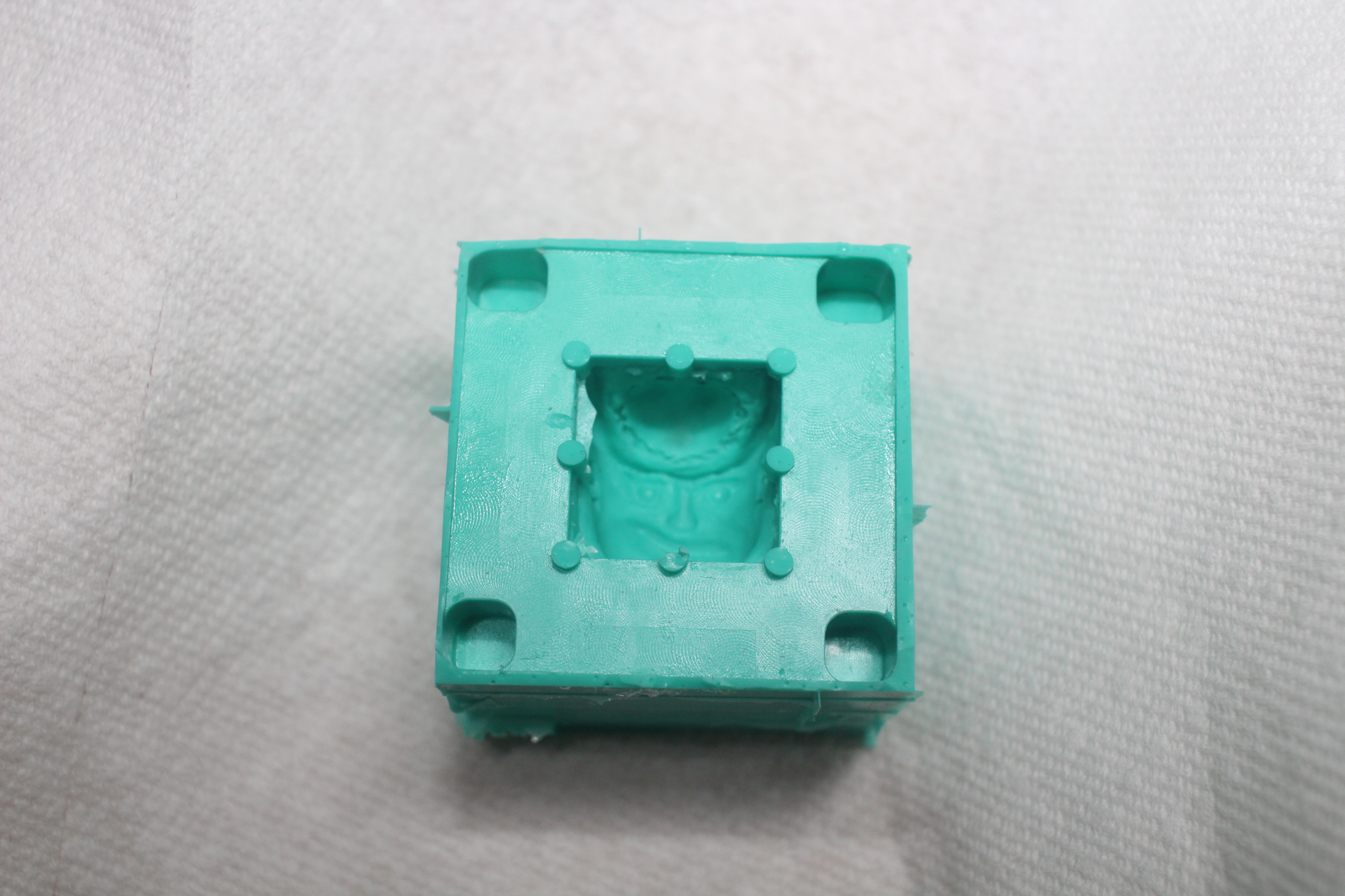

My fourth attempt. FINALLY IT WORKS. Got a bubble free first mold done and I was really excited. I was very worried the sculpt was going to break before I could get a successful mold and then I'd be **** out of luck. But it finally worked out for me. heres some pictures of the molds I kept and didnt throw out!
Back up mold
165628-5
Mold I will be moving forward with
165630-6

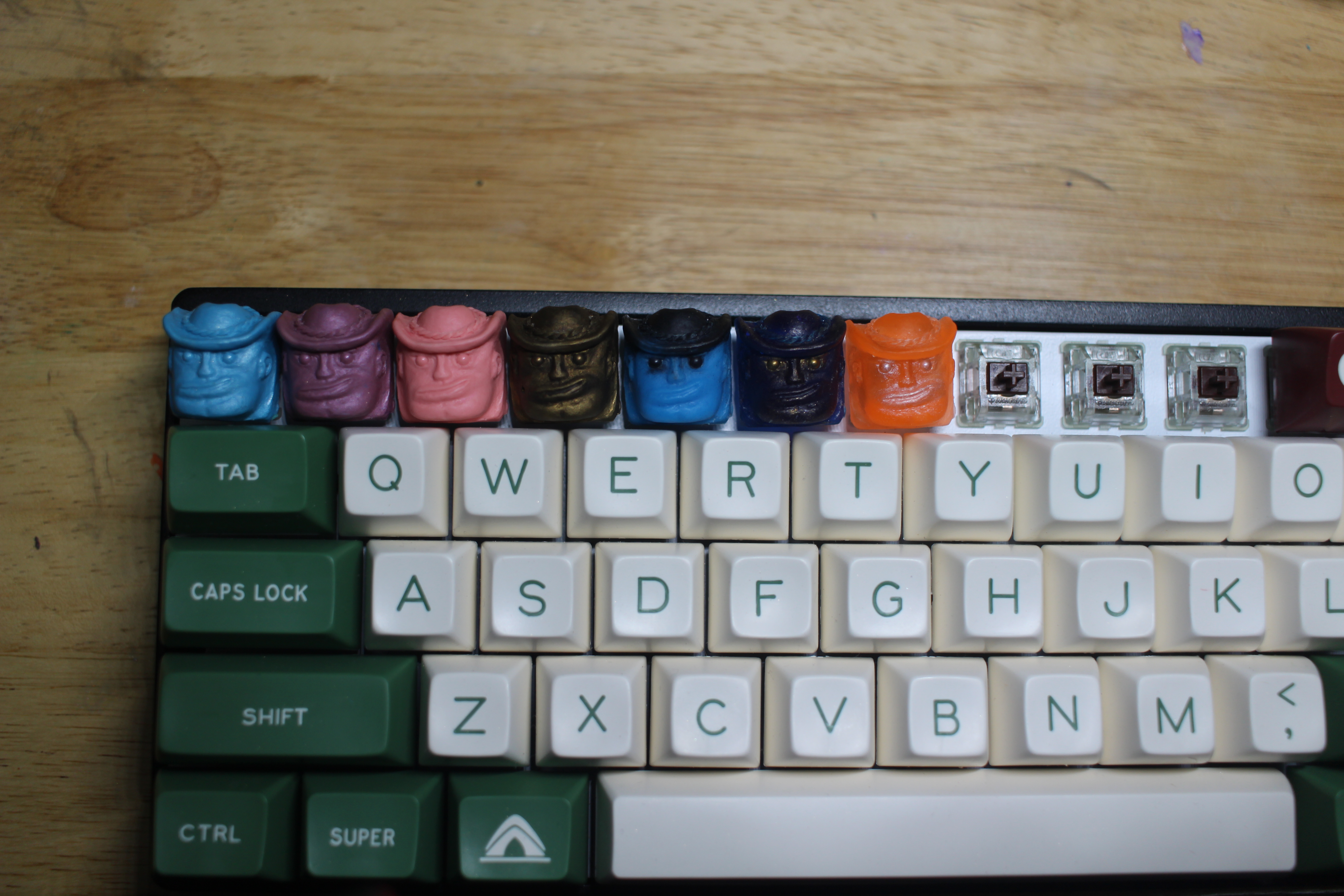

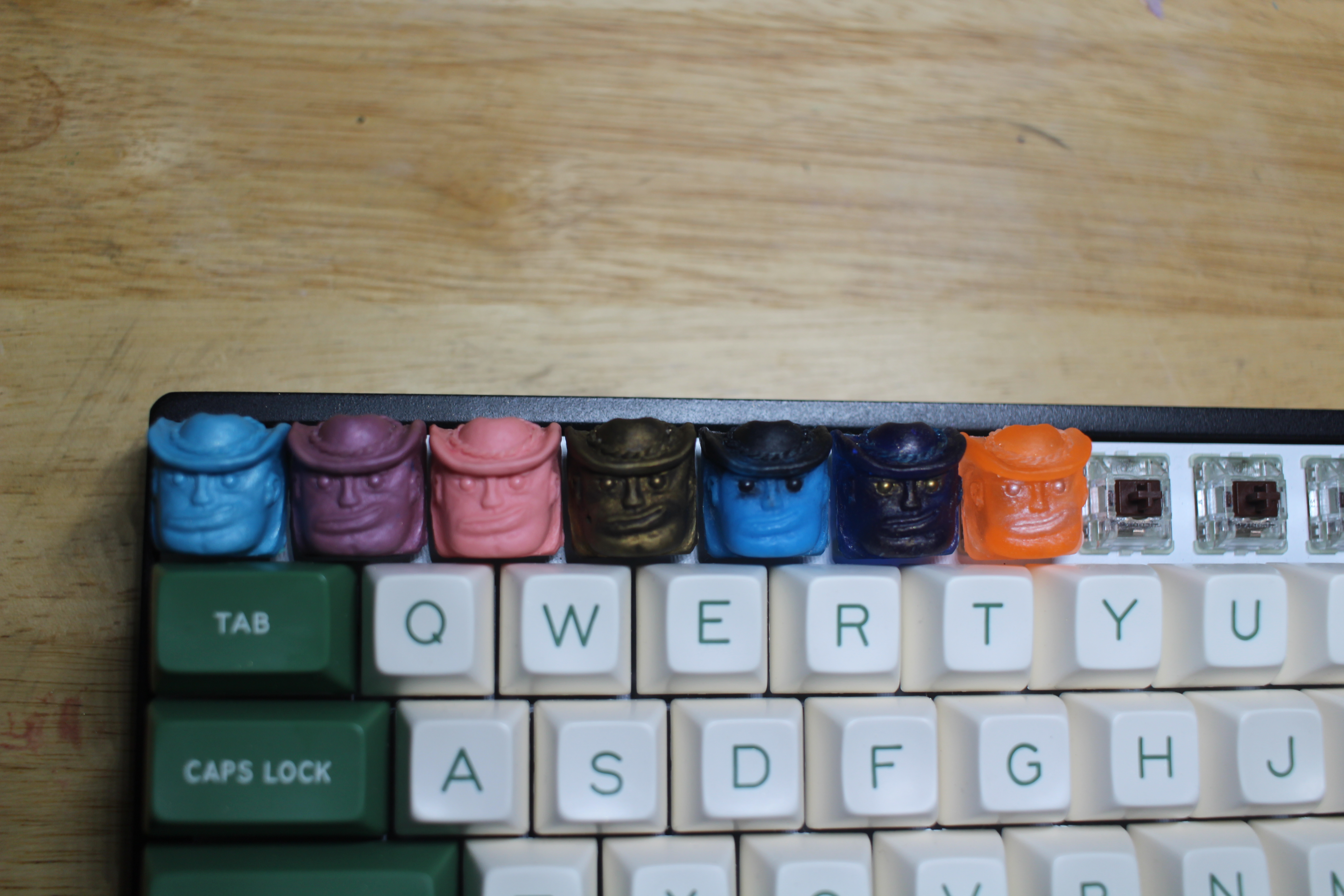

Good news! My pressure pot and air compressor came, i need to test it, but I should be bubble free within a week!. I also finally found some colorant that I actually like, and some metallic powder I like to spruce things up. Unfortunately the metallic powder broke in the box and was all over it when it arrived, but the customer service was great and theyre sending me a new one along with two small sizes of colorant free!

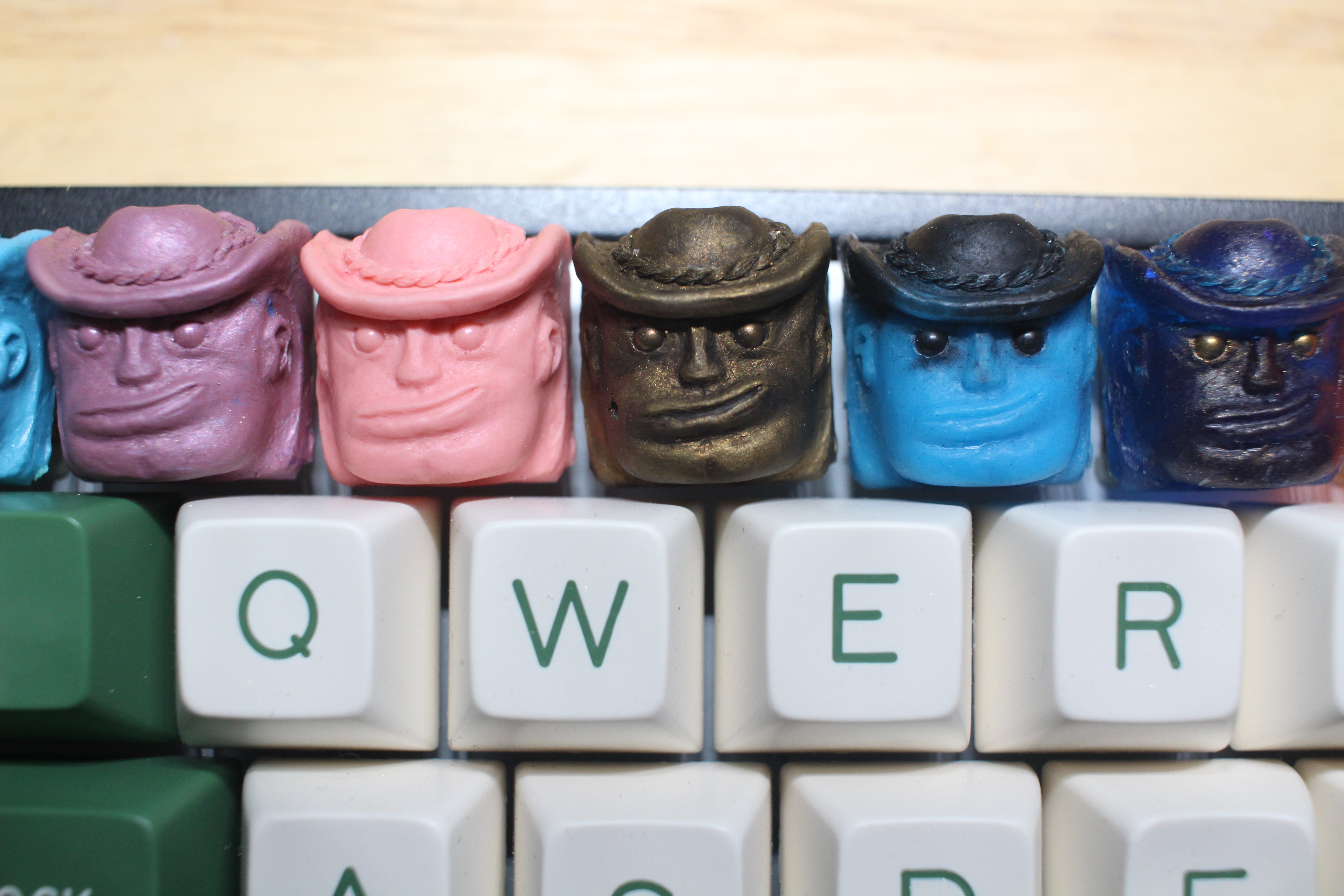

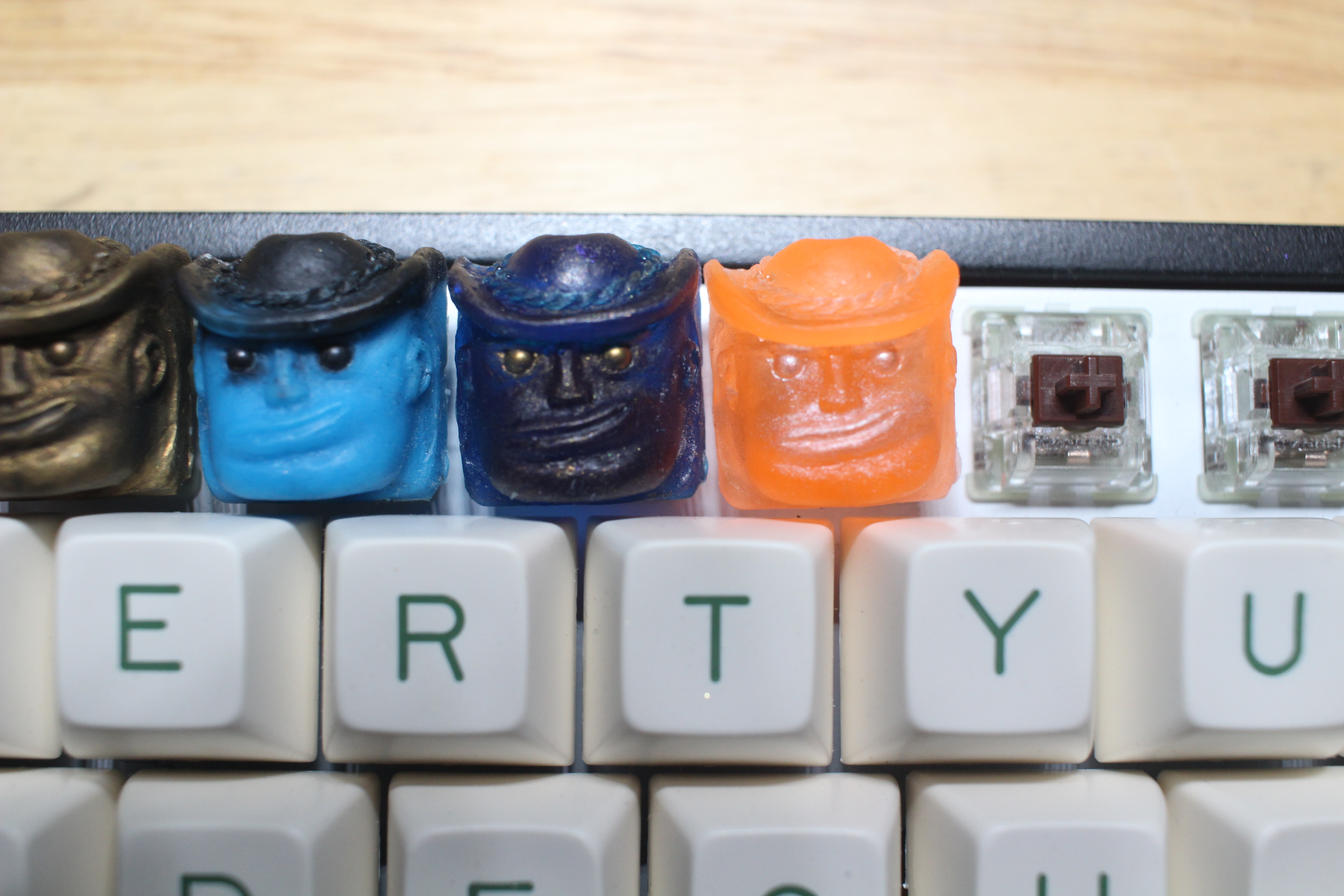

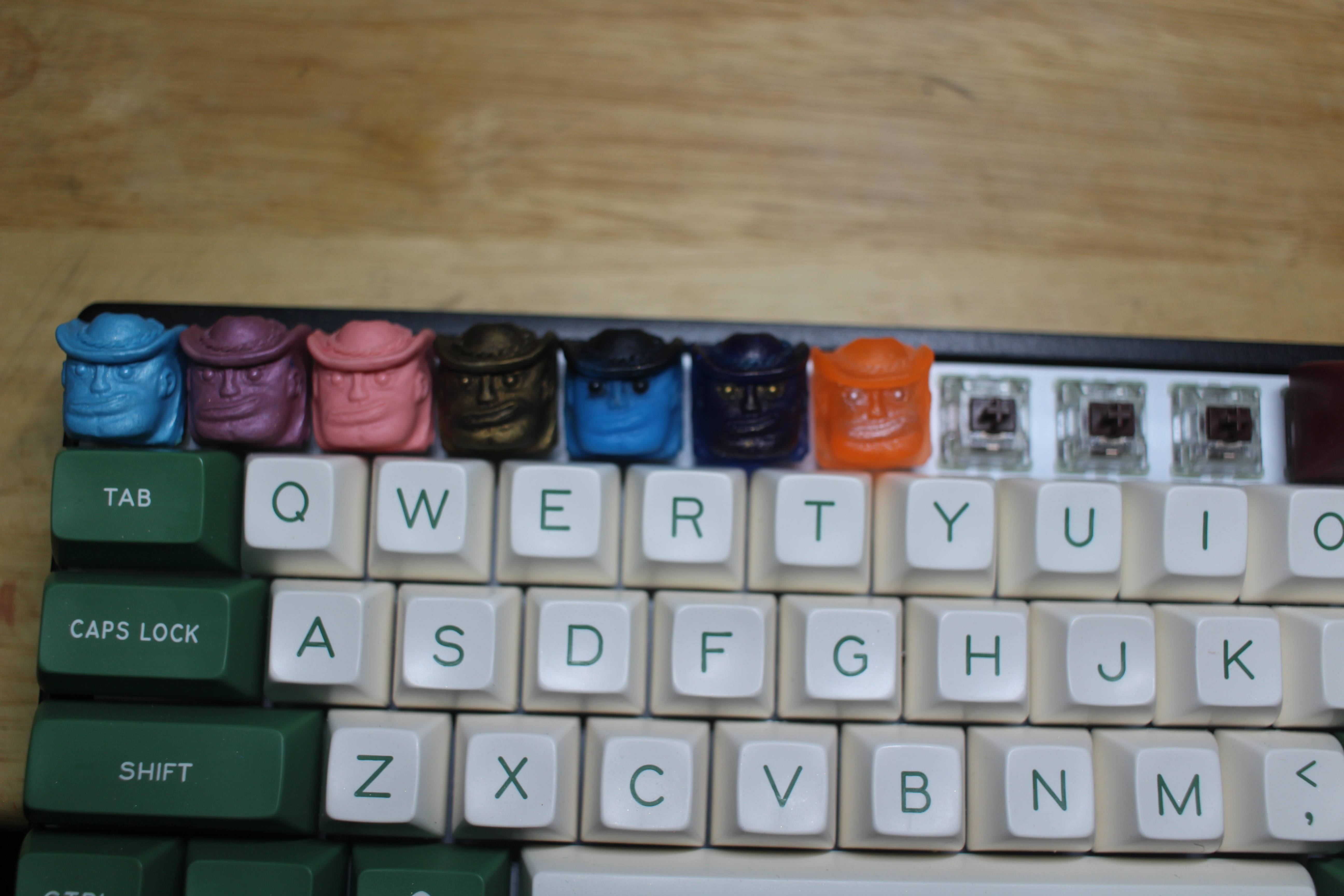

Bad news.... While waiting for the pressure pot and air compressor I did a lot of test casting. I am very happy with the profile of the KeyBoy, he sits just lower then an SA R3 has enough clearnace on all sides to be used anywhere on your board (at least with my 60% and ergodox that ive tested it on). HOWEVER, Ive noticed that when on a board the key sits very tiny bit slanted. This can be attributed to a very minor stem rotation problem, but mostly its just the dimensions of the face and the base not being completely straight across. Some areas on the right side (like the edge of his hat) just sit slightly higher so once i get that smoothed down and make the base line completely straight it shouldnt be noticable. Heres some pics to give you an idea of what im talking about (as you can see its not horrible but I'm trying my best to make sure I don't release something with fitment/alignment issues as I personally would hate that if I bought an artisan.
166723-13
166725-14
166727-15
166729-16
166731-17
As you can see its not terrible, but its not to my standards. If people really want these I may sell some as B-stock at $15 each due to these issues and some stuff Id like to add to the sculpt ( a part you cant see on the hat at the very back closest to the board isnt as smooth as I'd like, and I'd also like to add my "brand" to the final product, and just some other very minor touch ups), final sculpt price will be ~$30-35.
