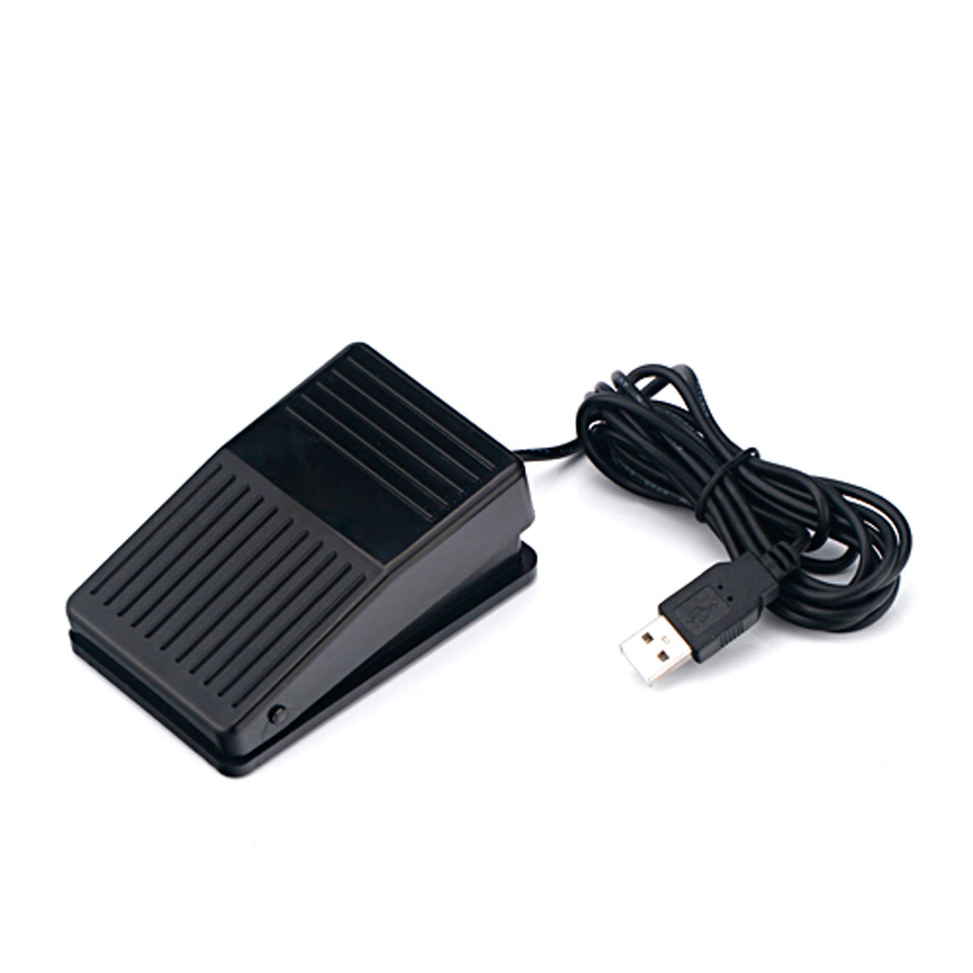

I use a lot of random old keyboards which usually do not have a Windows key. I refuse to remap keyboards to something weird because I use so many of them.
I use some of these when I'm using those particular boards:
You map it by flashing the nand, so whatever you set it to will follow the pedal. I set mine up with the Windows utility, but a review on Amazon suggests you use this for Linux: rgerganov /
footswitch
