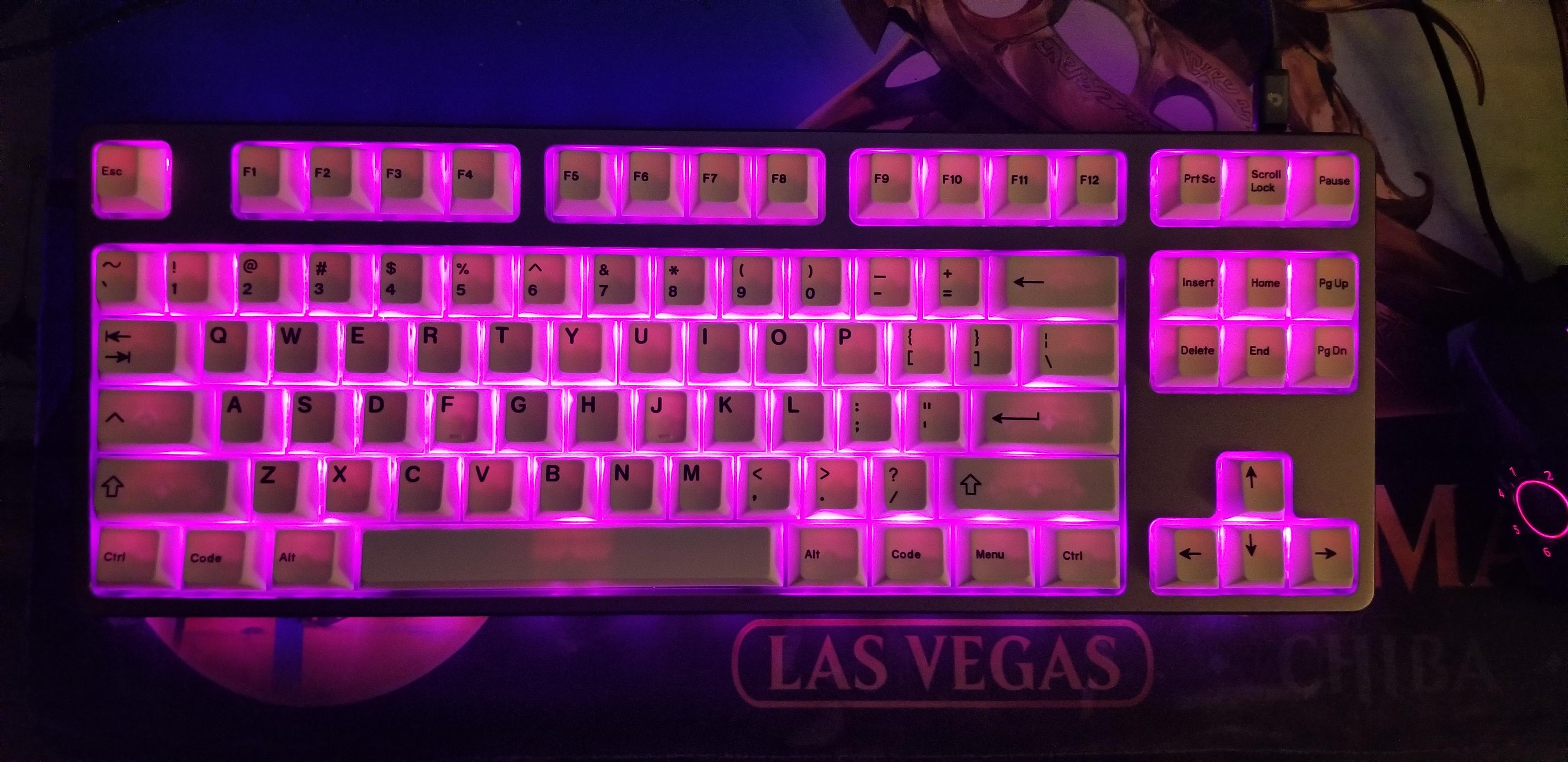

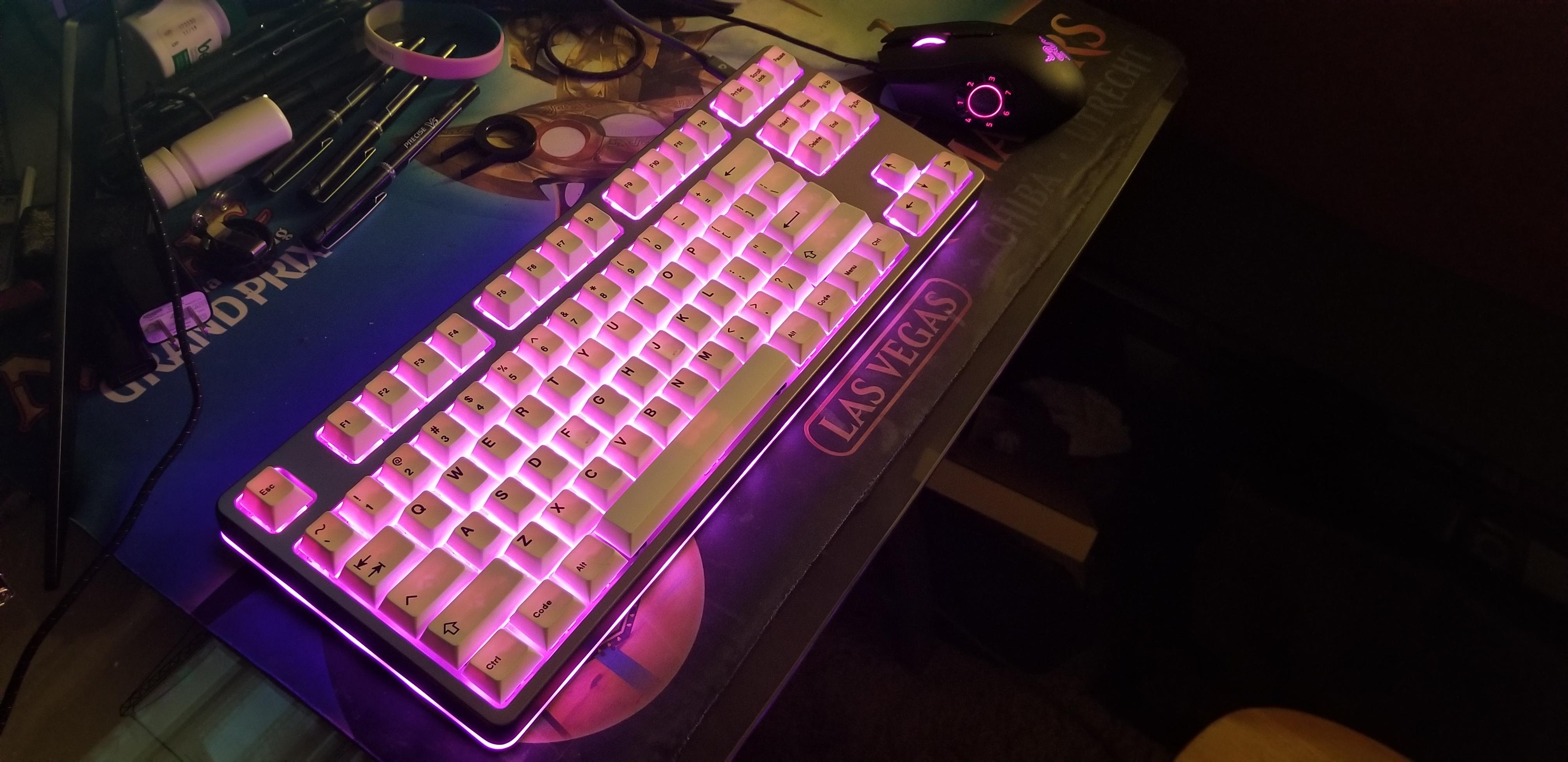

Just what it says on the tin! The last things I needed for my keyboard, the switches and cable, finally arrived today. I ordered everything through Drop, because I know people who've ordered things from there before and I wanted to make the ordering kind of easy for myself starting out. I must say, I'm really happy with the results so far! Here's the details:
PCB: Drop CTRL
Case: CTRL High-Profile Keyboard Case
Switches: Drop Halo Clears (Tactile 65g switch)
Stabilizers: Everglide Panda Plate-Mounted stabilizers
Keycaps: Artifact Bloom Series Keycap Set (Black on White)
So, with this board, I have a few notes I want to post somewhere I, and maybe other newbies, can reference for the future. First, I should've done more research before jumping into my buying decisions. I thought that if you got a PCB, you could find alternate cases (specifically metal, I prefer something heavier. Knew that going in) fairly easily. This was, obviously, incorrect. You get a PCB, you have to get the case made for that specific PCB. Port locations, layout, etc. are all affected by the PCB. And while there are cases for every layout, of course, a third-party case for a PCB is very unlikely.
Second, I need to buy some lubricant. This was less of a mistake, and more of something that I didn't want to jump into until I was sure that I'd enjoy the hobby. Spending hours and hours lubing stabs and switches was a commitment I wasn't willing to go for when I wasn't even sure I'd like the hobby. But after using the keyboard for typing this post, and some other things, now, I finally truly understand what people meant in keyboard reviews when they were talking about the rattling sound of stabilizers that haven't been lubricated. And now I want to stop this sound from ever appearing in my life again!
Third, and final, I need to think ahead when getting keycaps for a board with RGB that's even moderately strong. The LEDs are shining through the tops of the caps, and on the caps 1.5u or longer, it's very apparent, as you can see the outlines of the mountings. I don't think it's just the thickness of the caps, but also the color of the caps I'm using. White doesn't exactly block other colors very well.
In the end, I've learned a lot over the process of getting this board and assembling it, and I wouldn't have it any other way! I'm already in love with this hobby, and I can't wait to put my new knowledge into practice with my next board. Currently thinking of going with a NK65 V2 Aluminum, and going for another tactile switch (though a different brand, I really want to try more switches.) to try out a 65% - 60% board. Anyway, enjoy some pictures of the board!

Congrats!
Almost all stabs benefit from lube, some are pretty good from the factory but it's pretty rare.
Not all switches benefit from lube, boutique switches are less likely and you can screw them up.
I would start with your stabs and only do the switches if YOU think they need it. Don't go based on what others say because a LOOOOOT of people lube every switch regardless either out of habit or as insurance to make sure all are lubed equally, the latter makes sense if you have hard mounted (soldered) switches, you don't. You can also make things worse by lubing them if you use an incompatible lube, at which point the only proper fix is an ultrasonic cleaning, lots of electronics cleaner (toxic) or replacement.

Nice. I thought about getting the CTRL myself but picked up an ALT. Seem to be pretty solidly constructed. You'll find some caps you like with less bleed.
You can mix and match some boards and cases. The most options are probably still in the 60% form factor. The problem with your choice is that the CTRL is very much a package deal. It is meant to be used as-is besides swapping switches and caps.

Honestly, I could've phrased the post better. I don't plan to lube the switches, as I like the tactility and I know that sometimes gets lost with lube. Thank you for the concern though!
Yeah, I figured that out after a bit. The CTRL doesn't seem to be compatible with anything other than CTRL parts for the case, and either way TKL is a less popular layout than 60%, so I see how it would be easier to find 60% boards that can fit a wider variety of cases.
And as for caps, yeah, I'm already planning to look into it a bit. Not going to jump into buying anything just yet, because I have some expenses coming up that are necessary and unavoidable, but I'll definitely look for some that are still in the aesthetic I like and thick enough to stop light bleed. Thank you for your input!

Great post! As a newbie who just took the plunge today, this is some good information to go off. And a route that I probably would have blindly trekked if not for this post.
I'm currently using a Ducky x Varmillo MIYA (65%) keyboard and will probably end up building a 65% keyboard just out of preference. Knowing now how popular the 60% keyboards are, I might end up scrapping the arrow keys altogether.

I couldn't use 60% boards for all of the things I do, so 65% is the smallest I'll ever go. If you're not using the arrow keys in conjunction with a lot of hotkeys, ditching the arrow keys is considered an improvement in efficiency and ergonomics amongst the tiny keyboard proponents.
How you lube tactiles is what alters tactility and it's easily avoided.
What I was referring to is that some simply do not change in terms of friction.
