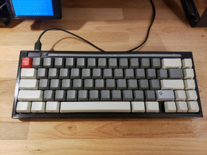

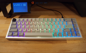

Pics of mine:

I went down your same path, it's how I ended up with that printed keyboard and the dock you see in the pics, I was hoping to do more with the tiny lcd but it just wasn't capable. Personally, I've found my dock needs changed far more often than my keyboard because while keyboards rarely change everything else does. In my docks I've had volume knobs, power switches for multiple systems, sdcard readers, router reset switch, ESATA ports, one even had a bios reset for overclocking, the next revision will have type C and a network port... I couldn't make those changes or integrate so much if it had been built into and limited by the shape of the board. Build a dock with all you need or want it will make you much happier and allow for much more flexibility. Laser cut, hand cut, 3d printed, make it however you can, your hands are not on it as much so how it's made and made of is less important than what it does compared to a keyboard where it's all touchy feely, it also means a lot less trial and error (and expense/regrets) trying to get it right or later deciding it was just not as good as you'd hoped.
The GPU doesn't need to be high end just enough ports, ports that are not just an alternate connector.
A GPU may have multiple DisplayPort and HDMI but they may be paired, i.e one HDMI is just an alternate connector for the DisplayPort output (DP is backwards compatible with multiple connectors). I've seen a 1060 that was this way, it had dual DisplayPort and dual HDMI for VR, but the second HDMI was tied to the second DisplayPort, you could only have one DP and 2 HDMI or two DP and one HDMI. There was no way to do 4 screens. This is the same problem my mobo had, the HDMI was paired to the second DisplayPort. It's fixable if you know the issue, but like me at the time, most assume a port is a port, you plug a screen in, screen works.
By the way, some of those screens handle resolution oddly and how it displays info may or may not work well depending OS and monitoring software used. I have 3, one like yours, the one you see and one larger one. The large and small ones have a set resolution so if widgets look bad there's only so much I can do to compensate, the littlest one you can't see the cursor to adjust the widgets but because the resolution is better it makes the widgets and text look better. The middle one lets me set resolution which gives me a way to better tune the looks of it but because it was meant to be used as a touch screen it has the worst display quality of the bunch and it's also the thickest, I had to desolder a bunch of junk related to power and the Pi connection to make it slim enough for my purpose. I still wasn't happy with the size of it.
