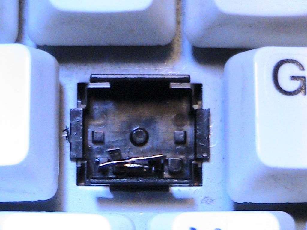

I have done this before (did you read my post? :/ ), the problem is that the click leaf is bent a bit wrong, and the copper part it interacts with in the socket is especially bent out of shape.
I guess what I'm going to do next is to get my old avant out and remove one of its keys to get a fresh click leaf and examine how the "interaction leaf" is supposed to look and try to bend it that way.
If not I'm going to need a procedure to replace it and it's hard to even find diagrams of these.

Unable to bend the copper piece that closes the circuit on the switch plate into such a way that it will allow me to place the switch back into the socket.
I don't know what to do, buy new keyboard I guess ;-(

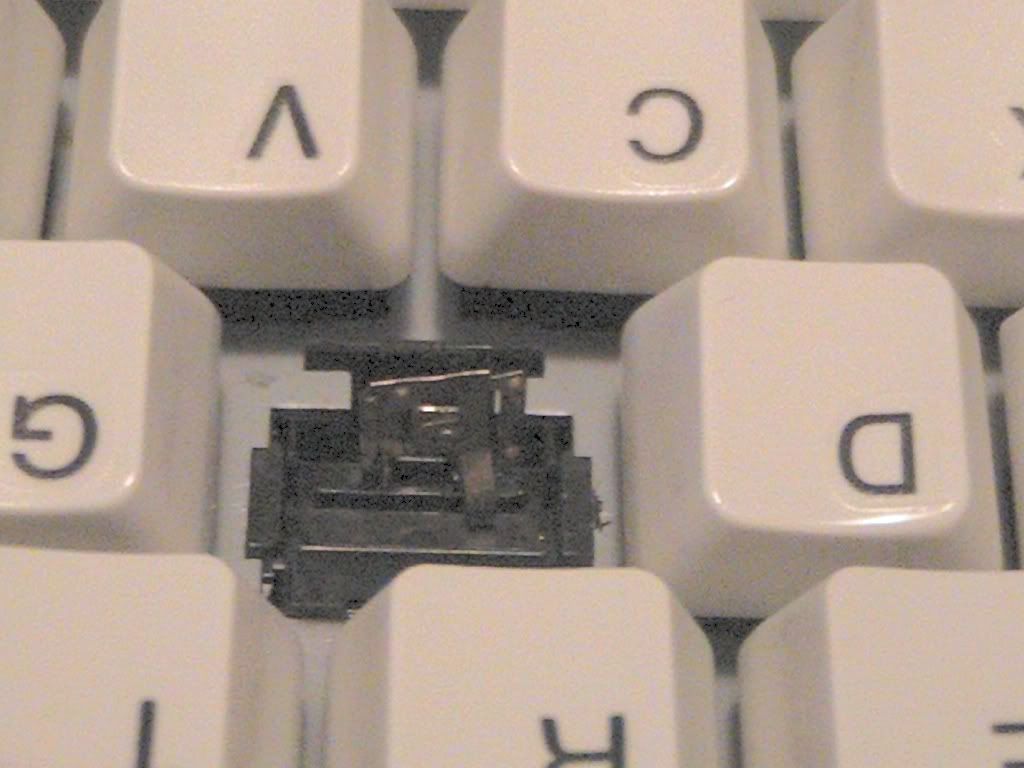

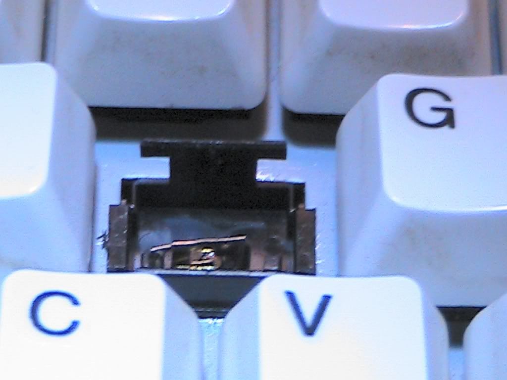

Bent piece that the click leaf interacts with:

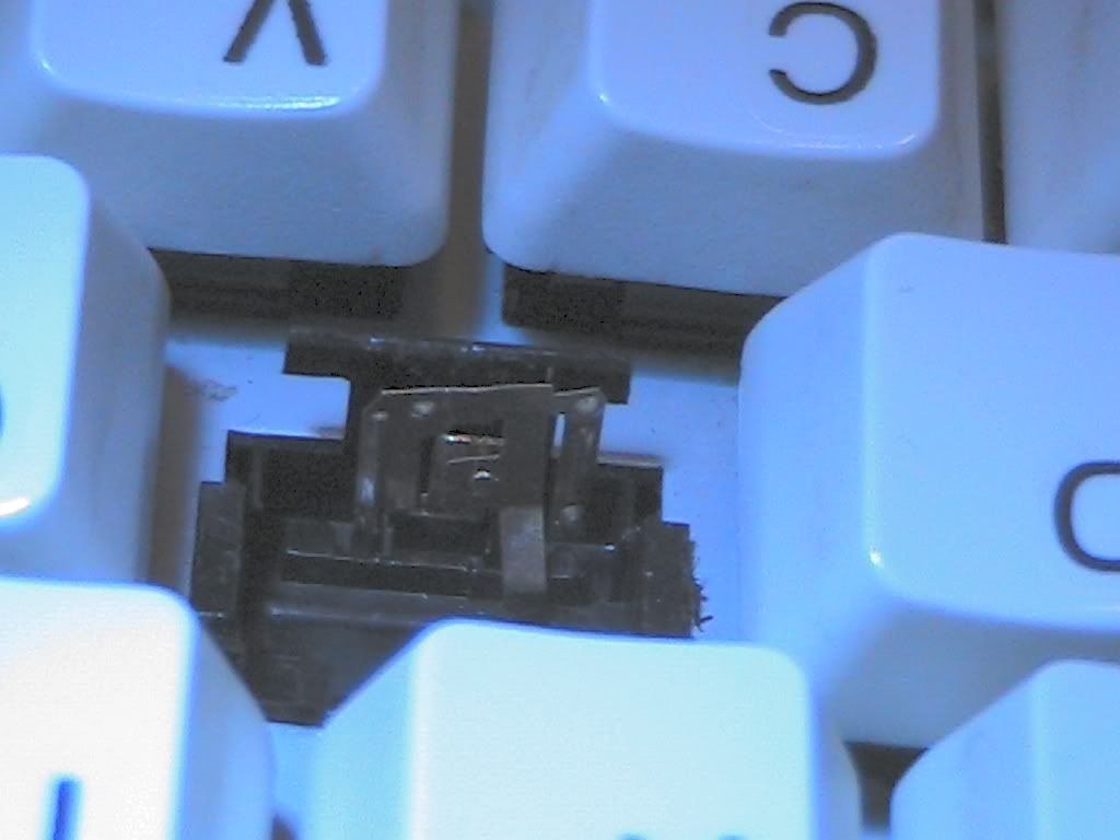

The other parts to the key:

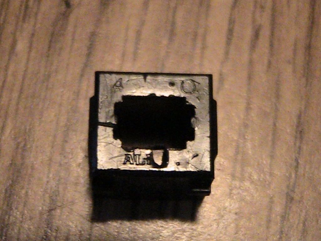

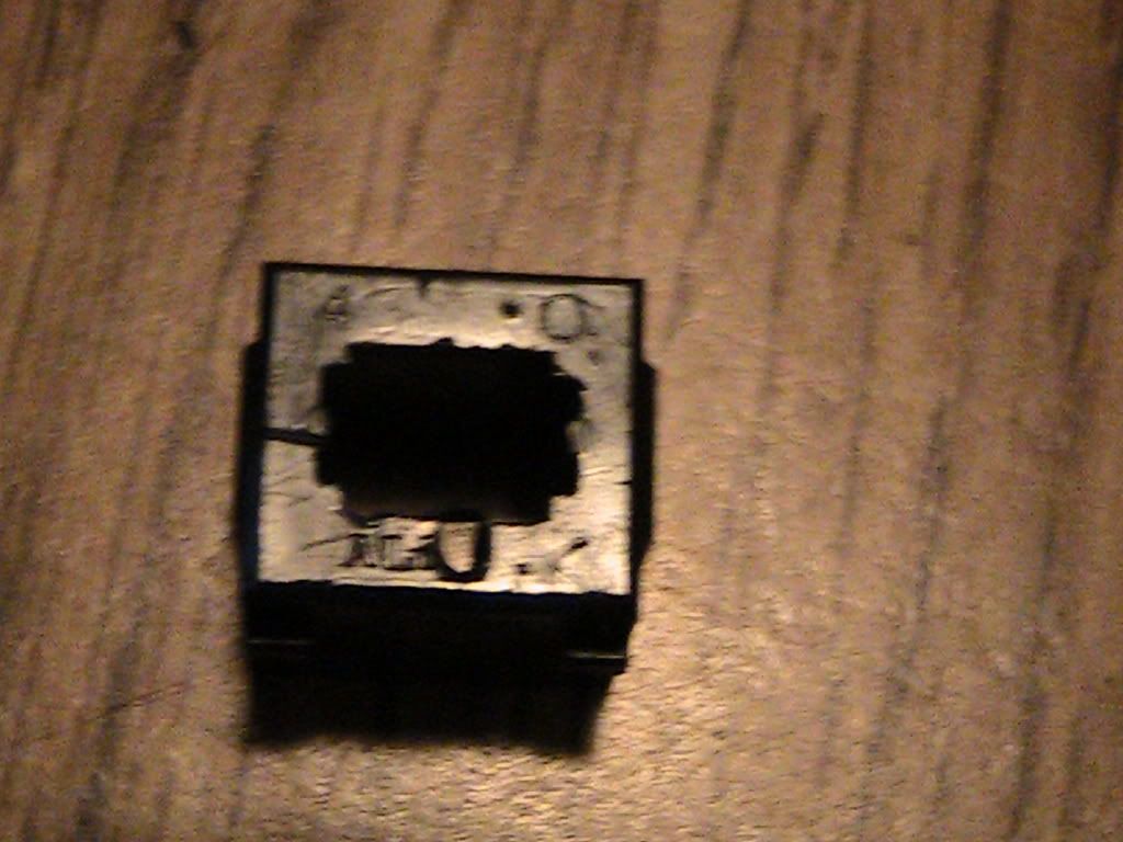

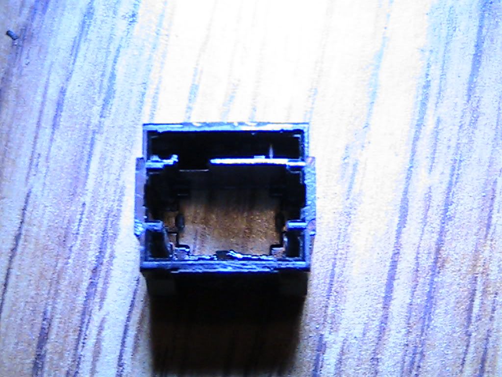

The housing that had an unfortunate accident, a small hole was punctured in the plastic with a tiny awl by mistake. No change in its function.
Bottom of housing, which looks very ugly up close, I assure you it is in better condition than it looks:

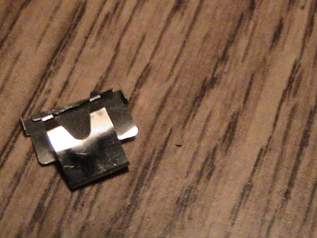

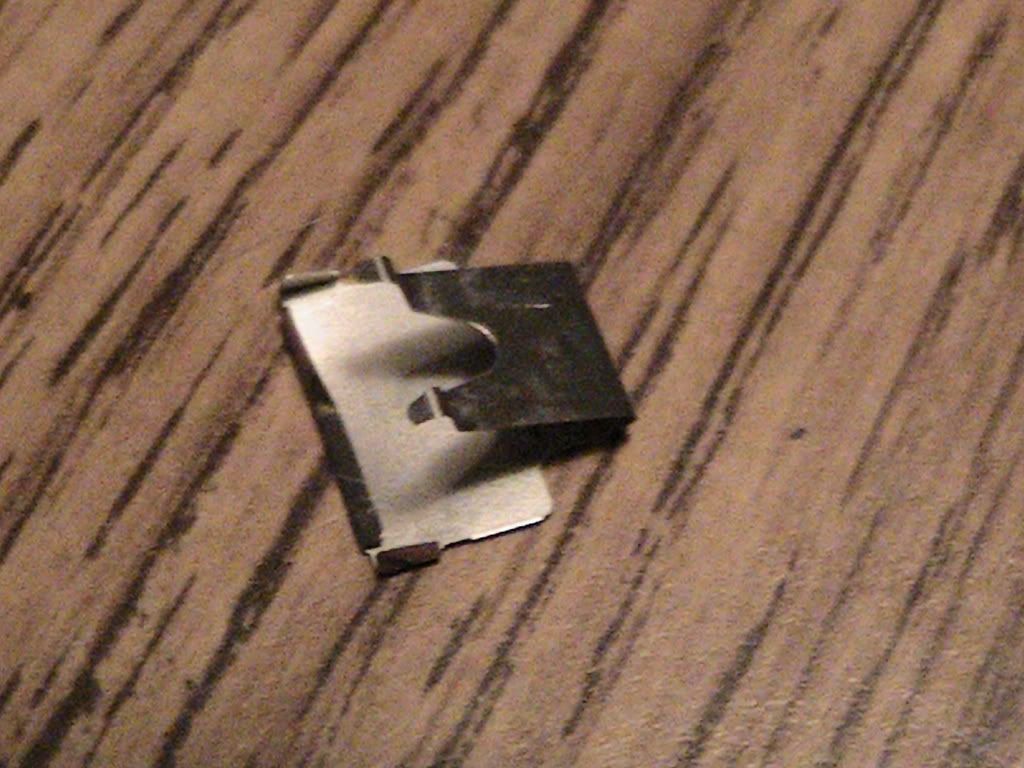

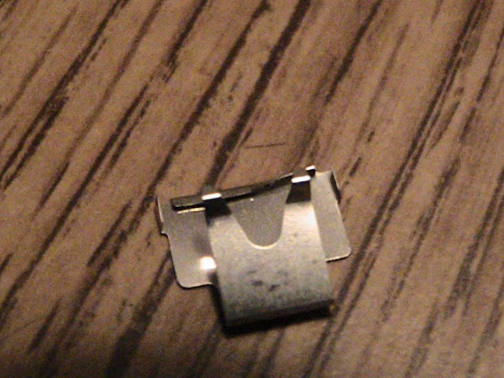

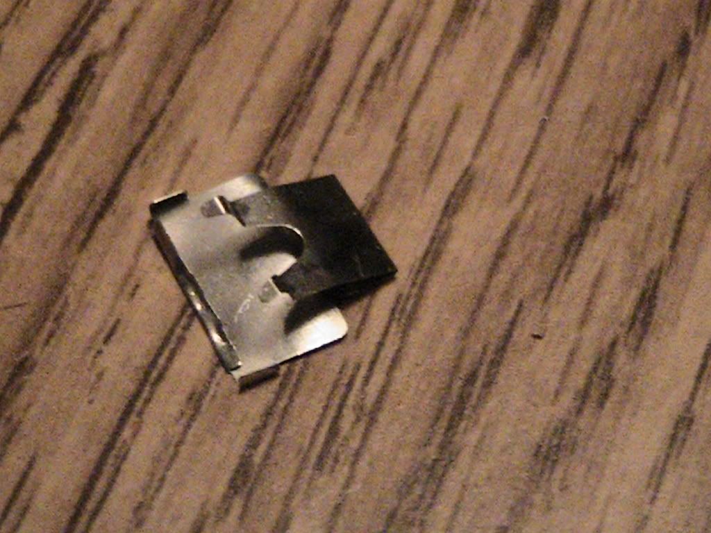

Original Click Leaf which shows some damage on the bottom "fin":

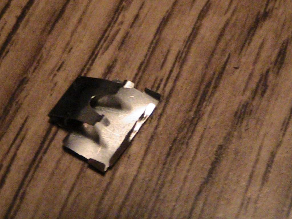

Newer Click Leaf that is in better shape but is showing the same type of damage that happens when I try to put in the switch:

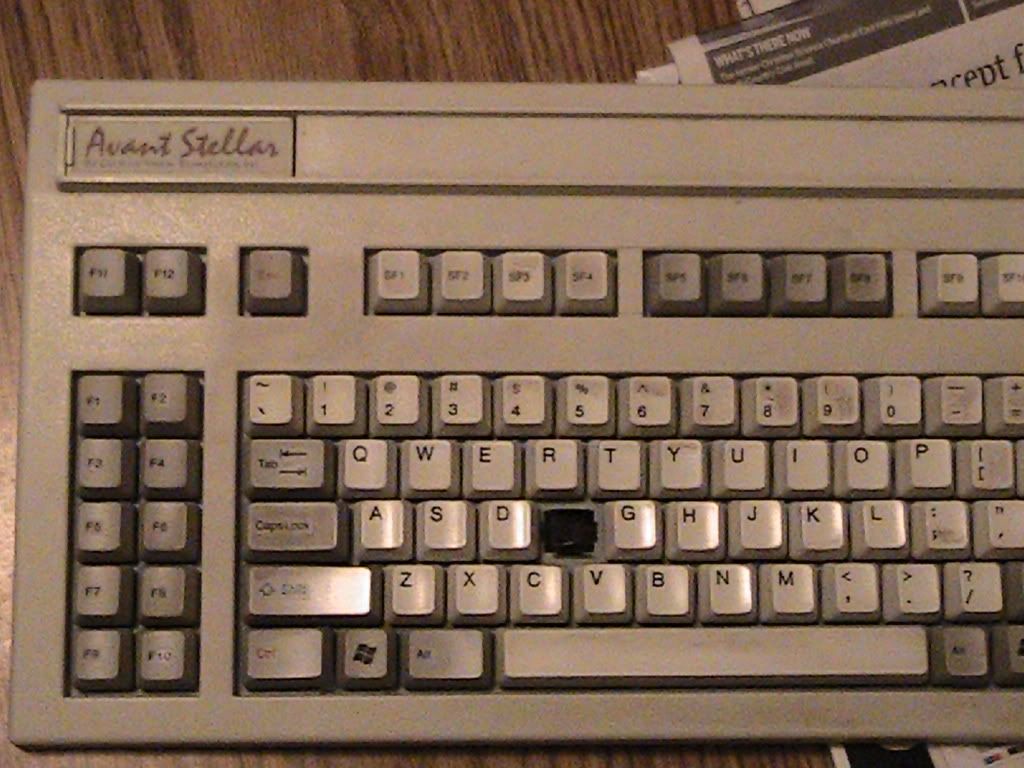

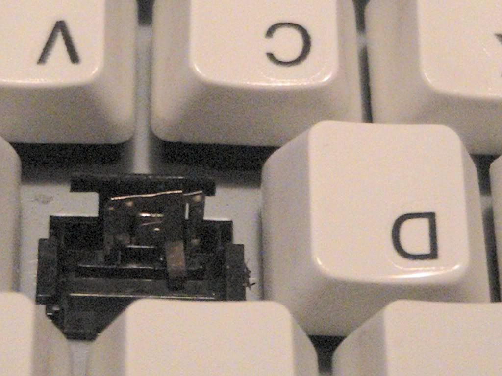

An Avant Stellar with an F key in turmoil :-(

Quote from: ripster;405755
Say goodbye to that Simplified Type 1 Clicky ALPS.
You really need to desolder it and replace/swap at this point with Scroll Lock or whatever.
I'm pretty sure this is beyond my abilities but I was curious as to the procedure.
How exactly would you remove it? The pcb is held to the key plate via the soldering of all the keys, so I'd have to either insert a tool to exactly the right spot or can you desolder it from underneath?
Is there absolutely no way to bend that copper piece back into a reasonable enough place?
