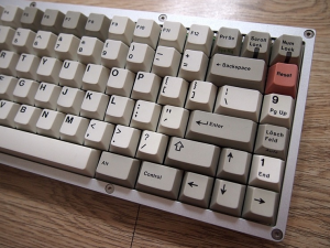

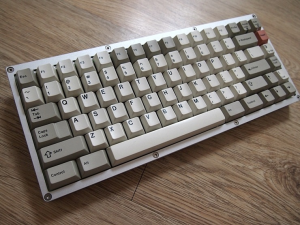

I also a while back I saw a very sexy looking Choc Mini in the classifies and wanted to know where I could find a case and the key caps for this mini.
8293-0
I did notice that space bar row look like 1.5x caps and the right shift key look like the size of tsangan kit.
8295-1
Can anyone get me started in the right direction?

With a Choc you'll need to desolder the switches before you can mod them. Your best bet is to camp the classified in search for the clear stem or switches.
The MX-Mini is a custom Korean Keyboard what is similar to the Choc but uses 1.5mods, 7x spacebar, and 1800 shift. You can try to camp the Korean forums for a MX-Mini but be prepared to fork up $150+
-Enzo Ferrari

i figured i would be desoldering. i gave it a 2nd look and see the difference now, thank you!. How would i go about finding caps the fit the Choc?
You'll a combination of a base set and tsangan kit
