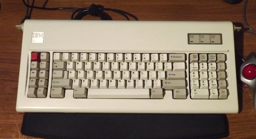

AKIMbO’s Model F on top and my new SSK on the bottom
Recently I’ve hit an amazing good luck streak and managed to get my hands on an SSK and joined AKIMbO’s Model F tour. So I finally got my hands on buckling spring switches and I’m extremely excited. Since I tried out The_Beast’s and Trent’s SSKs in Chicago, I’ve been dying to own one of my own. And now? WISH GRANTED! Thanks GirlShark! (Yes, the GirlShark itself deemed me worthy to own its former keyboard. I bask in its glory :P.)
But seriously though, I’m happy to finally own an SSK and to try out the AT F. I’ve heard so many good things about both boards and I got to try them out side-by-side! And I hope everyone on the AT F tour will forgive me for keeping the board for a little extra time. I’ve been busy at work and haven’t had the chance to write. But as the AT F tour rules state, I have to write a review. And so here’s what I owe you all: my thoughts on the IBM SSK and AT F buckling spring keyboards.
First off, for all you IBM fanboys, here’s a picture of the back of the boards.
The little sticker was orange. I’m not sure if that means anything. And the board is a two years older than me hehe.
Back of the F. Doesn’t have the cool tag that the SSK has.

Like I said above, both the boards are in really good condition. There’s not a lot of yellowing and both are very clean. Trust me when I say I know what yellowing looks like. I bought a Focus FK-2001 with yellowed caps. I’m happy to say neither of these are that yellow.
The SSK has no LEDs and has a little circular clear/silver IBM badge that seems to be a sticker or something drawn and then lacquered over with a clear coat. My board also has caps from an IBM Personal Wheelwriter; which explains some of the green text (Special shoutout to Parak for the knowledge bomb on where my caps are from!). I really love the backspace actually. The F has a little silver bage with “IBM Personal Computer AT” printed on it. It also has green rectangular LEDs which are similar to the Dell AT101W. Overall the boards have a lovely retro look with very clean and nice, contrasting legends on the caps.
Unfortunately I don’t have the nutdriver needed to take apart the SSK and I don’t own the AT F so I will not even consider opening that up. However, I’m positive there’s a million pictures of them online and the GH Wiki has some cool pics.
The AT F has one piece reinforced caps. They look to be dye-sub PBT.

These guys are tanks. I think this F AT is three to five pounds while the SSK is maybe three pounds. The two actually feel very similar to me in regards to the weight. The SSK has the normal flip-out feet that most keyboards have. But the AT F has these spring-loaded rotational tabs that keep the feet out.

It’s somehow springier than the SSK switches. They just feel so responsive and the spring constants seem to be higher or something. I think these are my favorite clicky switches. I’ve been saying for the entire time I’ve had the board that I’m extremely sad that I have to give this board up. Typing on it just feels so nice. The sound is so sproingy/pingy and the actuation feels a bit lighter and clickier than the SSK.
However, the layout has been driving me crazy. There’s no winkey. Escape is where num lock would be on a full size board. The delete is a 1x space key. The function row is on the left and setup vertically, which completely baffles me. The CTRL is where Caps Lock is normally. The enter key feels odd, as if the spring is somehow less springy than the res of the switches so hitting enter can feel dull and flat instead of springy and vibrant. And the spacebar is probably three or four times as heavy, in terms of actuation, versus the rest of the keys.
With all that being said, I’d buy one of these boards any day and figure out how to Teensy it to get a layout that works for me. And mod the spacebar to be lighter.
