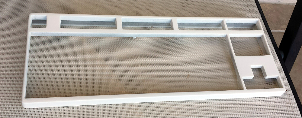

I'm a total noob at this.   As you can see, I wasn't very concerned with the inner surfaces.  The paint process was basic:  Sand, a couple coats of Valspar plastic primer, several coats of Valspar gloss-white lacquer, and a couple coats of Valspar lacquer clear-coat.  I lightly sanded with 800-grit between coats.  I was going for a sheer gloss look, but as you'll see I ended up with something else.

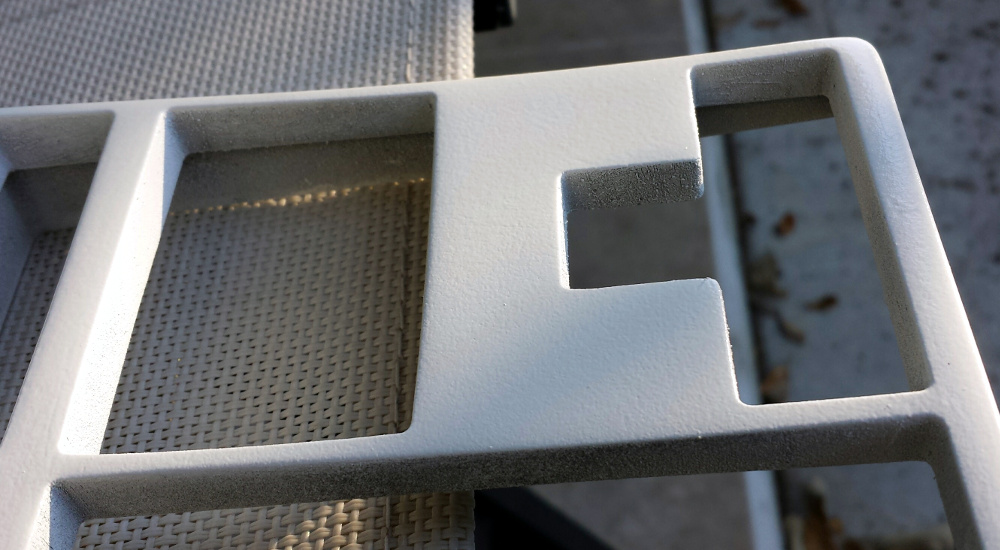

75763-1
After discovering how hard it was to get that rubber off, I ignored earlier tips and went at it with 60-grit.  As a result, I scratched the case up a bit.   But the scratch lines combined with the lacquer paint make it look and feel a bit like painted wood.  I like it.

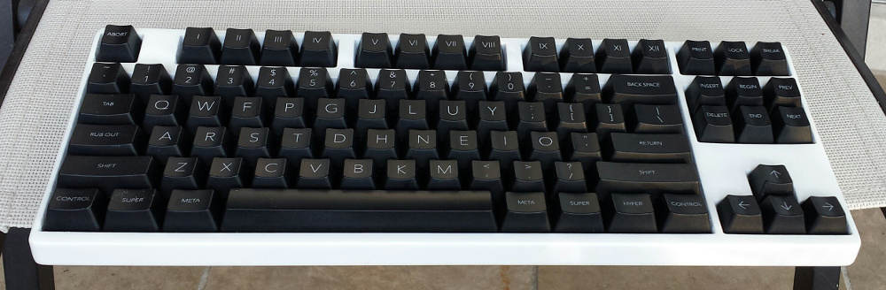

75765-2

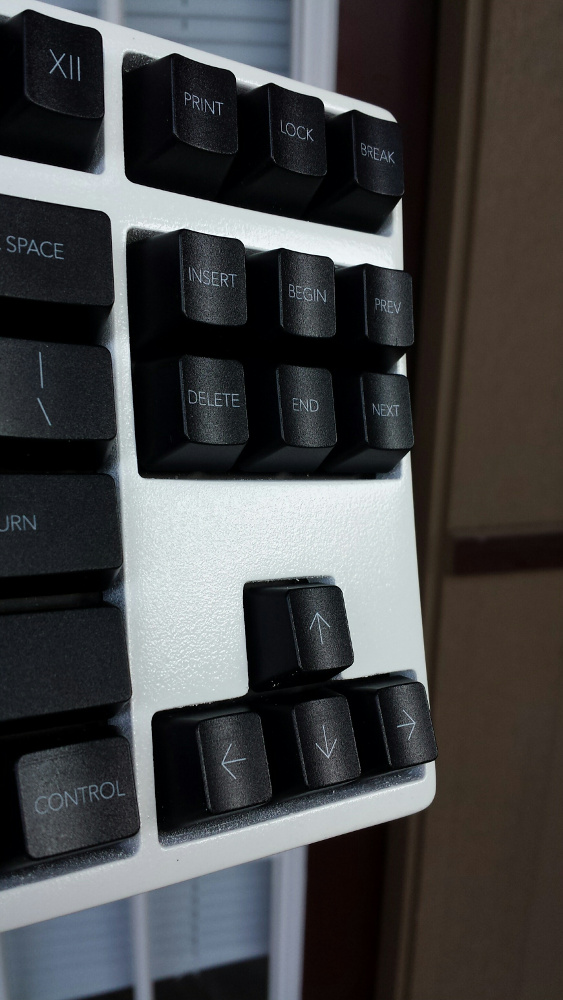

With black keys for maximum contrast.  These are WASD's new UV printed keys.  The texture works well with the paint.
Now we see the magic.  The lacquer paint produced a wonderful texture!

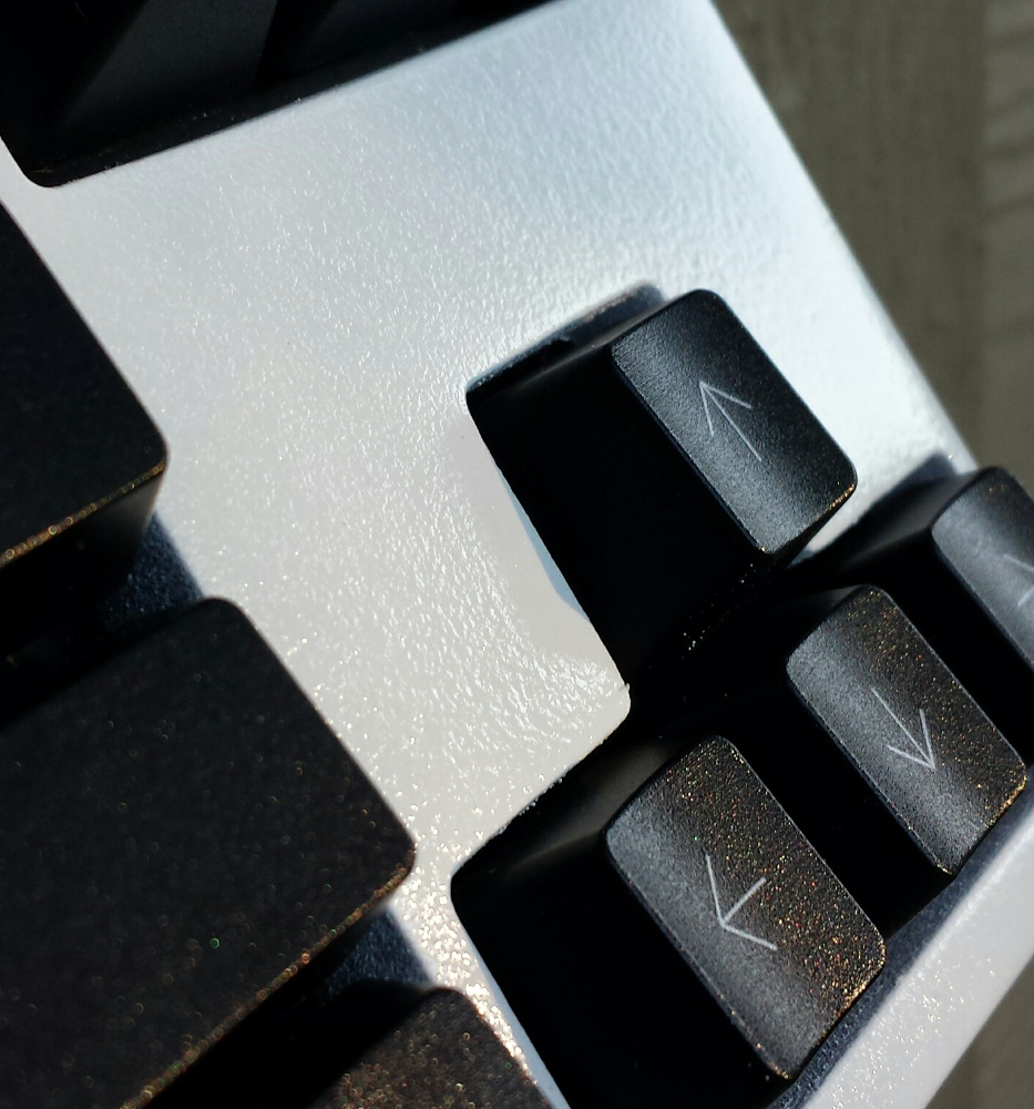

75769-4
Close-up of the texture.

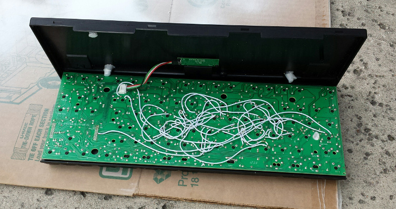

And now the science!  Below this new case lurks... a monstrosity.  Last year, I decided I needed Colemak in hardware.  The WASDv2 wasn't out yet.  I did what I had to do.   I am not proud of this work.  (I am, however, happy with the results!)
