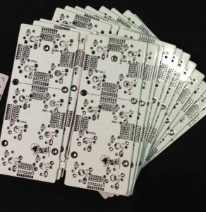

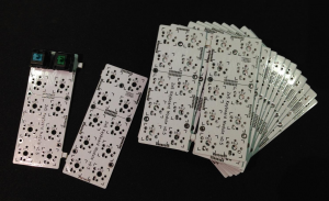

Here's what I got - 12 boards total, so I got the + side of the +/-10.  You can panelize (<-- you have to do this yourself) whatever you want in the 5 or 10 cm square, so I put two of these things in there.  It broke apart pretty easily, though needs some cleanup.
96046-0

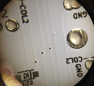

Everything tests fine electrically (though I only checked 3 pair), the silkscreen looks readable, even the tiny text on the back.  My only complaint would be that these vias are only semi-tented (if that's the right term).
96048-196050-2
The soldermask is nice, edge cuts are nice.  The solder mask around the pads is a bit off center, but hey... it's cheap.   I ordered 10, received 12, and because I fit 2 in each 10x10 piece, I have 24 of these things for $25, which works out to $1.04 each.  All in all I'd say it's a win.

That's a completely legitimate question, it's not really a design I shared before.   I really didn't need this many at all, but it was the same cost if I got just 3 of them at OSHPark, instead I got 24.  I also just used this as an excuse to test out DirtyPCBs for how long it took, as well as quality, so I jumped the gun a bit on sending in this particular design.  In the ~30 days it took to get them, I've gone through some additional revisions and added LED support.  I can still use them, however, for spacing and just playing around with.
The holes for the switches allow the PCB to be oriented either horizontal or vertical, and there is the smaller 2x2 breakaway section.  PCBs go down in price significantly when ordered in larger quantities, so I was just toying with the idea of using numerous inexpensive base elements to assemble a larger layout while reducing the amount of hand wiring involved.

That seems pretty bad to me - what is the spacing on the QFP for them to not be able to put down a solder mask dam between the pads? Also, the rest of the pads have the mask aperture shifted a lot :(
You can't make dam between even 0.7mm pitch qfp pins from their specs at least, actually you can do that ignoreing thier recommended design rules but outcome will be vary. I use relaxed design rules these days to conform to specs all cheap fabs offer.

I suspect that they don't mention capabilities of colors other than green and black - their claimed capability of putting a 3 mil dam on green mask seems quite sufficient to me even for 0.5mm pitch (and 0.27mm gap, not 0.20) ... but with the mask aperture alignment issues, it seems like this is a bit of a moot point. Otherwise, it could be possible to put a 3 mil dam + 3 mil clearances with green mask. But well.. they are cheap, and they do say themselves that the pcbs are crappy at the top of the page :p

I didn't look my pics close :D yeah, mask opening is misaligned definitely, not good.
But I usually look into pcb closely and it is ok to me if it just works. I may be too generous for pcb fabs :)
They seems to offer better nubmbers in their capability than other houses and I could do dam between pins probably with green. I didn't found solder mask capability changes by mask color. http://dirtypcbs.com/about.php
I used 0.13mm for 'Solder mask clearance' and 0.1mm for 'Solder mask min width' in KiCad this time, it seems blue mask needs such clearance for safety considering their result pcb unfortunately.
