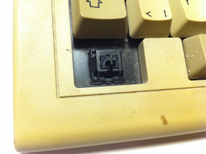

Hello everyone! I have just jumped into the unknown mechanical keyboard world a couple of days ago and I've been anxious to get myself one of them, I have been using chicklets for far too long...
Among countless brands, Filco's, Ducky's and the like, I looked up info on the classic IBM Model M (I actually had one variant of it when I was a child, my first keyboard... I would love to get a time machine and steal it from my puny 5 year old hands), which gave me the idea to grab a flashlight and dive into my girlfriend's house attic, where her father throws out all kinds of random tech stuff that are he doesn't use anymore.

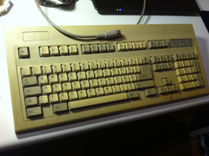

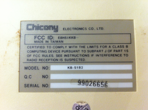

To my amazement, I found this beauty, a Chicony KB-5182 (ISO, DE layout):
122755-0
122757-1
122759-2
It looks pretty dirty and has a few scratches here and there, but in general looks to be in great shape for such a mistreated piece of tech. Seems like it sports Cherry MX Blacks, I tried googling some info on it but only found stuff about the ANSI KB-5181 model which is a bit "mysterious" about what kind of switches it uses, some Chicony keyboards have "fake" and "real" MX Blues, I would love to find out some more info about this particular model I found.

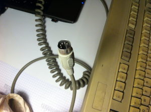

Other than that, my main question about it concerns my confusion on "convert to USB" options, I would love to give this keyboard a spin, but how to? Do I need adaptors from DIN-5 port to PS/2 to USB, and if so which ones can perform the task? Thanks in advance for anyone who helps me out with this.

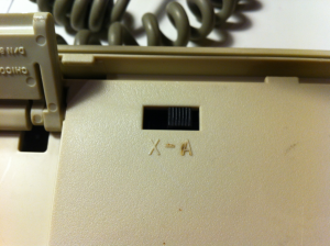

And to end my first post and probably reveal my complete noobness on this subject, what is this thingy for?

Good find!
In those early days where "XT" style and "AT" style computers were in use, the keyboard had to speak differently to each.
"AT" is the same as PS/2 even though the plug is larger.
A good cleaning should turn that into a very nice piece that you could still use today.
Personally, I do not like black Cherry switches because I need feedback, but my son, a gamer, loves them.

Re: Found something nice in the attic, assistance required!
« Reply #2 on: Sun, 03 January 2016, 16:04:20 »
From the pictures you took they appear to be genuine MX (vintage?) blacks, but I'm not sure what kind of adapter you would need.  There are probably DIN-5 to USB adapters out there but if they are available in Germany would be the main question.  Otherwise, with a good cleaning and the adapter you'll be up and going on it in no time!
« Reply #3 on: Sun, 03 January 2016, 16:14:36 »
Those are legit MX switches, don't worry. On an old board like that they're bound to be pretty damn smooth so you lucked out there.
As for converting it, you'll want just a basic AT to PS2 converter, then an active PS2 to USB converter and you'll be all set. Just make sure to have the keyboard switched to AT and not XT
« Reply #4 on: Sun, 03 January 2016, 16:16:58 »
You'll need to convert from DIN-5 to PS/2, then either just use that (if you have a computer with a PS/2 port) or use a PS/2 to USB converter.

For cleaning you can take the case apart and give it a good wash with warm soapy water (no abrasives, and go around the sticker to keep it intact). From there, you can pull the caps and let them soak in some more warm soapy water (or do some denture tab cleaning if you feel ambitious). Once the caps have been soaking for a while, take them out one at a time and clean off any caked on nastiness with a paper towel. For the circuit board, wipe it down with a dry towel to get any hair and whatnot off. For the plate ans switches, I usually use a qtip and some alcohol/soapy water to clean between the switches, and compressed air for everything else.
If you really want to get crazy with it, you can make some retrobright and cure it in UV light. But there is nothing wrong with a yellowed board; it shows its age well.

How nice were the Chicony keyboards back in the day? It's the first time I've heard about them and I would love some more info.

I have a Chicony KB-5181 with Monterey Blue (alps-like) switches that are considered quite good. The only thing is I found the case to be quite tinny and hollow. I took the board out of the case and plan on making a custom wood/antler case for it as the board itself is quite good.

Those Cherry MX Blacks look to be vintage, which are actually quite a bit smoother than modern Cherry MX Black switches. That'd be some extra good luck!

Chicony boards are pretty solid all around. If you want to help get rid of some of that yellowing, a much more basic version of the full retr0bright is just some 40 volume peroxide mixed with water (sorry, forget the ratio) and a little bit of oxy-clean. Pour the mixture in container and let the case and keycaps sit in the bath in the sun for a few hours

« Reply #11 on: Mon, 04 January 2016, 01:14:12 »
Nice find bro that is a big logo Cherry mx vintage black  :thumb:
« Reply #12 on: Mon, 04 January 2016, 04:29:09 »
I'd concur that those switches look very much like vintage black MX switches - very smooth indeed!
