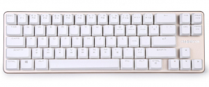

My new keyboard arrived today and since there doesn't seem to be much on these I figured I will do it. This is not a long term test, I'll update that section later, I just want to get initial impressions out first. I literally pulled this out of the box 5 minutes ago. No one gave this to me, I spent $39 of my own money on it. I got it from Amazon and had it in two days on standard free shipping. Not bad.
In the box
It came with a small instruction book, really small. Considering that there is no dip switches, it basically lays out what fn keys do. That's it. It also came with a  USB OTG cable for use with phones, and a keycap puller. We all know what this stuff is so let's just move on.
Magicforce Keyboard
126490-0
I didn't get the backlit version, while it would be nice, it added quite a bit of cost and I mostly wanted to test out the layout as I was working on something similar, more on this in a bit.
The keyboard is very lightweight, being small with a (painted or cheaply anodized) aluminum plate you would expect that, but it's really light, and yet very stiff as well, it feels really good. The plate appears to be pretty thick, which may be why. At any rate, I'm impressed, which says a lot when you remember I'm comparing it to a Filco with aluminum Vortex case. I'm not liking the color I got, but I planned on repainting it. I may just fill in the Magicforce logo, but it's shallow enough I may be able to grind it out. Backlit versions appear to go through the plate and get backlighting (I could be wrong on that), this does not. There are also no dip switches on this version, I was under the impression there was, but apparently that is limited to backlit versions. The backlit version allows you to disable the winkey this way.

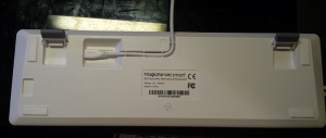

Bottom
126492-1

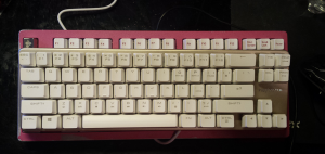

Fit and finish is pretty actually really good, better than some other cases I've seen and own. Considering this is made in the Leopold factory (supposedly), that's not a surprise, but I doubt you could beat the fit and finish for the money. Seriously, it looks and feels like a much more expensive board, I spent FAR more than this on my Vortex Race and this blows it out of the water. The kicker though, is this...
126494-4

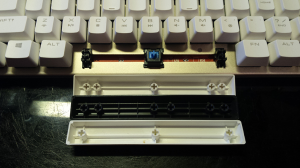

Top spacebar is stock, second is Vortex, and last is a Filco. In other words, it uses a conventional spacebar, unlike Leopold. I'm not impressed with the stabilizer system, but not unimpressed either.
You can see how thick the plate is here.

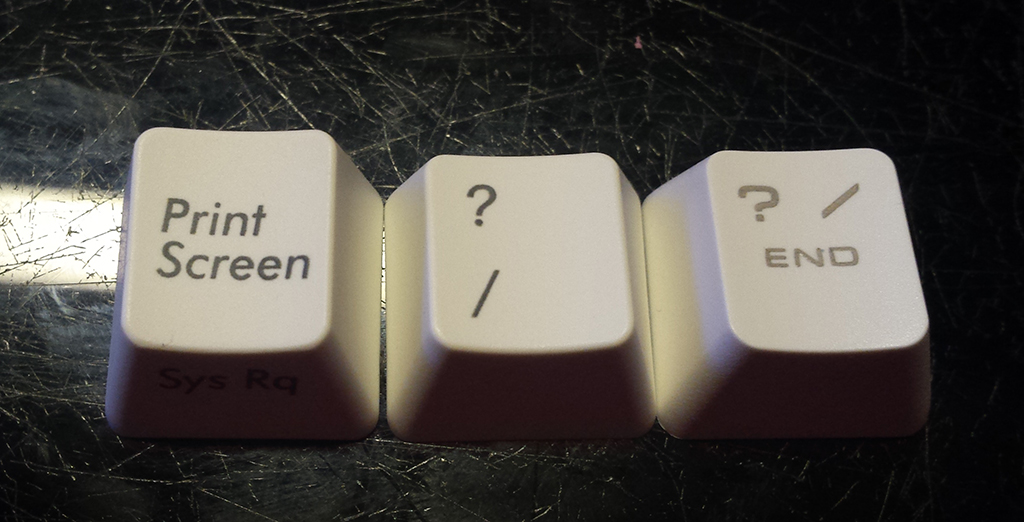

Keycaps

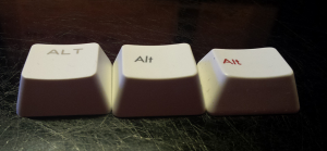

These have a strange feel, I'm guessing POM or PBT with standard thickness, and at first I would have sworn it was dyesub, but they are merely printed. Good printing, but stillprinted, it didn't rub off at the first sign of a fingernail touching it. While the backlitkeys may be doubleshot, the fot in terrible in my opinion. That said, they have an odd feel to them. The corners are pretty sharp. Another issue is the amount of information on them. I still have to look at some keys to find punctuation and such and on this, you sometimes have no idea what you will get if you hit shift or FN as there is no differentiation. On most keyboards the FN is a different color or printed in a different spot, not so on this.
Have a look.
126486-6

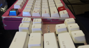

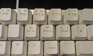

It gets worse when you get up into the high F keys, tell me this doesn't look ridiculous. And remember, almost half the keys have a modifier.
126488-7

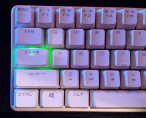

Caps lock lit up
126500-8

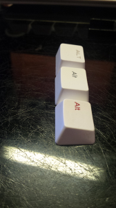

Regarding the shape, they remind me a bit of the KBT Vortex profile, sharp corners and tall. They aren't actually tall, it's just has less tapering on the sides and sharp corners. If you have short nails it's not a problem but if you have more than 1/16in, you may find yourself clipping the one beyond what you aim for. I have new keycaps already waiting for it, but if you like island/chicklet keyboards, you may like them.
Looking at the pictures, you might think the Filco caps are the same, but I assure you, they are not. The Filco keys never snagged my fingernails like these and the Vortex do. The SP keys look far different and have never snagged a nail, neither have the WASD keys (not shown). That said, after an hour or so, I've noticed it's happening less and less. The same could not be said for the Vortex keys, they always had a tendency to do it. The differences may be subtle, but they are there.
Red on white are SP Red Alert 2, Middle key is Filco, left and top is Magicforce. I couldn't get the Vortex to show up well, just imagine the Magicforce, but even taller. Escpecially the upper rows.
126502-9126504-10

Case: There are 6 screws on the housing, 4 under pads, one under the CE sticker and one under a blank circle.
127933-0
PCB:
There is no provisions for dip switches. While everything for LEDs seems to be there, there are no traces or mounds for the dip switches. It looks like there is single dip switch marking, but it's not used and I have no idea what it's for.
127935-1
Switch Housing:
They are NOT entirely Cherry MX compatible. They can be soldered into the same pcb, they look the same, feel similar, however, the housing, tops and stems are NOT compatible with each other.
Putting a Cherry MX blue into the Outemu housing resulted in very little or no tactility. I'm not sure it even activated. Putting the Outemu into the Cherry switch made it a bit more tactile, however I would worry that long term it could result in a damaged housing.
The housings will also not work in a universal board with cutouts for opening. They physically will fit, however, depending on design of the cutouts, you most likely will not be able to release the top. Cherry uses two small tabs, these use a long tab grabbing two small tabs. If your plate is close on the sides at all, odds are you will not be able to remove the top. If it only grabs the top and bottom, it will probably work. Luckily some of the newer universals are heading this way.
Feel
This actually surprised me, what a strange switch and I love them because of it.
Actuation seems to be a bit higher smoother than Cherry Blues. They have a very crisp feel that I haven't seen in Cherry, almost like a buckling spring, Cherry actually feels mushy by comparison. Another thing I've noticed is a lack of hysteresis, the actuation and release points are almost identical. You could describe them as crispy Clears with a higher actuation point but, and it took me a while to figure this out, you could also say they feel closer to BS or Alps. Not exact, but they don't seem like Cherry switches either.
When used for Jailhouse blues, they feel VERY close to a scissor switch, ramping up immediately, unlike Cherry which still has a small bit of travel. Based on measurements, they actuate about .1-.2 mm higher than Cherry based JBs. After actuation, they obviously have more travel, but initial feel, when unlubed was very close to an older Lenovo laptop in terms of feel. If you want scissor switches, add some o-rings under the cap and you're there.
I'm leaving these stock, I like them that much.
It's like having a softer buckling spring in a nicer format.

I got my leds and resistors, but before I started soldering I decided to check traces and see if there was power. I should have done this sooner.
Nope.
There is not only no power to the LEDs, but even the ground is interrupted. There is a lot of resistors marked on the board that aren't there. It's possible they need a macro to turn on, so I tried the one used on the lighted version, but that did nothing.
I'll have to play with it a bit more, I'm not going to go through all that hassle of soldering all of that only to find it doesn't work. I may just do one set for testing first.

Update:
Turns out the batteries in my voltmeter were dead. there is 5volts going to at least some LED sockets, I didn't test but a few, but there is voltage.

« Reply #25 on: Fri, 19 February 2016, 23:30:05 »
First lights added:
How to is here.
