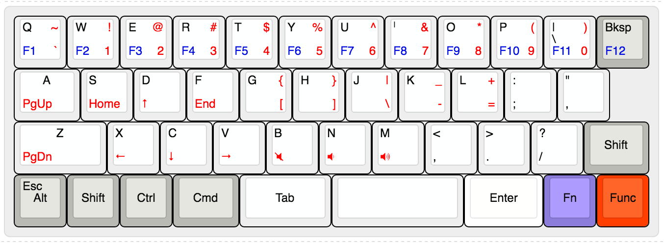

I thought about the following design:
152366-0
I'd probably use it mostly for text editing, web browsing, and coding (I often use emacs).
I moved all keys to the left, so that I get more of the standard punctuation keys on the right. I also decided to move curly and square brackets
further in (as opposed to on top of comma/dot or semicolon) so that when red is activated, all punctuations are available.
I thought to have 'Func' (red) locked if the key is just hit and released, and not locked if it is pressed.
Same for ESC and alt. (good for emacs... alt-x vs esc, x) but I'm not sure if it will work well. And, I don't remember if I need alt-esc for anything.
Any opinions or suggestions?

Re: Newbie first project: jd40
« Reply #3 on: Tue, 06 December 2016, 06:07:23 »
This is the proper subforum just no one has any feedback for you.
I'm on tapatalk and can't see your photos to know exactly which PCB you've got but gluing switches probably isn't the best solution for long term portable use with the original JD40 PCB it requires a plate.
If you have the newer version on the PCB with the extra holes for PCB mount switches they should stay in just fine without a plate and without glue. :thumb:
As far as keycaps many people use DSA sets since all rows have a common profile and caps can be easily relocated.
Some group buys have has specific kits for the JD40 as well.
