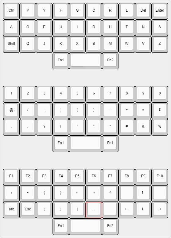

After spending too much time browsing this subforum and loving the look of Mr Bishop's Pawn and the Gherkin, I decided to have a crack at a mini dvorak keyboard to use with my phone or Surface Pro.
Layout is here if you want to play around with it. link
Using the two function keys either side of the spacebar to switch layers, with the layout based on the dvorak Flesky android keyboard layout that I use on my phone. If I can get a trader on Aliexpress to send me one, I might add a flexpoint pointing stick mouse, and use the keys either side of the up arrow on the second function layer as right and left mouse click,
Fortunately I'm a Fablab technician so making the faceplate and case should be a breeze. Will probably prototype it out of plywood and acrylic but will probably make the final one out of CNC milled wood and either aluminium and copper.

Re: 30% ortholinear dvorak keyboard
« Reply #1 on: Mon, 24 July 2017, 13:38:39 »
This keyboard looks promising, I can't wait to see it done.
One thing I wanted to ask is why are you splitting symbols rather than shifting them? I mean, on an ANSI layout, dot and left angled bracket are on the same key, you just need to shift. Can't you just do the same instead of having so many unique keys?

« Reply #2 on: Mon, 24 July 2017, 13:46:42 »
There's only 33 keys, those 3 keyboards are the base level, Fn1  layer and Fn2 Layer. Should have labeled the diagram better. The final keyboard would look like this.

« Reply #3 on: Mon, 24 July 2017, 13:52:14 »
Yes, I get that, I'm talking of layers specifically, on Fn1 you have, for example, the number 1 and the exclamation mark on different keys while you can have the exclamation mark by shifting the number 1.

« Reply #4 on: Mon, 24 July 2017, 14:09:44 »
I'm trying to keep chording down to two keys. To have the exclamation on the same key as the number 1, I'd have to press FN1, Shift and the Control button at the same time. Using the layout with the exclamation mark on a third layer means I only have to press FN2 and K.

« Reply #5 on: Mon, 24 July 2017, 14:15:09 »
And you're achieving that with macros?
