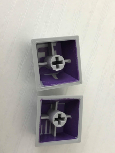

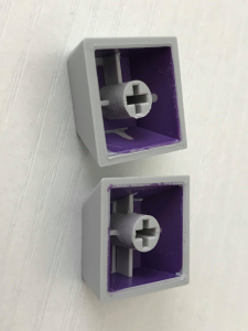

After a week of use some of keycaps stems split in half. For now, I think only two caps are split from the top number row. Had to use super glue on the stems to keep them from breaking off completely. I expected a bit higher quality build for these caps. The stem borders are quite thin.
Any one else had breakage issues with GMK caps? Is there a way to get replacements?
Do you have any pics? I've never had issues with GMK splitting like that.
Did you use a keypuller?
I'll post some pics. Yes I do use a keycap puller. All the other keys are in in good shape. From what I can tell, only the "1" and "5" caps split.
