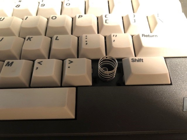

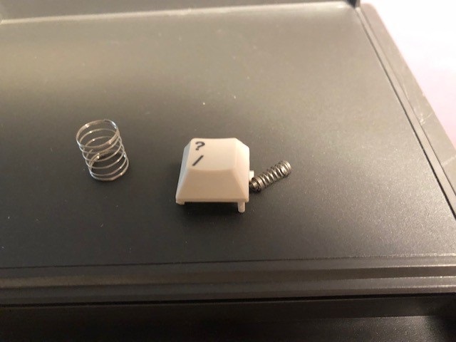

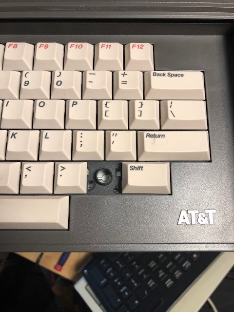

In regard to the keyboard within the terminal, it is pretty terrible and cannot be used as-is on a modern PC. The keycaps are thick PBT, and the case for the machine has a retro dark plastic frame with a built-in keyboard cover to make it easy to store the terminal when it isn’t in use.  The keys use a spring over membrane to register a key press. The spring sits in a round hole in the plastic face plate, with a barrel on the key itself that the spring also sits within. Then a wider spring, not as tightly wound, rests between the the keycap and the plate, giving the user a sharp key press that feels exactly like pushing down on an old metal spring. The springs even whine when depressed, which perfectly matches the whine of my heart after typing a few lines on it.

View of the face plate, barrel, and membrane.
View of a removed keycap, large spring, and smaller keystroke activation spring.
View with the large and small springs placed back into position.

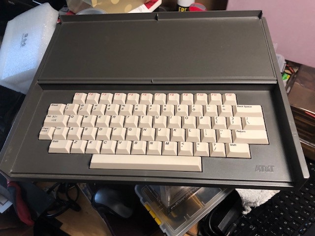

View of the full keyboard. Notice the dark plastic above the keys is on a hinge, allowing it to swing back down to cover the keys.
