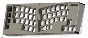

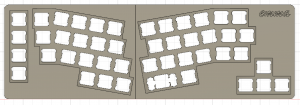

I knew I wanted an angled layout, and I loved layouts like the Alice, but, too many keys! When the primeE was IC'd I was hooked, but I couldn't swing the money, so I took that inspiration and created my own layout
226779-0
Once I was decided on the layout, I went to work in fusion and ended up with this:
226781-1

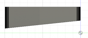

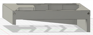

I had to split the board down The middle so that the printer could print it and at the advice of the guy who was printing it, I cut 2 holes in each side to stick some small metal rods in, in order to increase the rigidity of the case, with the plan to affix a piece of clear acrylic to the bottom.
226783-2
After recieving the print I realized that the holes were a bit too close to the outside edges and there wasn't much material between the hole and the actual edge. In hindsight, I should have made the bezel just a hair thicker, but so far so good.
The case is one piece, integrated 4mm plate, about 18mm high in front, (19.5ish after the acrylic bottom) with a 6 degree slope.
