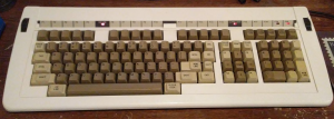

This is a kind of cool old board with 3rd gen Fujitsu leaf spring switches.

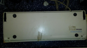

Opened:

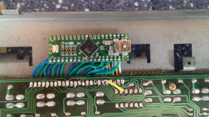

Desoldered the ribbon cable attaching the top PCB and traced out the matrix to wire the Teensy.
BTW this PCB seemed a little touchier than most, I did lift a pad and so used a bridge wire. Can also see part of pad on pin 3 got lifted too!
    228068-5               228070-6
Then wired the LEDs and speaker to the Teensy, reattached the the top PCB and closed it up. I did set up a key to toggle the speaker so I don't have to listen to it all the time.

Very nice smooth switches IMO. Here's a short video of typing on it (well banging on some keys anyway):

Noice! I like old boards like this. Chunky, fat lads.
Although, judging by the sound of the switches in the video, they sound kind of scratchy.
That's probably just me, though. Good work, mate!

Thanks! Actually they're not scratchy at all, maybe the sound is deceiving. Fujitsu leaf springs really are some of the smoothest switches around. I really like them!

Hi, just did the teensy mod and it works except some keys are not actuated. I believe they are bad switches and need further handle.  Will install the leds and speakers to the case and remove the original smaller pcb as this is of no use anymore.
