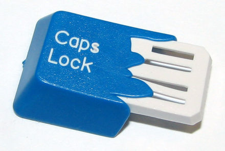

Originally, I was thinking of a different take on the ice-like aesthetic of white keycaps, imagining a set like frozen ice cubes. Essentially the idea is that by inverting the colours of a white shine-through keycap, the translucent body would emulate the shiny liquid layer that covers melting ice. Using a "seamless" double-shot method (if at all possible) that completely fills in the sidewalls and top face with opaque plastic, one could get some really cool visual effects.

  • All doubleshot keycaps I've seen use the most minimal amount of plastic for the legends - the manufacturing method would have to create a complete inner cap and allow a legend to be successful.
