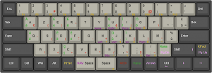

While I love the ergonomic keyboards, like semi-split and vertical staggered, they feel quite unusual and are often bigger. I need a keyboard that is reasonably compact (compared to a full size), with a layout our hands are like 90-95% used to, and which out of the box does not miss any key (maybe one) compared to standard ANSI US. Though it must be able to be adapted internationally, and thus implementing as few layers as possible while remaining easy to remember and get used to.
What I came up with is based on the clever HHKB :
So as you can see, we have three out of the box layers :
  • F_fk : F Keys layer that goes onto the number row, so it remains easy to remember
  • F_move : Cursor movement layer, with the Vi-like arrows on home row (H : Left, J : Down, K : Up, L : Right), and Home, PgDown, PgUp, End keys just above their arrows counter parts, following the same logic : Home above Left, PgDown above Down, PgUp above Up, End above Right
  • F_num : numpad Layer, this one is the less usual out of the three, as the dot is next to 6, 0 next to 1, / is in the same place as when the F_num layer is not active, * next to 9, - next to 7, + next to 4
Note that the four bottom right keys Mute, Vol-, Vol+ and Print Screen are random keys : i had hard time leaving no keys in these places, suggestions are welcome, few of them would probably be used for international additional Keys like [<, >] and [µ, *] for Azerty Fr firmware.

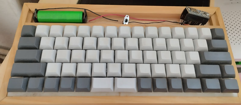

So for closure, here is the prototype (that ended up being a long term prototype)
304846-0
One can see the fashionable open air MCU mount, totally made this way for cooling purpose... obviously 😅

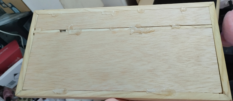

what would be this keyboard without its stylish bottom. One can admire the superb feet pads
Impressive, right ? 😄
here is the final layout (final result after applying my custom os keyboard layout)

I'd like to say, that I love how plugging the MCU to the computer opens it as a drive, where you just have to copy/edit files onto it for it to restart and run its entry point. Plus python is a real pleasure to use.
As for speed I'm not noticing any issue, but I'm not particularly demanding on that front... I almost don't game anymore, at least no FPS.
As for the keycap thoughts after using for quite some time :
if I had my 3d printer working I would have printed my own keycaps for the bottom row, with heavily rounded bottom edges. Indeed, as it stands, the edges are not comfortable at all on the thumbs. To this day this remain the most annoying thing about this keyboard.
I also tried to turn the right space key into a modifier (AltGr) when held down, for better ergonomics, but in the end that made the space register only when released and sometimes led to not be registered, which was super annoying, so... F*** it, roll back to a dedicated space only key.
