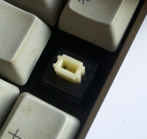

Just did as in the vid, are the two following picture enough to determine what it is?  Cream?
239542-0
239544-1
Offline Rob27shred
  • Posts: 1699
  • Insane in the Membrane! 👻
Re: Another Apple M3501 keyboard switch question
« Reply #13 on: Tue, 07 April 2020, 12:52:48 »
Yep cream damped, those little black rubber guys on the side are what silences the upstroke & down stroke. Still a nice board though, especially if the switches are in good shape! Damped creams get a bad wrap cause a good chunk of the older boards with them were beat into the ground causing the switches to feel terrible. IME clean & lightly used damped creams feel really good!
