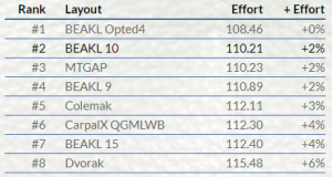

Then, I did many tests (really a lot) using the keyboard analyzer from keyboard-design.com.
Regarding the results (mainly efforts, distances and finger usages), they are somehow very close to each others, but BEAKL variants have a very low pinky usage which I tend to prefer.
I also tried many top layouts from the lists at keyboard-design.com, like seelpy..

Regarding the layouts I tested, here are the results from the keyboard analyzer (linked above).

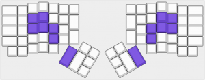

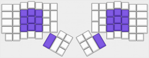

Something I wasn't aware and that I learned here (down below) is the notion of Easyblock keys cluster and Homeblock Keys cluster.
239741-2
239743-3
Some of these layouts (particularly BEAKL varaints) almost match with the Easyblock and Homeblock cluster but not for both hands for example.
So I tried to relocate (arbitrarily) in some of these layouts some keys to end up with a heatmap that matches as much as possible the Easyblock or Homeblock clusters.
But I think that doing it arbitrarily will completely ignore all the notions of rolling, alterning, same finger press etc., really all the actual things that can bring comfort (because I'm more concerned about comfort than WPM score).
