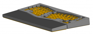

Took a stab at a basic wrist rest design on a new OnShape branch:
242142-0
I might shoot for solid Polycarbonate that's frosted (bead blasted) for a simple design. Do I fillet the bottom edges or not? Do I make the top surface flush with the case or leave at the bottom of the case front fillet?
I'm also trying to work through a couple of other ideas:
  • Wood version (ideally router-cut maple) with 2-4mm plated brass base with logo recessed similar to the case
  • Another wooden version with a top-layer of veg-tanned leather >2mm thickness to make it softer for resting your hands
  • Thinking through neodymium magnet placement inside the case and wrist rest without interfering with current design

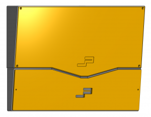

Another design that led me way too far down the rabbit hole:
242230-0
242232-1
The goal was to match the aesthetic of the main case. The top is a recessed 2.5mm thick high-quality veg-tanned black leather swatch that's laser-cut for a perfect fit. There might be enough room for a 0.5mm-1mm silicone or neoprene cushion underneath for added comfort. I'm really interested in this idea since it is a lot less prone to discoloration than PC, Acrylic, etc. and it's very easy to recondition or even replace.
The main body is a similar design to the main case for a perfect mating to the main case, same fillets and height with a flush fillet-free edge to mate to the top part of the case. The deck-height of the rest will be 1.5mm lower than the main case where its fillet ends - I think this is a better aesthetic than matching the deck-height and having a gap caused by matching fillets for the case and rest - like a small valley.
There is a slightly recessed-mount base plate with 2 threaded through-bolts to made a ~3mm flat brass plate to the base. I'm thinking of a laser-cut sheet instead of machined since easily 1/3 the price but will require slight modification like: countersinking, edge filing, hand polishing and a final coating.
If I go for this more complex rest, I'll then really want to match the main case with a full brass base plate. I already have a prototype laser-cut brass base plate for the main case that requires some finish work but I have yet to take it out of the seal for it to start tarnishing.
The price of this option is 25% more expensive in total than the PC version given the quotes I have so bar. I'm fairly certain I would appreciate this design more than a frosted PC rest no matter how many times I stare at the beamingrobot's Alice PC rest.
I still haven't fully explored a wood option but I'm confident I'll want to get it prototyped with a CNC router for precision, but I do not have easy access to one and I have yet to find a good vendor.

I finally got around to getting the polycarbonate wrist rest prototype made and it just arrived from the manufacturer in half their estimated lead time.
As of now it is milled perfectly to spec with no defects. All edges feature a 1.5mm fillet just the same as the original case as well as the original 5deg typing angle. The logo is symmetrical with the case's base plate logo positioning and same size, depth, fillet, etc. The surface of polycarbonate wrist rest is bead-blasted with a standard grit. I'm very pleased how it turned out and can now verify the design works well.
254347-0
254349-1
254351-2
STEP file for CNC milling: https://github.com/overset/JP01/blob/master/V1.1/wrist-rest_polycarb.step
Note: I have not updated the README on GitHub yet with instructions on how to navigate or manufacture any of my wrist rest designs nor any pictures which I intend to soon.
