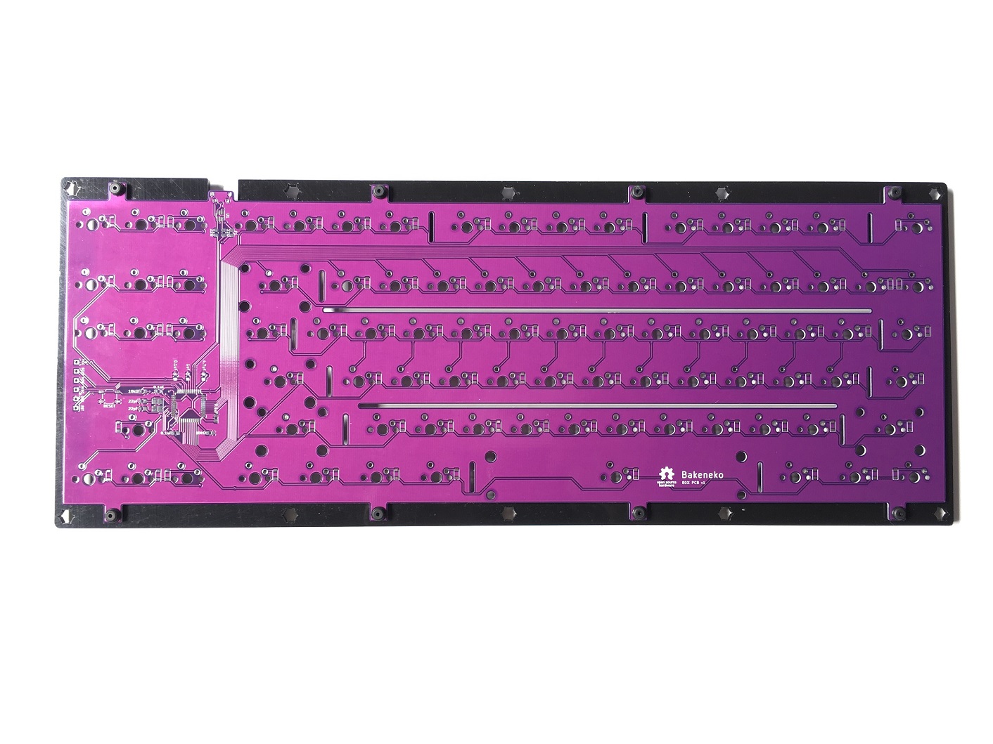

PCB Design
Added tab for top mount, and flex cut. Ready to build a more flexible plateless keyboard. I'm going to make this PCB with 1.2mm thickness. Other elements are the same as in a typical PCB, so there is no point to mention.
245062-0

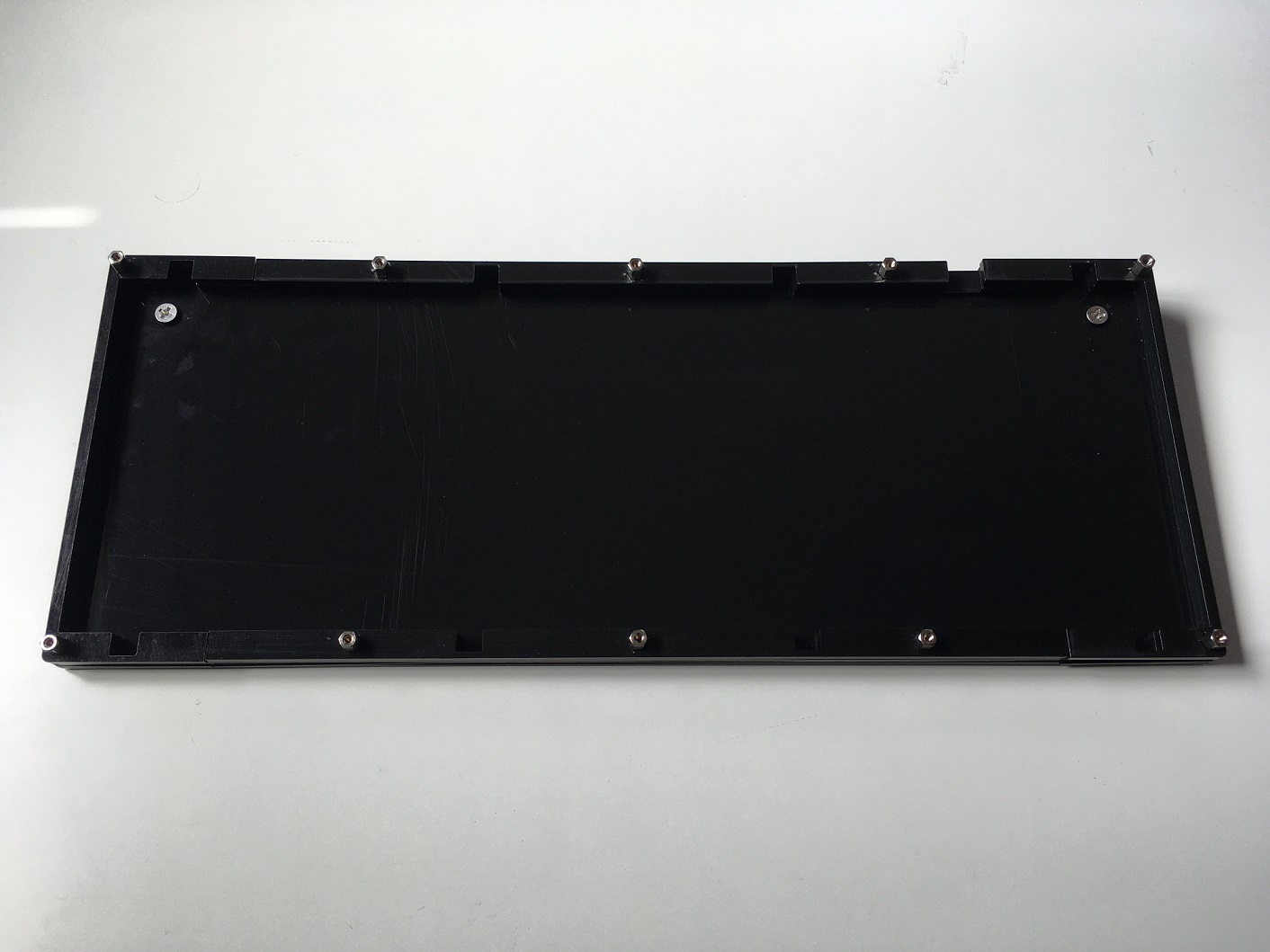

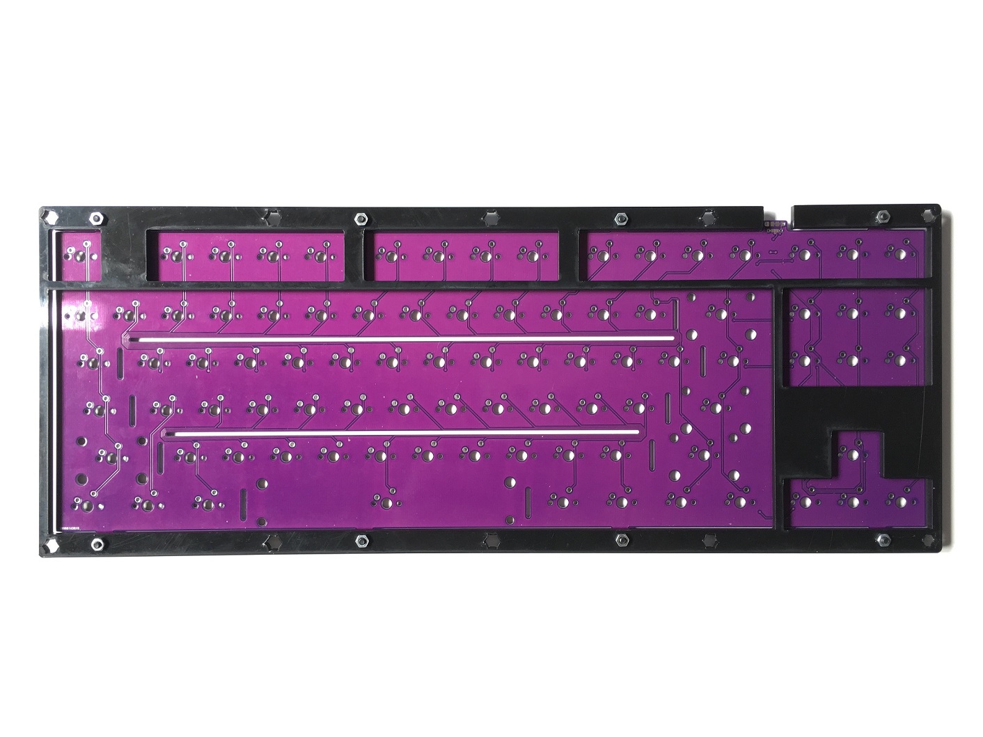

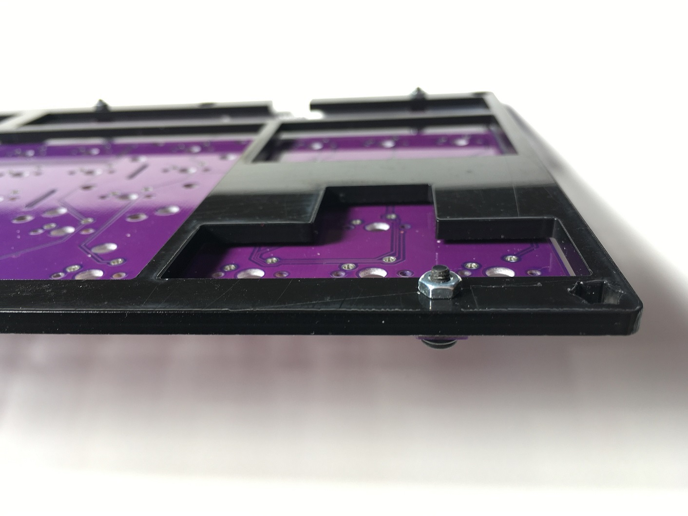

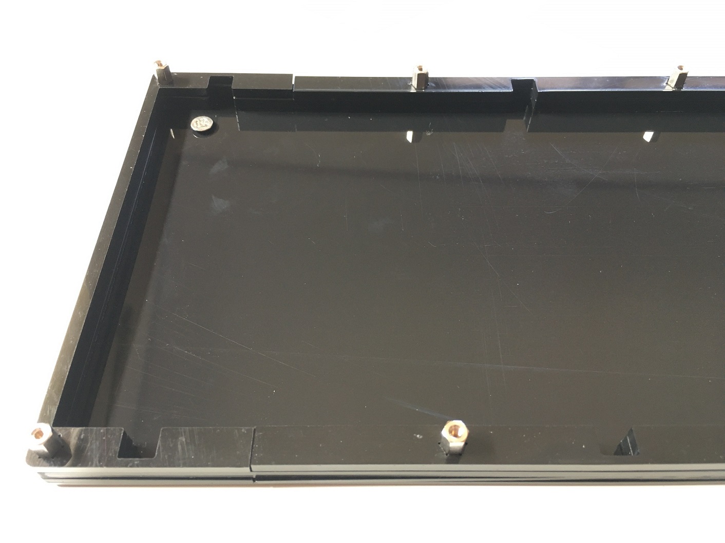

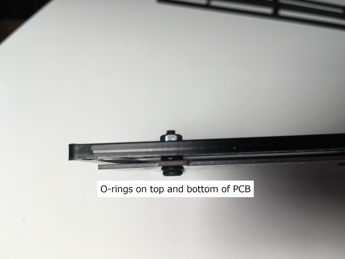

I built a second prototype. Here's a video showing the flexibility of the board and a short typing sound.
Mount structure
This is the part I was most concerned about, but it worked very well. This is a simple idea to achieve a top mount with a layered style keyboard. Use the nuts to secure the PCB or plate to the middle layer frame. An O-ring for the burger mount is optional, but with it, typing sound and touch feel is greatly improved.
The structure of this board is shown in order from the bottom layer.
245674-0
245676-1
245678-2
245680-3
245682-4
245684-5
245686-6

PCB flexcuts are as flexible as I imagined. The Alpha-numeric section moves up and down about 0.5mm to 1mm with normal typing. If press it strongly while it is stationary, it will drop about 3 mm. There is clearly less fatigue after long typing session compared to a hard setup like a brass plate.

The position of the mounting tabs can be improved. The switch near the tab feels a bit stiff at the bottom. I think it is better to move the tab to a place with a margin so that it does not overlap the switch position. After fixing this issue, I might release the first version on github.
