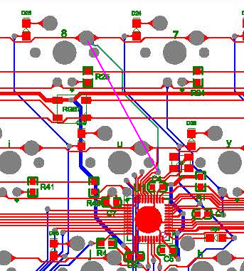

I am soldering the switches onto the board. After I completed the top row (numbers), I tested them out. 8 key switch felt a little over-lubed, so thought to swap it out. After I desoldered it, can't seem to get any of the top row keys working. The second row works dandy though. I've read posts about trace being damaged but it looks fine to me.
I think placing a bridge might help me but have no clue between which keys this bridge has to be placed.  I am trying to test the ports out for all the switches in the top row. When I touch the USB-C port with the left switch leg with a conductor (wire), the keyboard tester detects the entire column being pressed. I am unable too find the points to connect(bridge) so that the top would work.
Any help/guidance/suggestion, any at all ?
Images: https://imgur.com/gallery/mXT60x7

I think this is the 8 switch, it certainly looks like it's been soldered more than the others.  It's above the controller chip so it's possible that the switch pin is used as a via which would explain the whole row dying.
As you can see I've added dots to your pic, if jumpers are needed this would be where they go.  Solder the yellow ones then test, if everything works great.  Everything except 8?  Skip to the next paragraph.  If not touch the pink dots and (if I've got the right key as 8 ) it should type a 7, if that works solder any of the yellow dots to the pink one near the chip.  If it types something but not a 7 I've gone cross eyed - let me know what you get and I'll try again.
If the rest of the row works but 8 still doesn't solder the blue dots to reconnect it's diode.

So I connected the yellow dots, and the keys in the top row didn't respond. When I connect the pink dots, it triggers the entire column, ie. "7YHN".
If I touch yellow dot to bottom pink dot (C4), the entire column is triggered corresponding to the key in the top row which is pressed. Meaning if I connect yellow and bottom pink and press key 4, "4EDC" is pressed.

When I touch the bottom pink (C4) to any diode in any row, the column corresponding to that switch activate.
For eg, D56 (switch "K"), like D26 (switch "9") activates the column "9IK,". Similarly connect C4 to D38 activates column "6TGB"

The last thing i see you could try is to add a jumper to the via that goes to the mcu (replacing the track i colored in green with a jumper colored in pink) if that does not work maybe try changing the diode but i do not see how that would produce your problem here (an overheated diode most likely fails shorted), other than that i don't see anything you have not tried already...

Hey it works!
What @yui suggest is the same as @suicidal_orange's suggestion with the pink dots. @yui diagram made me aware of my mistake, I was connecting the switch to the diode just below it which lead to triggering of the entire column.
Now just have to figure out how to solder onto that teeny-tiny hole :p
