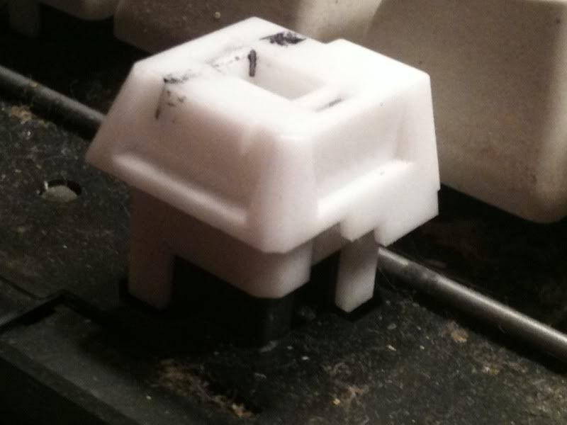

« Reply #6 on: Sat, 17 July 2010, 19:07:15 »
Quote from: ch_123;203687
Can you pull the thing up and out?
nope ... looks like this:

« Reply #7 on: Sat, 17 July 2010, 19:09:44 »
That's what I was expecting... Can you pull it up? It's probably either rubber dome or a Peerless.
Offline instantkamera
  • Posts: 617
Tandy Enhanced Keyboard
« Reply #8 on: Sat, 17 July 2010, 19:16:17 »

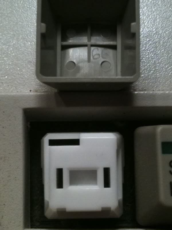

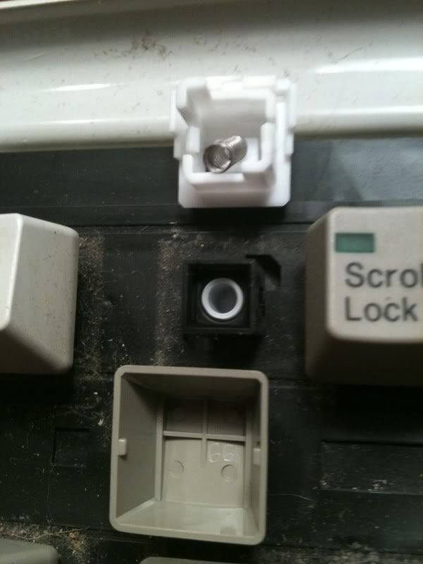

yeah hold on I stand corrected ... I went ape **** on the white section and it pulls up eventually (and nothing appears broken). These are the guts:

« Reply #9 on: Sat, 17 July 2010, 19:29:59 »
Peerless!
Not exactly people's favorite keyboard around here, but at least something of a step up from a standard rubber dome keyboard.
To qualify my earlier guess - there are some keyboards that used the exact same type of slider, except it's a rubber dome underneath.

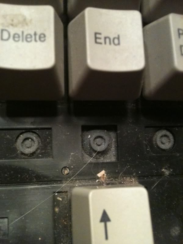

ahhhh ... interesting. In fact, you are correct, I noticed after tearing this open that it does have some reserved spaces that have exposed the unused portions of the membrane:
In all honesty it kinda feels like ****, but I may take a stab at cleaning it up to see if it improves.

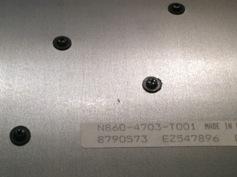

- this thing IS reasonably well constructed. At least, when I cracked it open I noticed the internals are not held together by plastic rivets:
So has already had the rivet mod done ;)
