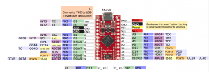

2. pins used on microcontroller, i remember someone else having issues when one of their rows/comums was connected to one of the "INT" pins, can't remember if it was D2 or D3
250543-0
3. make sure your wiring is correct in kbfirmware.com, and everything is configured correctly in the pins tab
