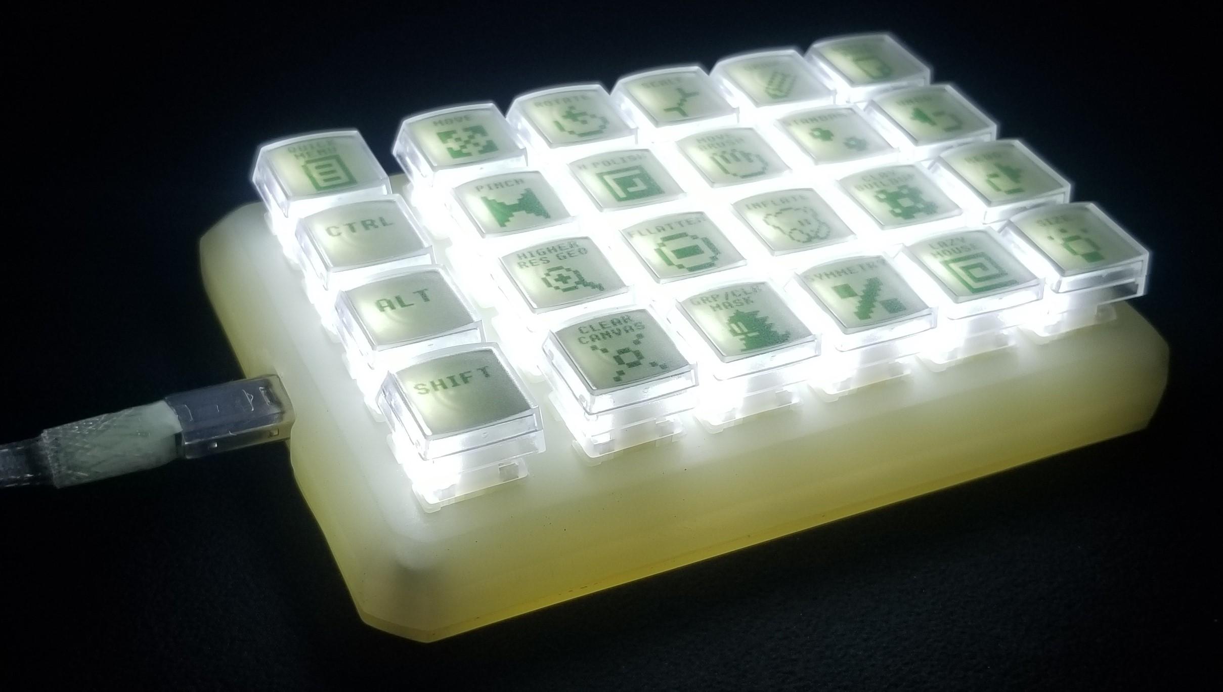

Custom GID Resin Cast Case for a 24 Key YMDK Macro Pad
« on: Mon, 14 September 2020, 02:49:22 »
251674-0
Link to Imgur Gallery with full pictures and a bit of writing on the project:
https://imgur.com/gallery/JfEGcIC
This custom GID 24 key macro pad includes:
YMDK 24 key macro PCB kit with 50/50 white led underglow
Hot swap plugs for switches and white shine through leds
Fully custom resin cast GID case
Bottom swapped and lubed NK Gateron Glows
Glow legends inside relegendable keycaps, with o-rings
Custom USB C double sleeved GID paracord and clear PET cable
Took a couple months on and off/ waiting for some parts, but I’m super stoked to finalize the perfect legend layout and hopefully start speeding up my ZBrush workflow a bit with this custom pad!

As far as bubbles go, they can be solved with a pressure caster, so long as you mold was vacuum degassed when you poured it. But I have been at this type of stuff for quite a few years now, and have a lot of toys to play around with thankfully   ;D. Although I was having some trouble with the surface finish I wanted. Originally I was going for a gloss finish out of the mold, but just didn't get it there, and ended up doing a lightly sanded matte finish which I like more in the end honestly.

Seriously though that's a good looking pad and GID [anything] just makes it better.  Matte finish will stick to the desk better and will be less prone to scratching so that's a bonus :thumb:

¯_(ツ)_/¯ When I found the glow switches, It just made sense to make it all glowed up  :thumb: Yeah, the matte finish doesn't show scratches as much thankfully too  :) also just kinda frosts the whole thing in such a way that looks more GID-E, than a gloss glowing surface.
